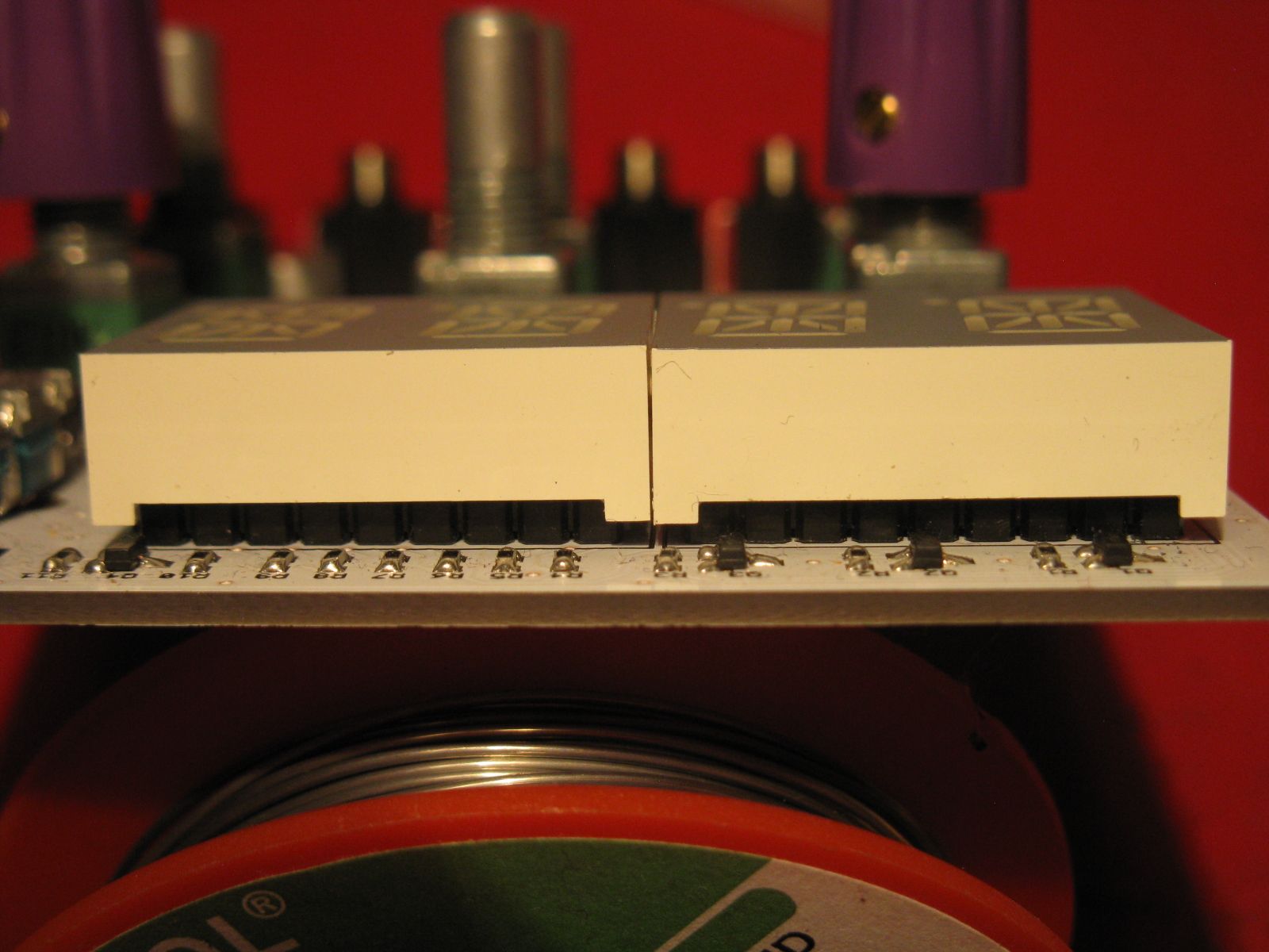

maybe a useful tip:
To raise the displays so they are closer to the panel I used
some pin headers, from which I removed the pins, as spacers.

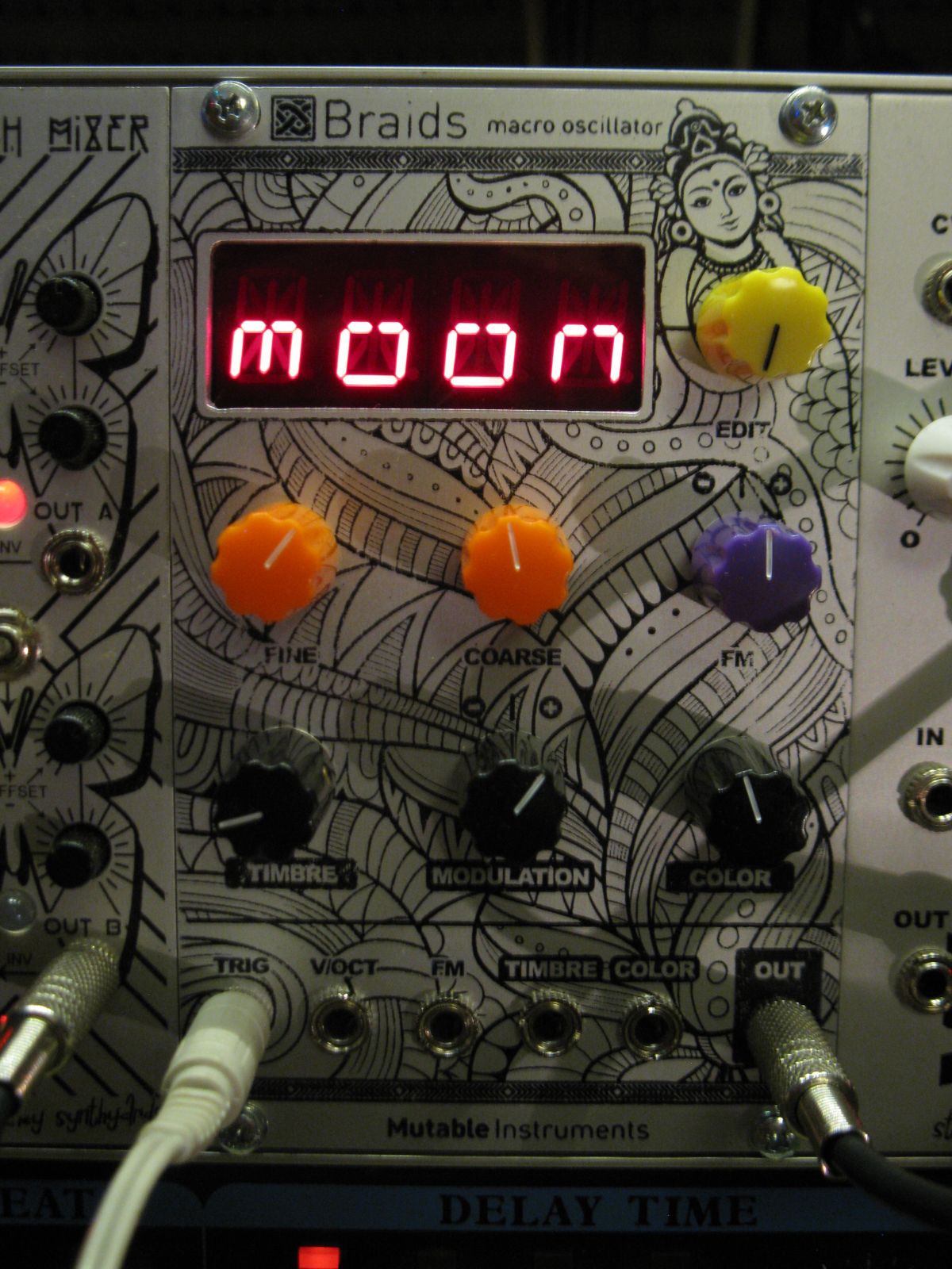

PostPosted: Sun Oct 01, 2017 11:42 am    Post subject: Reply with quote  Mark this post and the followings unread
Here's a photo of the finished module with temporary colored knobs.
I've posted 2 recordings for which I used it:
Brain drops, keep falling out my head
PseudoRapidity

PostPosted: Mon Oct 02, 2017 3:42 pm    Post subject: Reply with quote  Mark this post and the followings unread
That looks fantastic! Amazing work throughout Pho!
Posts: 5947
PostPosted: Mon Oct 02, 2017 5:01 pm    Post subject: Reply with quote  Mark this post and the followings unread
Thanks Very Happy
I am pretty happy how it came out myself, and it's an awesome module.
(I'd actually like to built a couple more of them Rolling Eyes )
