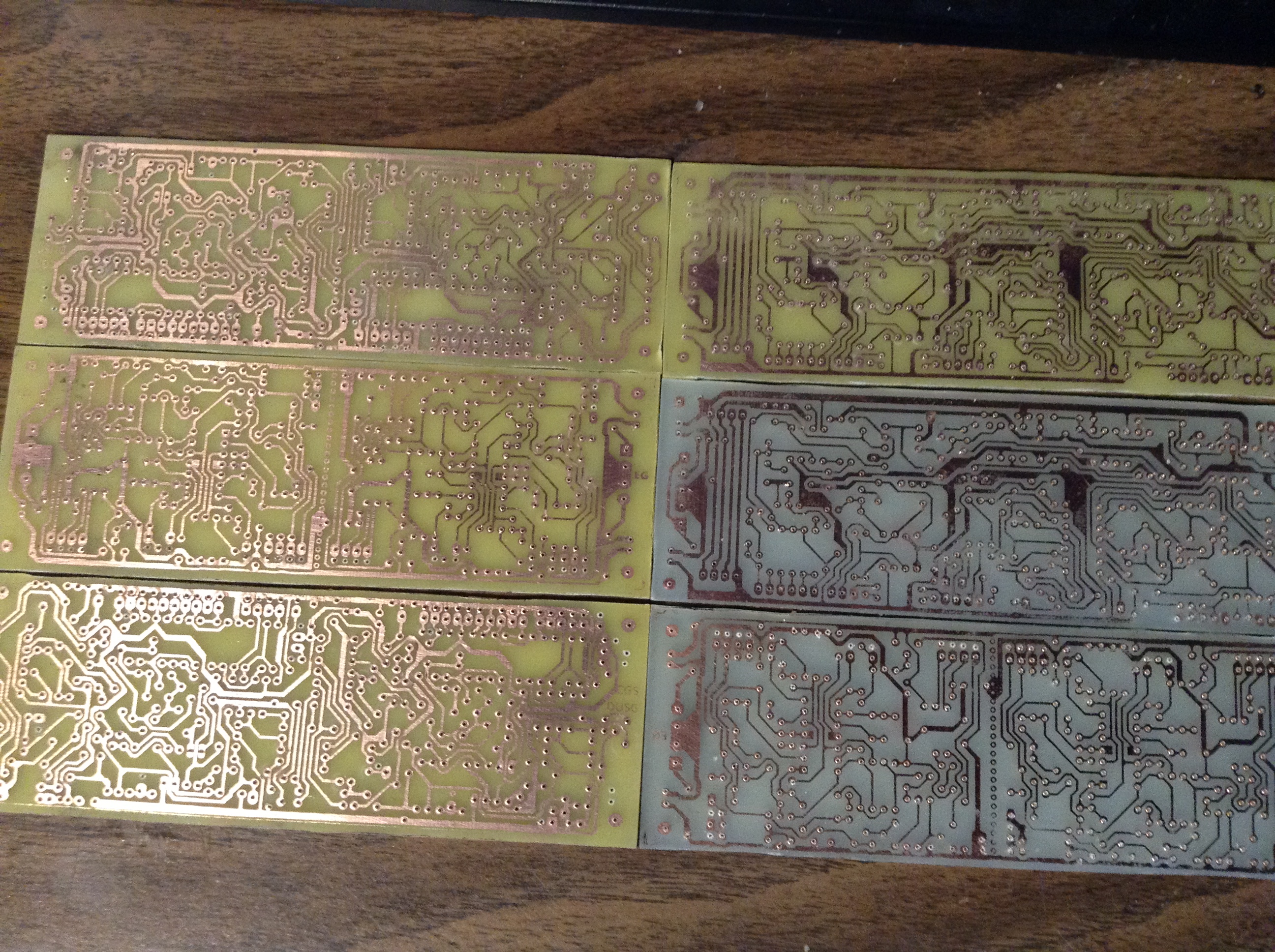

PostPosted: Sun Nov 12, 2017 1:32 pm    Post subject: Reply with quote  Mark this post and the followings unread
^ You're welcome. Let me know if there's any issues with the pcb that need to be fixed.
I just finished etching and drilling 6 pcbs, 2x VCO, 2x DUSG, and 2x Dual EG. There are a few etching faults that still need to be fixed, but all in all they turned out pretty good. I'll start stuffing them today, but I don't have all the parts necessary to finish them yet.
 Filesize:  2.16 MB
 Viewed:  804 Time(s)

you absolutely need a Minimum of 6 DUSG or VCS. Smile
Just want to chime in and tell, that i yesterday fisrt time experienced with 2 VCs as slew limiters for my sequencer for controlled glide events.
Just stick the CV of the sequencer into the Signal Input of 1 VCS adjust fall and rise to taste, and connect a trig out from the seq to the trig in of the 2and and adjust rsie and fall there too and connect it's output to the controls for rise, fall or both... can give some nice variations on the sequenced Output. Well you can also produce steady glide with 1 VCS and just the rise and fall ratio.
Well this module is endless fun and literally a dozen of application to use for.

PostPosted: Mon Nov 13, 2017 4:46 pm    Post subject: Reply with quote  Mark this post and the followings unread
^ That's a neat idea, so I suppose if you have two rows of gates on/off switches on the sequencer, you'd be able to choose which steps glide, similar to a TB-303, while the other triggers a basic EG. That's pretty awesome.
The DUSG is the one module I'm looking forward to completing the most, as I've heard so much DUSG praise. I'm also curious as to how well it tracks as VCO.

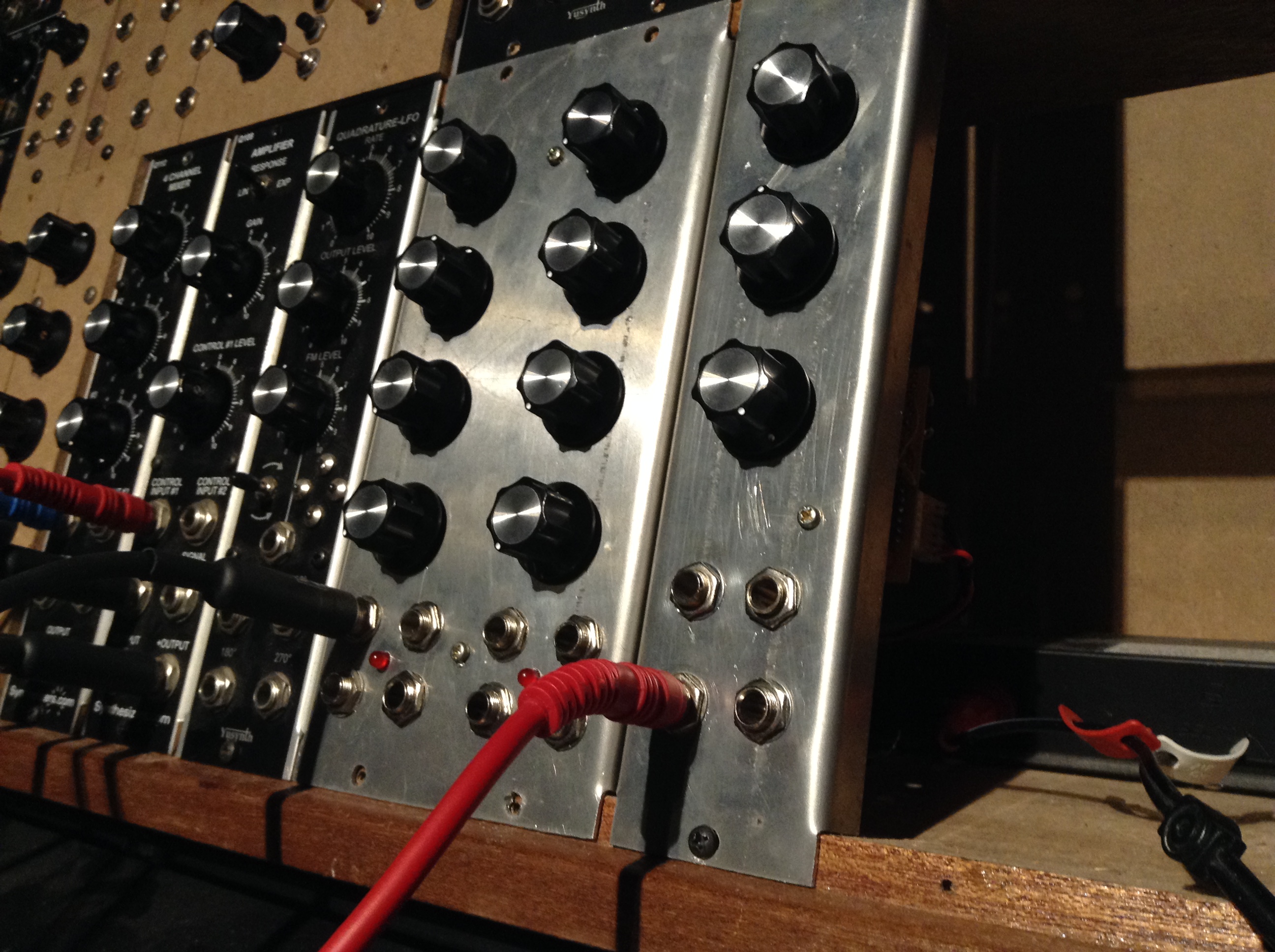

I made two Dual Utility Eg pcbs a while ago, but ended up only including one in the briefcase synth, so today I put one of the pcbs behind a MU panel in my MU modular. I also perf-boarded a Utility LFO. Both worked great right away without any fiddidling. I used 1M pots instead of 2M2 on the EGs, so I'm going to put some larger value timing capacitors in them to get more range, maybe add a switch. great Eg. The Utility LFO is pretty awesome too, just lacking a cv in.
I've been talking to the guy I mentioned (Julian) about the brushed aluminum, blue infill panel, and it looks like it's going to go through, so I'll have one great looking panel Razz
Here's a photo of the two CGS modules in my MU Modular. Not very pretty... Eventually I'll bother to learn how to silk-screen and make some pretty panels.
