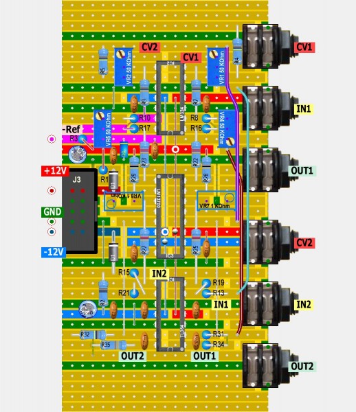

BlacKcaT wrote:
....I will swap the TL084 with a TL074 without any change. Is this ok?
puts sockets and tests, usually works

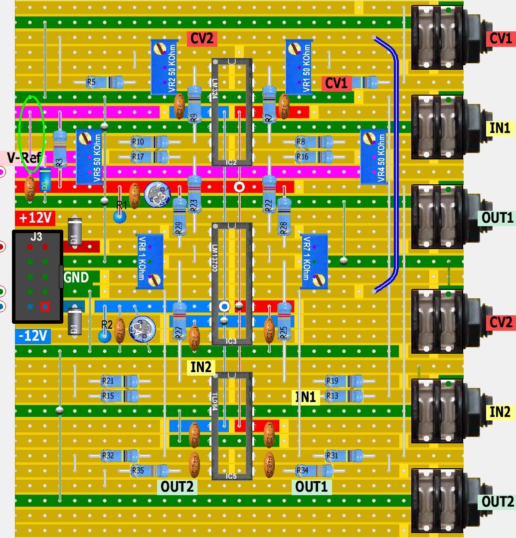

Here the v.3: with the original power input schema. Personally I prefer ferrite bead instead of R1, R2
I corrected the missing link v.2: R3 to V-ref
 Filesize:  239.41 KB
 Viewed:  735 Time(s)
http://nardusynth.blogspot.ro/

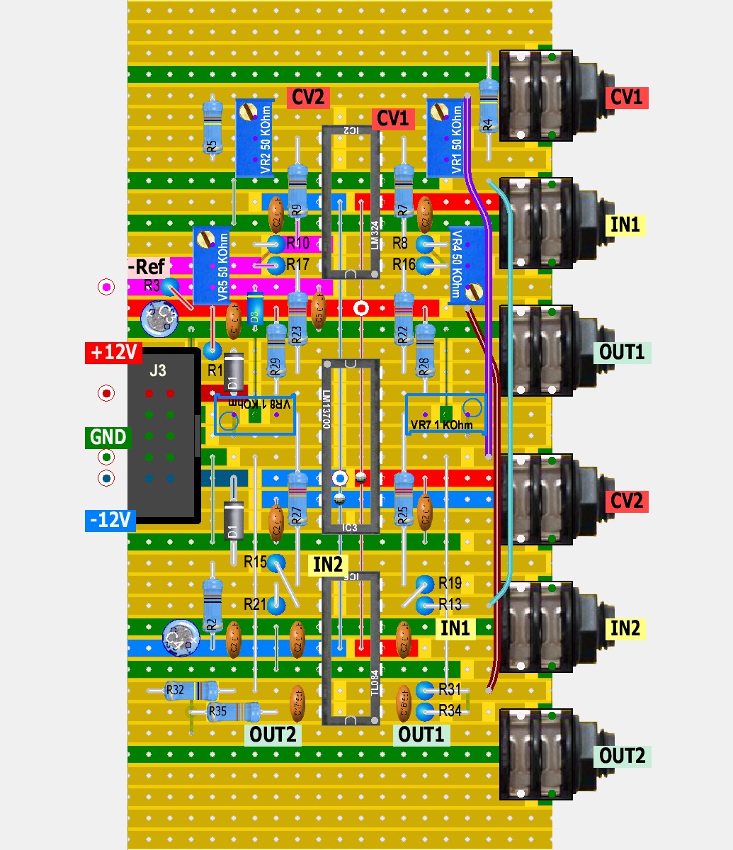

PostPosted: Thu Jan 25, 2018 1:17 am    Post subject: RYO 2X VCA_v.3 stripboard Lochmaster Reply with quote  Mark this post and the followings unread
Sorry, I found 2 errors: LM324, TL084 must be rotated 180 degrees (in all variants), a wrong connection to VR7 and VR8.
Here,
- RYO 2x VCA top v.3 revised. The attachment RYO 2X VCA_v.3 stripboard.zip, contains the LM4 file.
- RYO 2x VCA v.3 helper, like silkscreen. Print from ryo 2x vca_v.3 silkscreen helper.pdf file 1:1, crop to edges and stick the corners on top side.
Note!, are some connections on bottom side (in all variants).
Use Viewer for LochMaster for printing

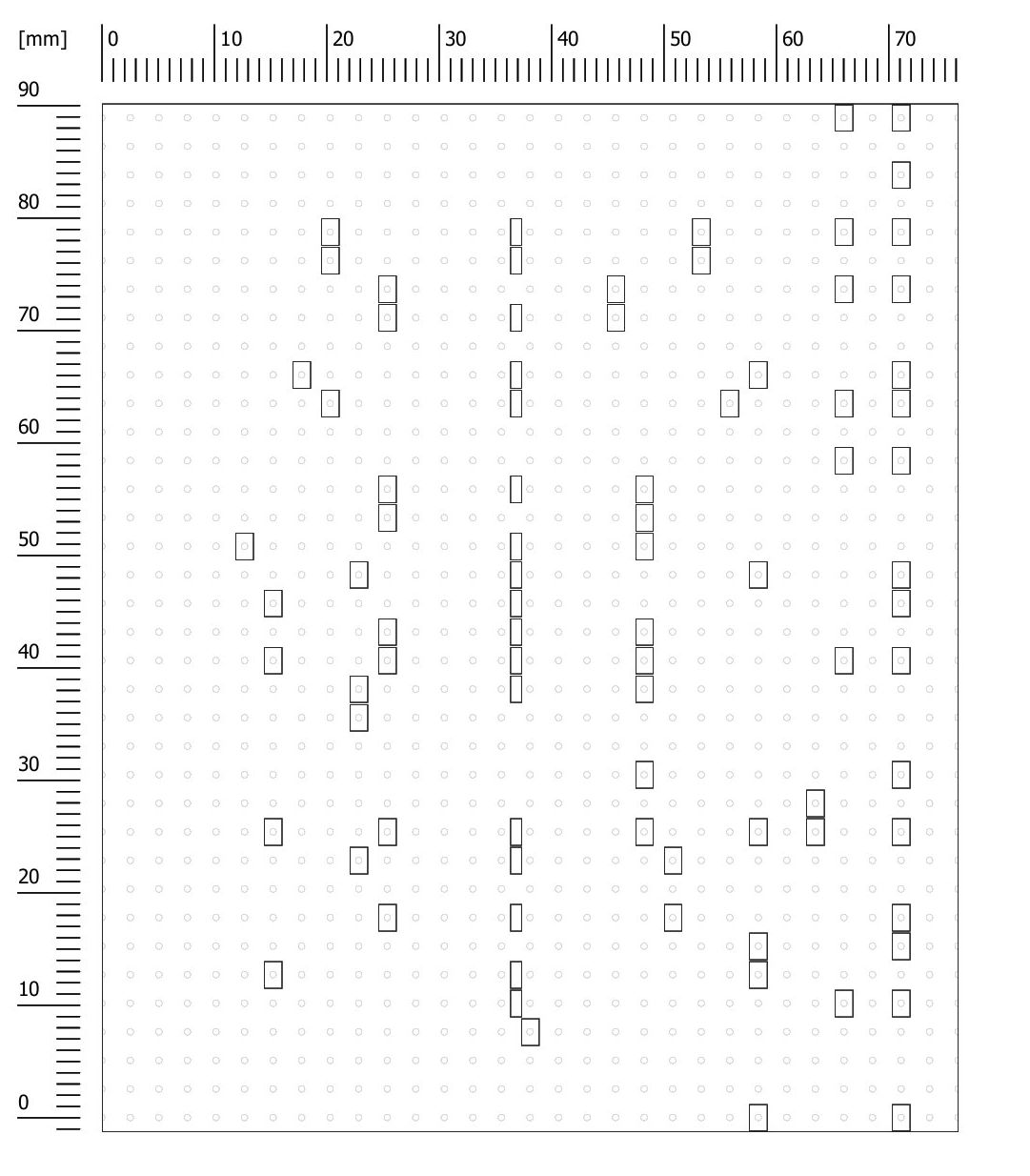

So you do not miss any spilt points, use this helper. Print from ryo 2x vca_v.3 split points helper.pdf file to 1:1 scale, crop to edges and stick the corners on bottom side.
Note! For any prints for the bottom side you must press the mirror button (vertical)
Use in Lochmaster the Print function (ryo 2x vca_v.3 printing tips.png)

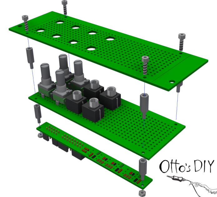

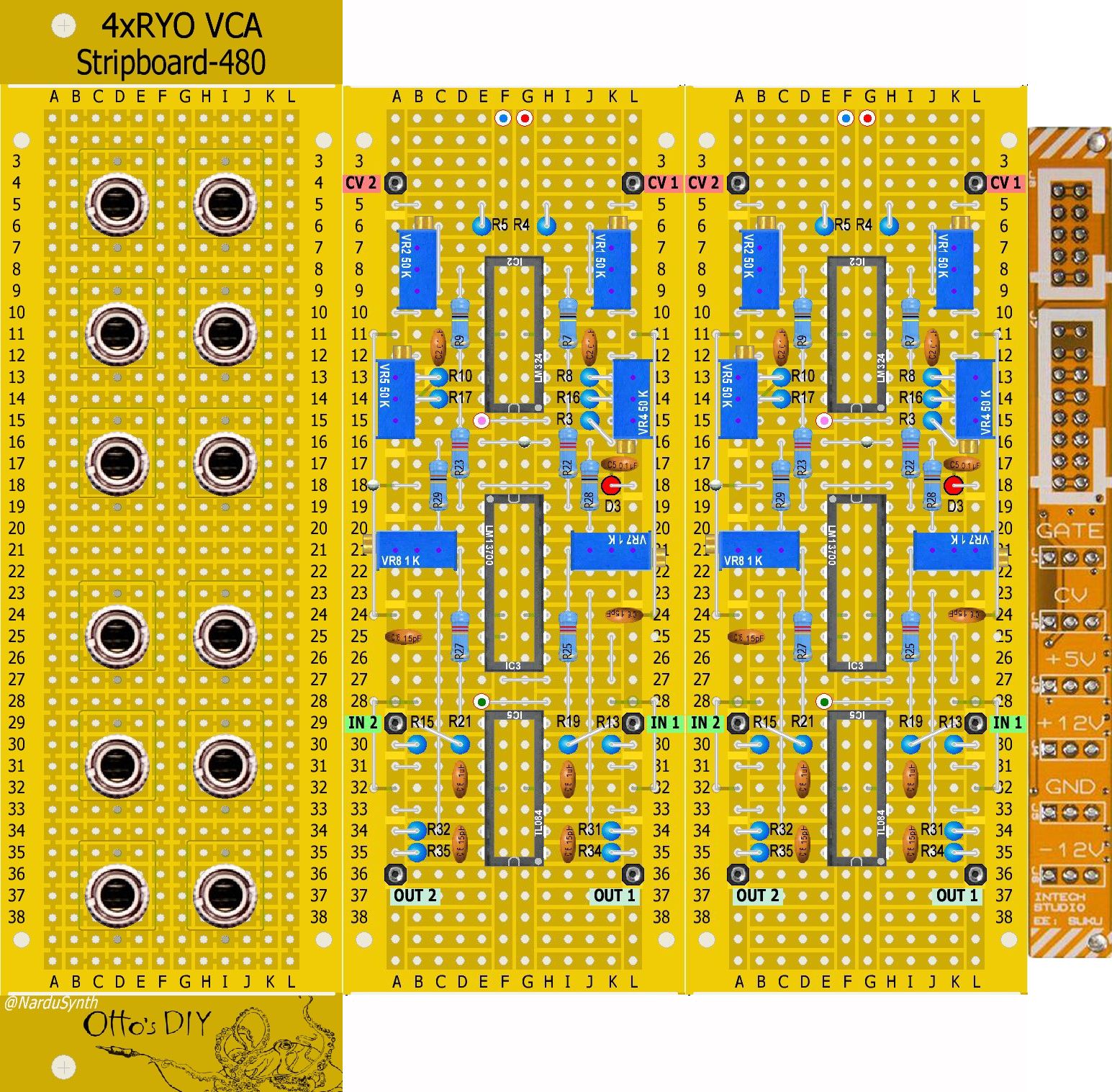

Another approach to this project for - an interesting idea on 8HP EuroRack Otto's DIY EuroRack Modules - Facebook Otto's DIY Eurorack User Group
Possible 4xRYO VCA

PostPosted: Tue Feb 20, 2018 11:25 pm    Post subject: RYO 2x VCA Otto's Stripboard-480 version Reply with quote  Mark this post and the followings unread
With potential, Otto's Eurorack modules - Stripboard-480 version
