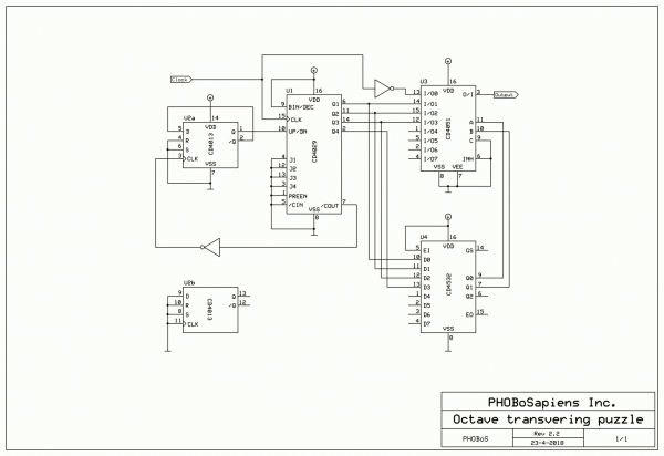

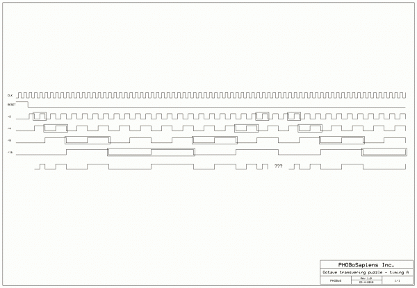

Joined: Jan 14, 2010 Posts: 5947 Location: Moon Base
Posted: Mon Apr 23, 2018 12:09 pm Post subject:
When I initially tried to solve it I first drew up a timing diagram to see which divisions need to be selected and when.
As you can see there is a bit of a problem which is probably releated to why your version doesn't fully work.
This is also the reason why I opted for a 4029 to do the up/down counting.
I did make a mistake in the circuit diagram: there needs to be an inverter between the carry out of the 4029 and the CLK in of the 4013.
if you do that it counts:
0000
up
0001
0010
0011
0100
0101
0110
0111
1000
1001
1010
1011
1100
1101
1110
1111
down
1110
1101
1100
1011
1010
1001
1000
0111
0110
0101
0100
0011
0010
0001
0000
Posted: Tue Apr 24, 2018 2:01 pm Post subject:
That timing diagram is also how I came up with using a priority encoder.
While I was looked at it I noticed something:
/2 needs to be selected when /4 is high
/4 needs to be selected when /8 is high
/8 needs to be selected when /16 is high
etc.
I assumed CLK (inverted) can be selected when /2 is high but I didn't really check that, hence why I am not sure if the circuit
fully works or not, I also didn't check yet if it still works correct when counting down.
anyway,
/2 is connected to input 1 of the mux so is selected with CBA = 001
/4 is connected to input 2 of the mux so is selected with CBA = 010
/8 is connected to input 3 of the mux so is selected with CBA = 011
looking at the counter that means that when its output is 001x (Q4 = 0, Q3 = 0, Q2 = 1, Q1 = don't care)
the CBA control inputs of the mux need to be 001.
when its output is 01xx CBA inputs need to be 010
when its output is 1xxx CBA inputs need to be 011
and that's exactly what the priority encoder does.
I think it is also possible to chain 2 4029 counters which would give another 4 bits that can be connected to the priority encoder.
Q2 of the encoder can then be connected to input C of the mux. _________________ "My perf, it's full of holes!"
