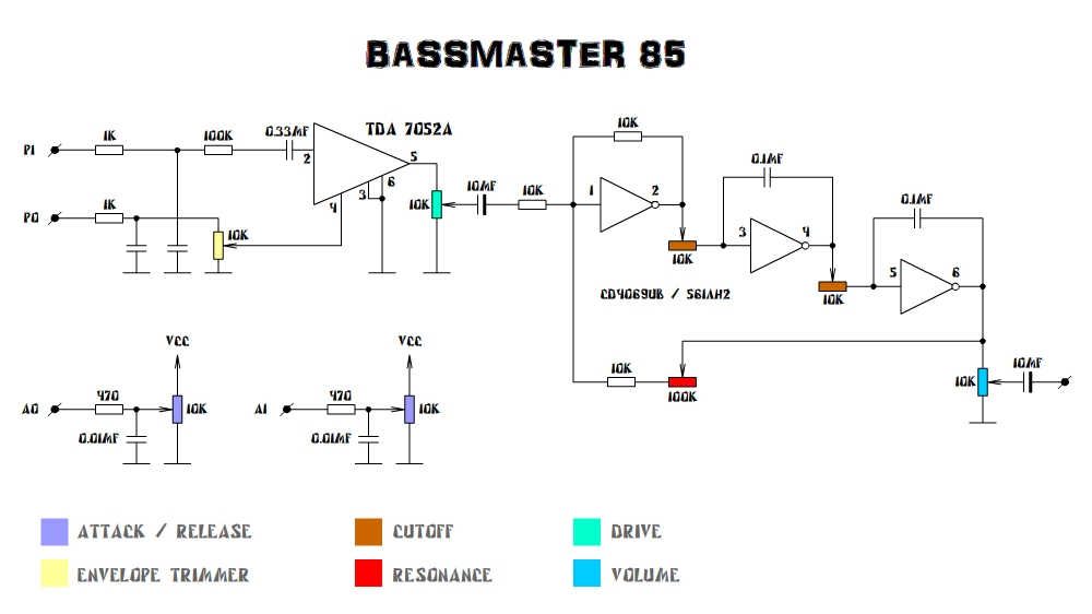

Hello!
My project based on Digispark - ATTiny 85 16MHz arduino programmable.
The main idea is that it's possible to use two PWM outputs for DDS. One of them will be the main wave generator, other will be the envelope shaper.
But I could't find any simple, but good VCA, utill i saw elektrouwe 7052A circuit in this topic: http://electro-music.com/forum/post-405863.html#405863
In MIDI interface you can use channels to tell ATTiny 85 what kind of waves to generate i.e. 1st channel - sine, 4th channel - square, 5th channel - white noise and so on.
Here is short sample (triangle & pulse - lead, square - bass): https://www.youtube.com/watch?v=YfB4YF5tCFE
It was recorded with soviet 561LN2 chip, 4069 sounds not so bright.
BassMaster 85 have just 8kHz bitrate, but LPF and analog VCA helps to eliminate dizzy digital noise.
Here is the circuit diagram. I still not sure, thal levels between ATTiny 85 and TDA 7052 are OK, because triangle is not always triangle, and square wave is not always sharp.
I want to make envelope follower on 1/2 of 4069, and mix this envelope signal to the LPFcontrol via vactrol. Is it a good idea?

PostPosted: Sat Mar 24, 2018 12:35 pm    Post subject: Reply with quote  Mark this post and the followings unread

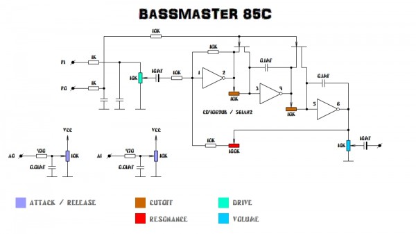

BassMaster 85C (chimera) because it is 3/4 digital, 1/4 analog.
Cutoff is driving by ATTiny85, resonance is still manual. JFETs for LPF are soviet again 2П303A, because I haven't others around.
I will post full code a bit later, it's still very dirty.
Check the sound!

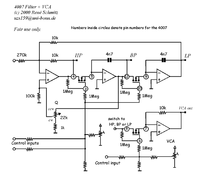

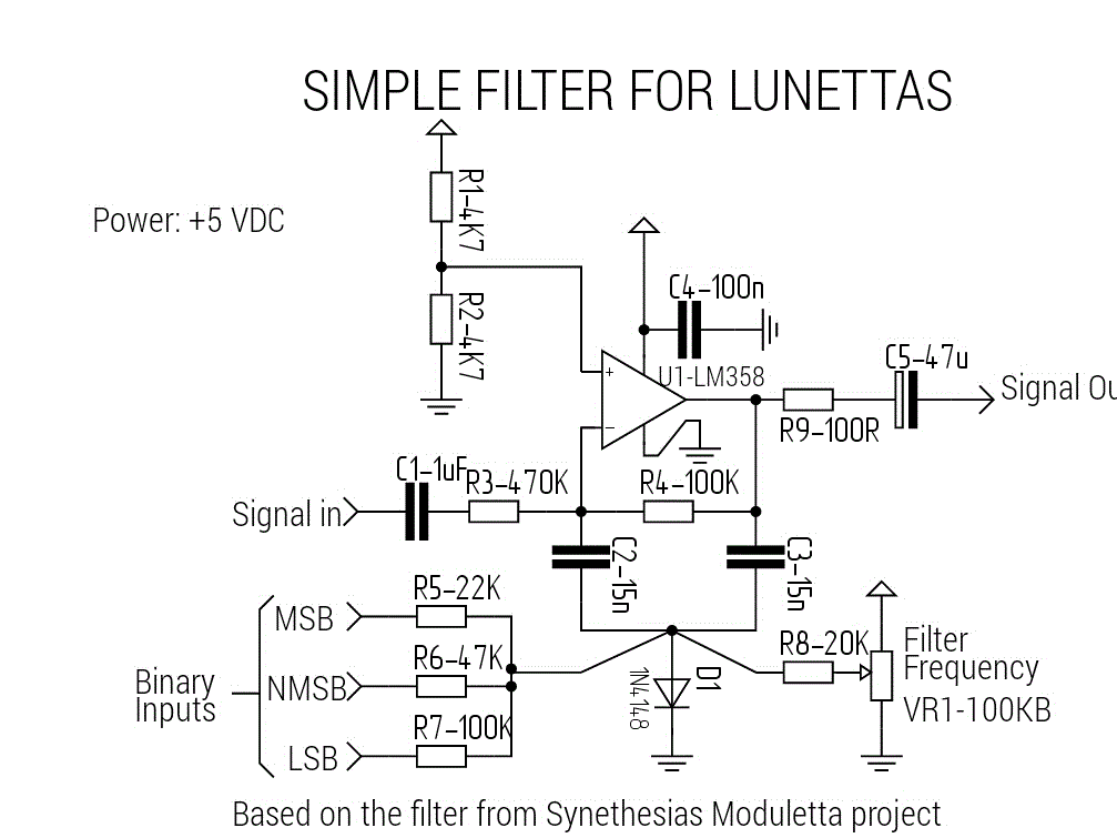

Trying to make sound "brighter". I've made another one SVF, but with additional feedback from BP output.
Then I've made "Most simple VCF on earth" to simplify circuit. Now i'ts possible to make my synth in size of credit card.
All three filters sounds and circuit:

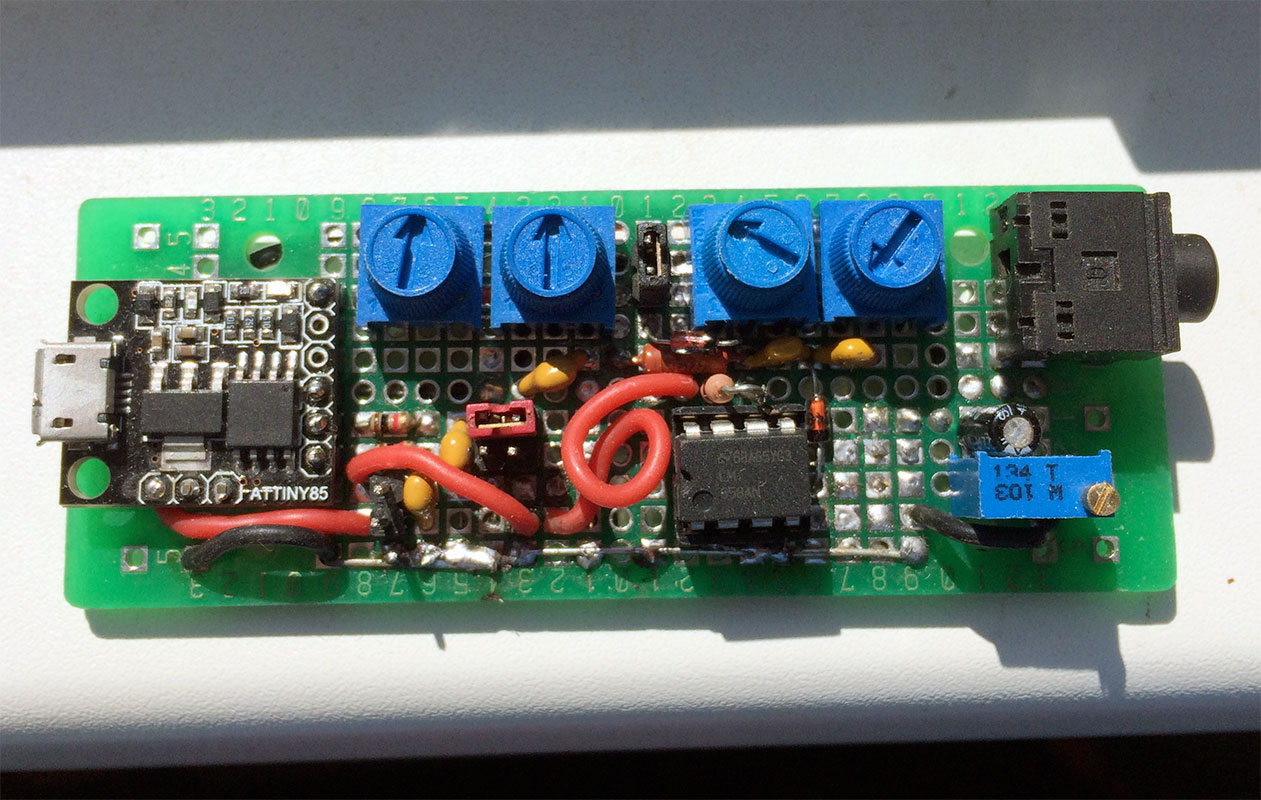

PostPosted: Mon May 07, 2018 1:26 am    Post subject: Reply with quote  Mark this post and the followings unread
Prototype soldered:

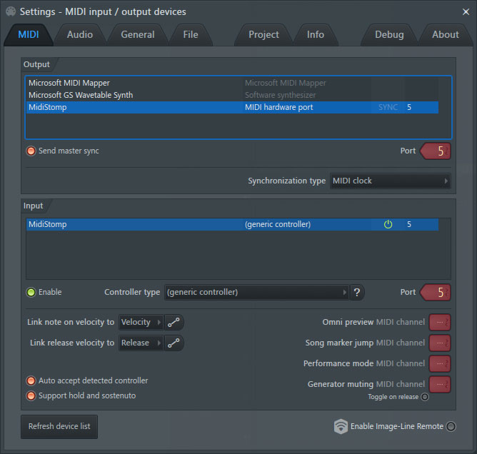

In ZIP you will find corrected library for USB MIDI, original I've got here, thanks to heartscrytech for great work: https://github.com/heartscrytech/DigisparkMIDI
When you upload sketch into Digispark, your PC will find new device. In FL Studio set a port for MidiStomp, I use port #5. Open attached example for FL Studio.
Channel #1 - sine
Channel #2 - triangle
Channel #3 - saw
Channel #4 - square
Channel #5... - effects
Decay is not working now. Dig the code, you will find envelope tables for lead and for filter.
Combining white noise and other waveshapes, it's possible to make new instruments! Let me know, if you will make something new!

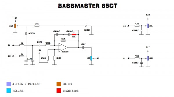

Hi
i have built the Bassmaster 85CT from your last Post
after upload the code into the Attiny85 i check the functions and
I can switch between the Waveforms Nice Cool and
I can play various Notes but the
Attack and Release pots don't work
if I turn the pot which one goes to pin 1 of the Attiny85 (A0)
over the half the Attiny lost her connection to USB if I turn
the pot back the bassmaster go on!
thanks for this work
Hammer
Joined: Mar 13, 2018
Posts: 72
Location: Russia, Zhukovsky
PostPosted: Mon May 14, 2018 2:06 am    Post subject: Reply with quote  Mark this post and the followings unread
Hello, StormB!
It's mean, that your AtTiny 85 is working properly!
A0 - reset pin. You are resetting your chip by the pot. There are two versions of Digispark, with unlocked reset pit (you may flash it with USBasp), and with locked by fuses. Locked version could be flashed only by high voltage programmer, but it lets you to use reset pin as input / output.
In your version, you can use only one pot.
In code change:
#define ENVELOPE_ATTACK A0 // Pot
#define ENVELOPE_DECAY A1 // Pot
To:
#define ENVELOPE_ATTACK A1 // Pot
#define ENVELOPE_DECAY A0 // Pot
And it will be possible to attenuate attack. I'm using single pot too.
Also, you can make a switch between Digispark and VCF - very useful!
StormB
Joined: Aug 15, 2013
Posts: 18
PostPosted: Mon May 14, 2018 2:59 am    Post subject: Reply with quote  Mark this post and the followings unread
Hi
i have change the inputs now the Attack pot is working Very Happy
i upload the Sketch with my Arduino (Arduino as ISP)
it is possible to make the release shorter
Hammer
Posts: 72
PostPosted: Mon May 14, 2018 3:19 am    Post subject: Reply with quote  Mark this post and the followings unread
Yes, find in code:
ADC_LFO = 32;
Increase this number. Than higher number, than shorter decay.

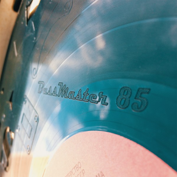

I think that laser cutted vinyl is good for case and deck building!

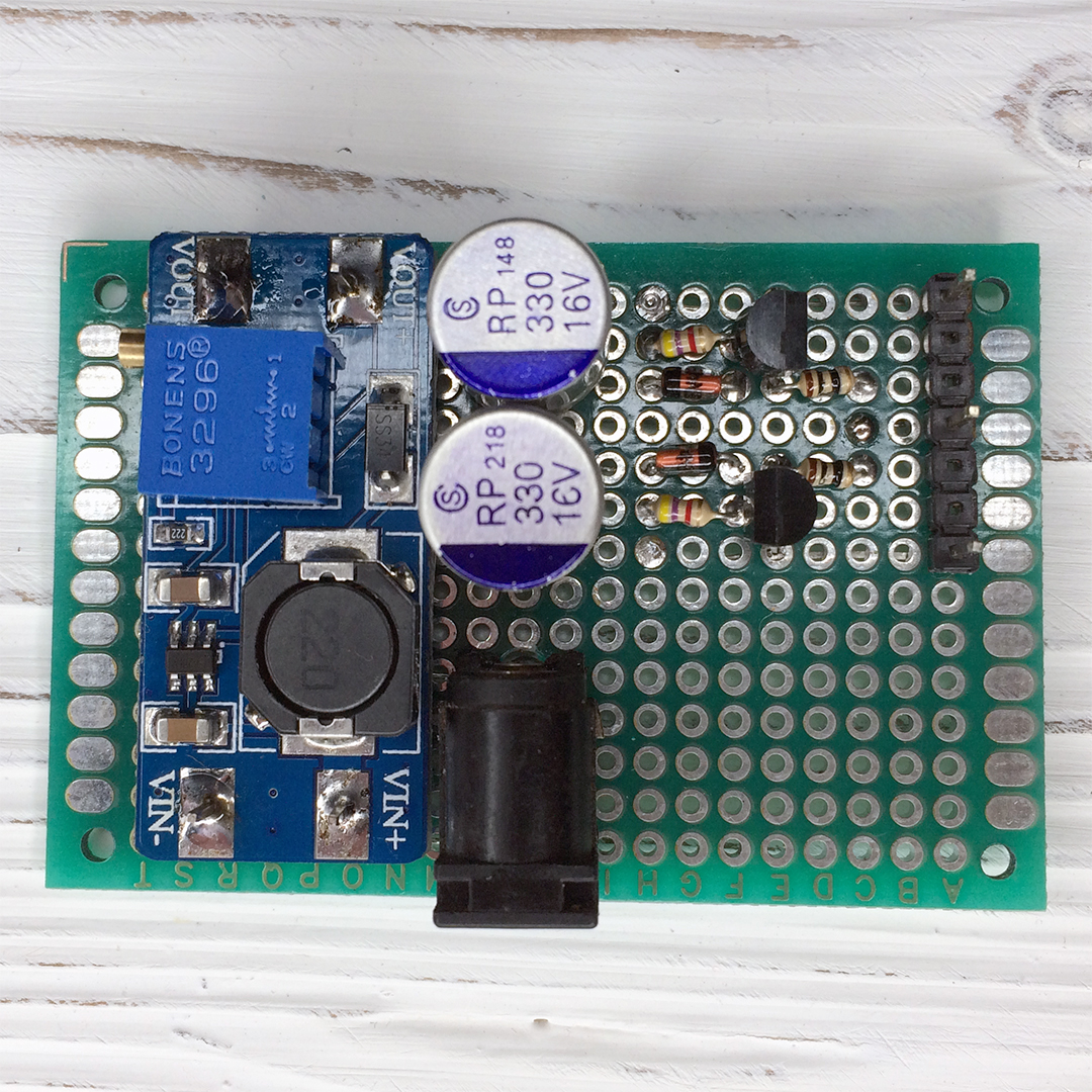

I want to convert BassMaster into something more useful. 5V USB power is very noisy, LPF is noisy, 8kHz DDS synthesis is very noisy...
So, what I want to do:
1. Extrnal dual power supply.
2. Make VCO more analog.
3. Make good LPF.
4. Play MIDI file from SD card.
5. Make it compatible with RhythmMaster 85.
6. Keep it all as simple as it possible.
I've started with dual power supply. I've just soldered together cheap MT3608 DC-DC Step Up converter and virtual ground circuit (it's very similar to RITM-2 power supply) of Sijosae: https://tangentsoft.net/elec/vgrounds.html
Tested with op amp saw VCO - no any noise!!!
 Filesize:  954.52 KB
 Viewed:  543 Time(s)

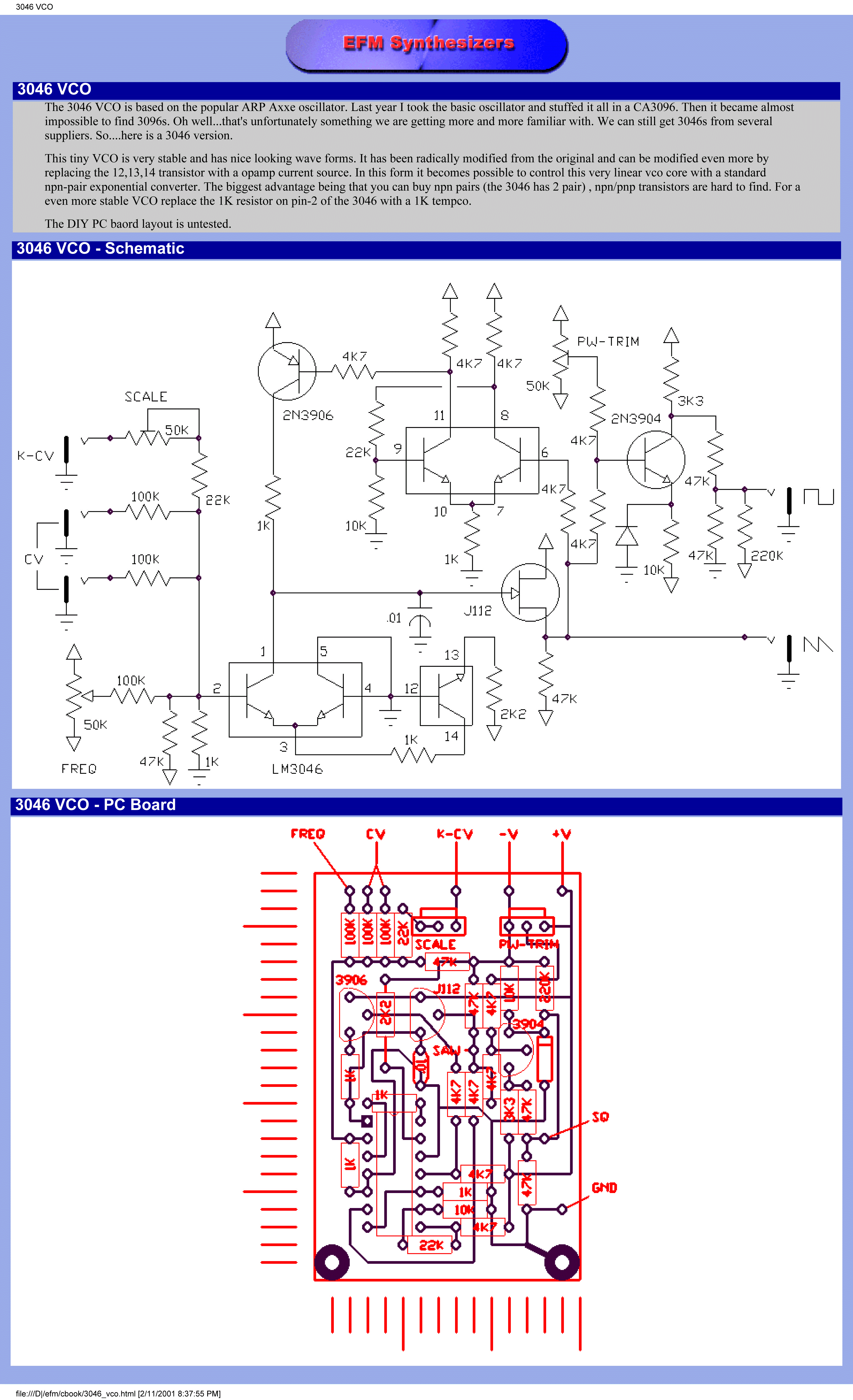

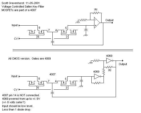

Nice piece of work. As you have dual power supply range of possible circuits is much wider than with +5V only.
Attaching simple VCO and VCF diagrams, may will be some help. Also simple +5V VCF from gasboss, don't know if any use of it.
I haven't made any of them, just collecting schematics Smile
 Filesize:  17.74 KB
 Viewed:  547 Time(s)

 Filesize:  31.41 KB
 Viewed:  550 Time(s)

One more simple VCF I've found - with CMOS ICs.
 Filesize:  4.72 KB
 Viewed:  27802 Time(s)
