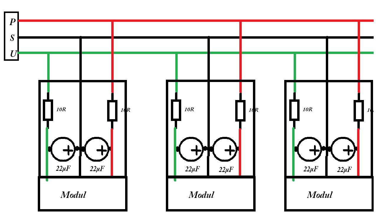

what do you think: does it make a difference if i use only one decoupling cap directly between pos and neg supply?
I had some serious issues with crostalk and ghost-modulation, especially when LEDs where involved, now i switched to 1mm² power wires and have the 10R/22µF combi on each module which helped a lot. I also test every new Module for that bad behaviour to avoid bad surprises when everything is already mounted. On one i had to have a second 22µF on the positive supply side, once again a LED was involved.
I recognized that especially modules which are using Amplification, rather then switching like VCA and VCF, are the "victims" of that crosstalk. which makes sense - if i amplify an instability of 100µV by 100 i already have a "modulation" of 10mV, which is CV-wise well recognizable.

The best Thing to avoid such behaviour with LED's involved is to use low current LED's the 2mA type mostly get bright enough at under 1mA...
most designs have a 1k or 1K8 resistor as LED resistor, this can then increased to 12K or even more…. sometimes i ended up with lower resistors like 6K2 or 6K8 but mostly you can reduce current draw this way much more…
Also if not directly invloved a less stressed PSU benefits the behaviour of your VCO's and reduces Crosstalk between them…
Right now i mostly use 22 to 47uF caps at the power rails of VCO' or VCF's or other sensitive parts and 10uF on stuff like Mixers, LFOs and such...
also each IC get's it's decoupling cap… sometimes it helps to put a few more across the board, but at least you have to Keep in mind that they all add together to the capacitive load of your PSU... when you power your PSU up they all want to be loaded and draw current.
As a General rule all Signal paths and power rails should be kept as short as possible to avoid Signal loss or interferences… even on PCB's or stripboards…
Well i'm no expert but that's what i try to achieve and Keep in my builds…

Project_2501, the cap resistor combination will normally used on (the entrance of) every module, the decoupling caps i solder directly on the copper-side between the V+ and V- Pin of the opamp
good luck

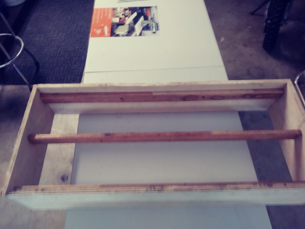

After collecting more parts and hunting layouts/schematics I got my case build and Power supply. Plus I was away for 4 months cause of work.
I went with 40" by 16" size case, Modules with be 4" by 8" or 8" by 8". My baby 8 sequencer will be 16" by 8".
Plan is to build a module one at a time. So once I have more than one module, I'll attack the power management.
Going into Paint in a few days, should be buzzing some sounds out of this box very soon!
Case cost no money Laughing Scrap 3/4" ply, scrap 3/4" oak trim. *I tried thinking of metric, but Everything here in the states is standard. Easier to think/shop for standard.
