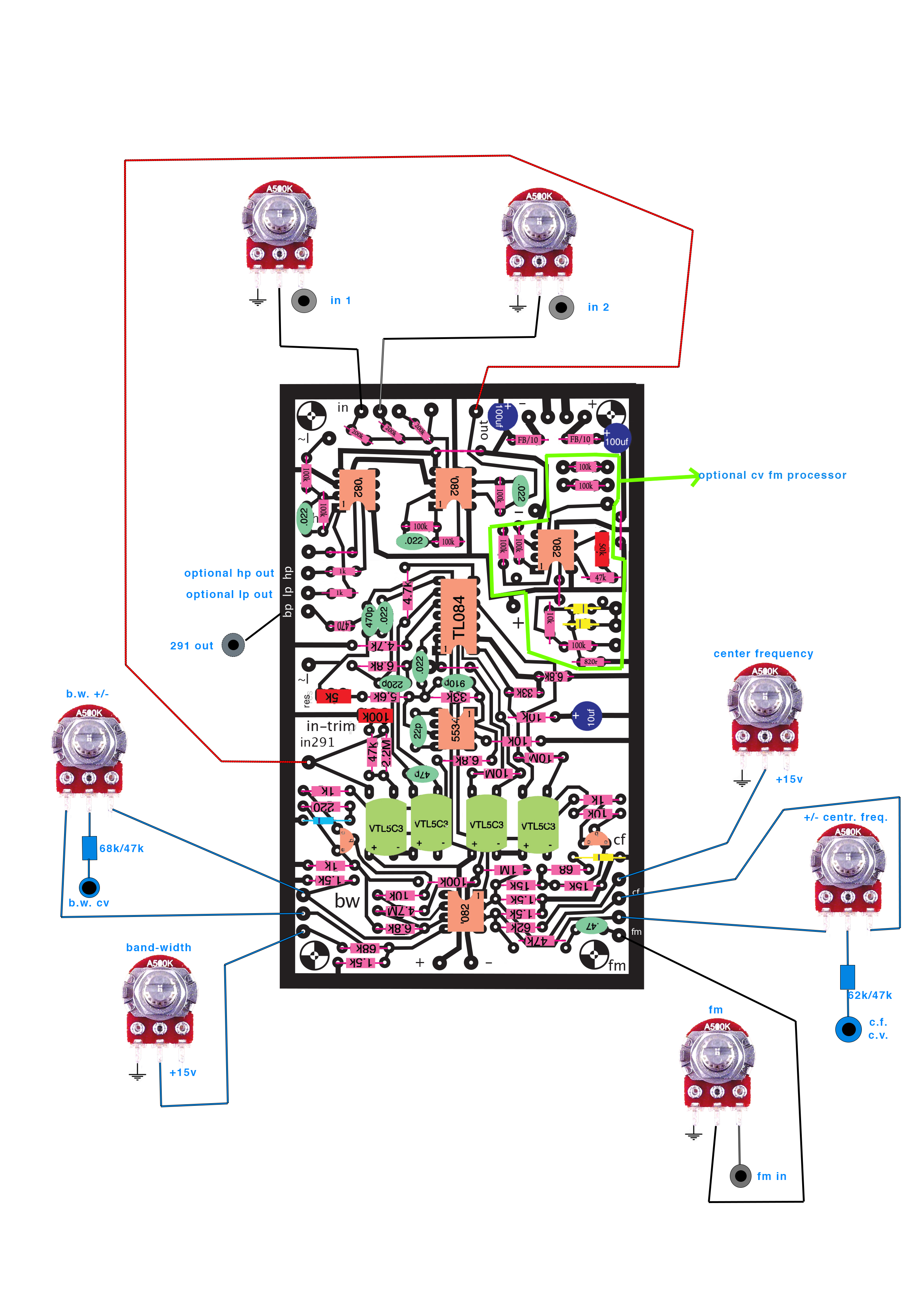

PostPosted: Thu Jun 28, 2018 3:27 am    Post subject: Reply with quote  Mark this post and the followings unread
Hi anyone can help please ?? Do I should connect bp, lp, and hp to the 3 mix in points?? thanks!! Smile

fuji wrote:
Hi anyone can help please ?? Do I should connect bp, lp, and hp to the 3 mix in points?? thanks!! :)
This filter is a BP one. The main output is the BP.
The LP and HP outputs are tapped from two points of the circuit and each one uses a buffer both to avoid influence on the filter and to adapt the level.
I don't see the mixer you mean.
The only mixer in Scotts schematic is for the input, not the outputs
Fer

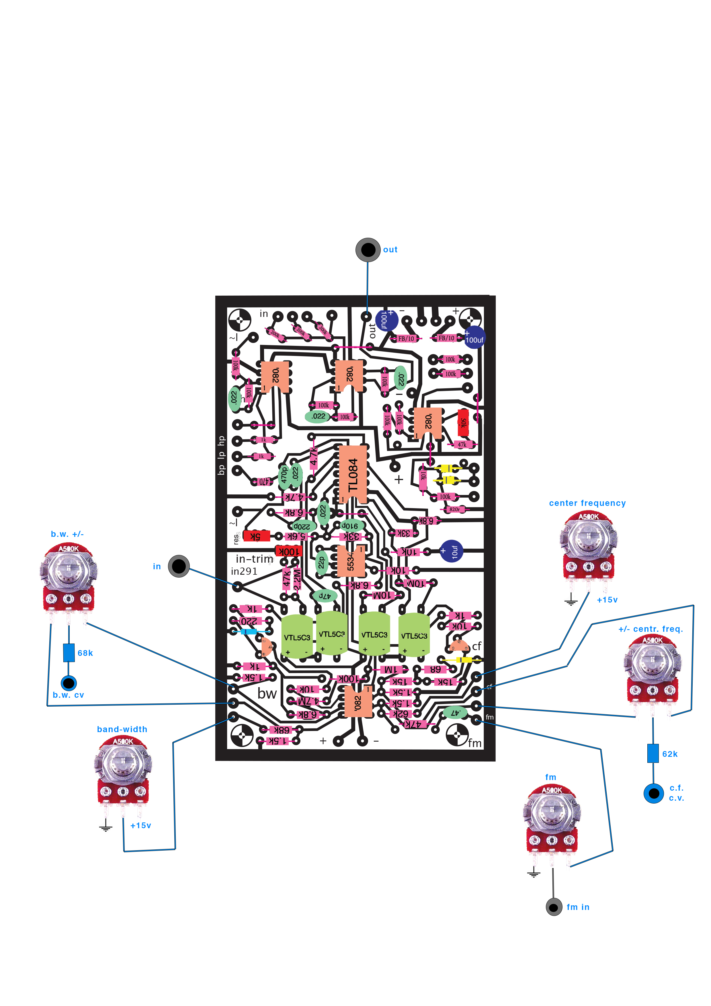

PostPosted: Sat Jun 30, 2018 4:55 am    Post subject: Reply with quote  Mark this post and the followings unread
hi thanks for reply!! Very Happy so whit this basic layout it should work?

fuji wrote:
hi thanks for reply!! :D so whit this basic layout it should work?
Fernando wrote:
You are using Mark Verbos pcb, which reflects Verbos schematic (= Buchla schematic with the dual FET erased and substituted by an op amp twice)
Scott's one is a modern redrawn of Verbos schem, aditionally showing the LP and HP taps and a buffer for each, plus an input mixer. It looks clearer to me.
Compare both schematics.
It is really enriching to look at both schematics plus the Buchla original.
Also check Ebolatone's blog for CV input resistor values, etc: http://ebolatone.blogspot.com/2013/06/j3rks-291-clone-build.html
he is using J3RK pcb, but refered to same circuit/schematic
Fer
Fernando
Joined: Dec 30, 2006
Posts: 286
Location: Barcelona & Emporda, Spain
PostPosted: Sat Jun 30, 2018 11:54 am    Post subject: Reply with quote  Mark this post and the followings unread
FM-input pot wiring is wrong in your drawing - compare with schematics:
you should exchange conections on the pot (the two not being ground). Center leg (wiper) is what should connect to the circuit and the banana to one side of the pot.
The rest looks good to me (to me : )
BTW, you could implement the 100k trimmer at the main audio input as a 100k panel pot, "in-trim" in your Verbos pcb drawing.
(looking at the Buchla and Verbos schematics; Verbos pcb in your drawing is based on that. Scott schematic has an input mixer, so input is slightly different)
And the 5k "Q" trimmer as a panel pot too ("res" in your Verbos pcb drawing) See below.
This trimmer (5k) is intended to be set this way (as per original Buchla schematic):
"trim for no oscillation at 2kHz with 2kHz signal input and minimum bandwidth"
One could implement it as a panel pot and mark on the panel the point where this setting is right, to have a reference mark for the "originally intended" response.

PostPosted: Sun Jul 01, 2018 3:02 am    Post subject: Reply with quote  Mark this post and the followings unread
yes Fernando I agree everything you said... btw I checked all the schematics and pcbs and made this new layout (last one has few errors)...the only missing part is the optional cv processor section
Fernando wrote:

PostPosted: Sun Jul 01, 2018 4:49 am    Post subject: Reply with quote  Mark this post and the followings unread
- I would let alone the FM input, same as the original. It was intended for audio signals (*) to modulate the cf in addition to a CV on the cf CV input, which already has attenuator/inverter and offset controls. Of course you can modulate it with an AC control voltage too or a very low freq audio signal. So I (I : ) would not add anything to this input.
You could tweak the values of C8 and R45 to achieve the response you like for this input.
* (take a look to a Buchla 291 original panel: FM input is a jack, not a banana)
- I preffer the input of this filter as per the original (100k trimmer or 100k pot) So I would not implement (again, I : ) the input mixer as per Scott schematic.
I'd rather build a mixer on the same panel with inverting capability (to be able to have VC resonance using an VCA, among other things) and a bit of gain. Two or three channels that can go from -1.5 to +1.5, it's just a dual op amp, same as a Serge processor/mixer, as in here:
https://www.cgs.synth.net/modules/cgs04_mix.html
but choosing the resistors for 1.5 gain instead of unity (so it will go from -1.5 to +1.5) and using the "processor" inputs (in red), not the normal ones.
Gain of 1.5 is just an idea, it could be just unity; the filter is by itself very hot (it can go to 20Vpp output for 3Vpp input with certain settings/signals)
Again, this mixer/inverter being a separate circuit and leaving the 291 input as per the original.
- I don't understand why you connect the BP out to the input of the filter??? (the red line in your drawing)
Fernando wrote:
Fer

hi Fernando Laughing , the out pin on the top of the pcb is the simply out of the input mixer/buffer (it is not the out of the 291)... so you can connect it or not to the input of 291 (i think i will bypass it using only a 100 trimmer as you said - and bypass also the cv fm in section)..the real bp filtered out is the one on the left
Fernando wrote:
- I would let alone the FM input as it is. It was intended for audio signals to modulate the cf in addition to a CV on the cf CV input, which has attenuator/inverter and offset controls already (take a look to a Buchla 291 original panel: FM input is a jack, not a banana) Of course you can modulate it with an AC control voltage too or a very low freq audio signal. But I (I : ) would not add anything to this input.
I'd rather build a mixer on the same panel with inverting capability (to be able to have VC resonance using an VCA, among other things) and a bit of gain. Two or three channels that can go from -1.5 to +1.5, using a dual op amp, same as a Serge processor/mixer, as in here:
- Someone reported problems (read this thread carefully) using a dual op amp to implement the two buffers for LP and HP outs. You better use two single op amps now that you will etch your own pcb.
- You better use 07x instead of 08x
Fernando wrote:

fuji wrote:
hi Fernando :lol: , the out pin on the top of the pcb is the simply out of the input mixer/buffer (it is not the out of the 291)...
oh ok :D
But if you implement Scott's mixer then you have to build the input as per his schematic. Note it is not the same as the Buchla/Verbos schem.
It has a pull-down 100k resistor and not the 100k trimmer, etc.
