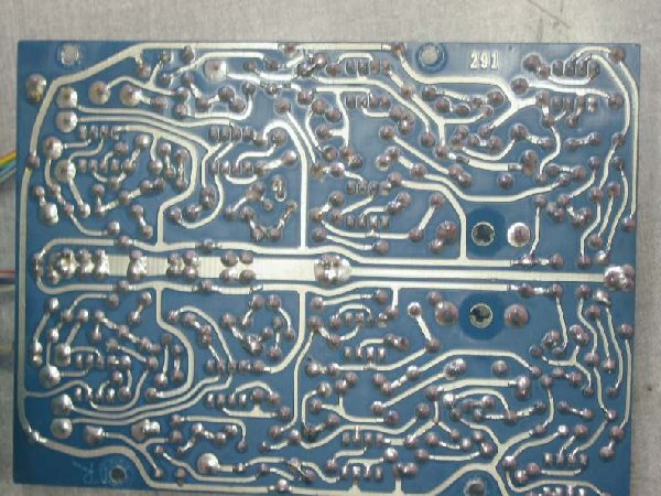

somebody knows where i can find the original schematic of this one (not any re-draw)?
beautyofdecay_
Joined: Aug 14, 2009
Posts: 38
PostPosted: Wed Nov 03, 2010 8:31 am    Post subject: Reply with quote  Mark this post and the followings unread

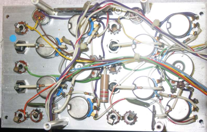

Here is the original schematic: http://rubidium.dyndns.org/~magnus/synths/companies/buchla/Buchla_2910_150.jpg
And pics of the the PCB and front panel back...
Buchla 291 PCB component side
 Filesize:  72.32 KB
 Viewed:  602 Time(s)
Buchla 291 PCB traces
 Filesize:  73.25 KB
 Viewed:  564 Time(s)
Buchla 291 front panel back
 Filesize:  58.11 KB
 Viewed:  601 Time(s)

In the above pic of the original PCB, I note a pair of silver mica caps in each filter. Wonder if those are the .022s?
