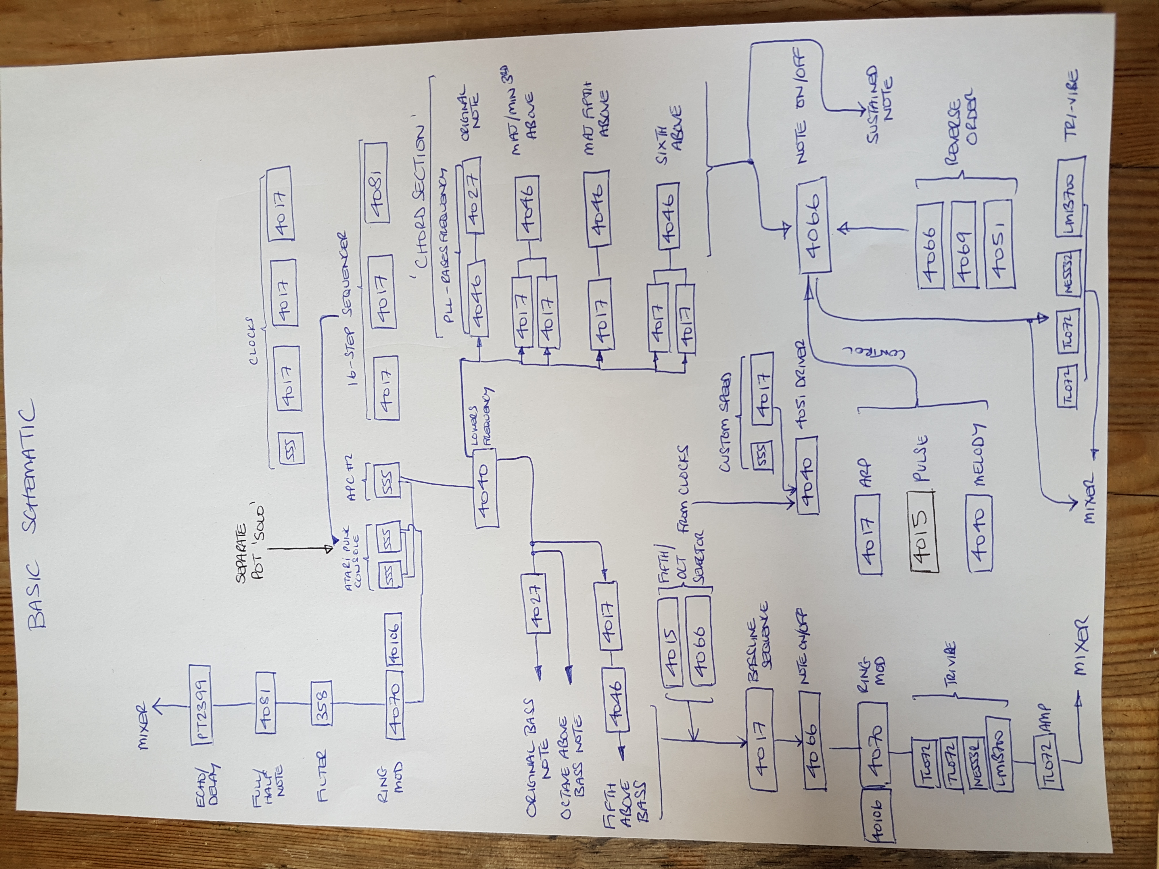

PostPosted: Sun Jul 01, 2018 6:20 am    Post subject: Reply with quote  Mark this post and the followings unread
It started as an Atari Punk Console but has grown into a bit of a monster Confused
I've attached a block diagram of how the chips connect (like a flow chart)
But the basic idea is:
16 step sequencer for the "lead"
4 individual notes to play background chords/arpeggios
A bassline
The same 555's produce everything so it stays "in tune"

I had to print out that block diagram to fully appreciate what you are building. Shocked Very Happy
I notice a lot of 4046 / 4017 combinations. To save on board space it might be worthwhile to look at this circuit: http://electro-music.com/forum/topic-28799.html for your VCOs. You can feed the control voltage from an XOR / resistor / capacitor type comparator but you will need 50% duty cycles to compare. Get them by using the 4018 instead of the 4017. Because of the extra glue logic you might find this doesn't save much but it could be worth checking.

Cheers for the suggestion Steve. I need any help I can get saving on space. This is my first build and it's bound to be made it in an inefficient way. I read the thread you linked but I"m a bit unsure how to apply it (will give it a few reads to make sure)
Those 4046/4017 combos are just frequency multipliers to get 3rds and 5ths etc.
I love the sound of the 4046's Very Happy the only drawback is you can still hear the internal VCO whirring during any dead time - i.e notes switched off in the sequence
