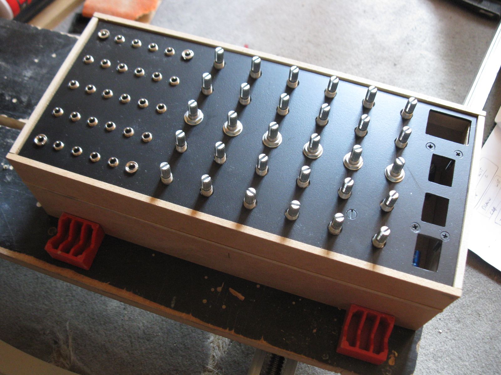

so, what do I want ?
The bare mimimum would be a small box with controls for each parameter which I can place on top of the synth and plug into its MIDI input.
The controls are made with potentiometers configured as a voltage divider connected to analog input pin(s) of the Arduino. The Arduino will
read the control values and send out the corresponding midi message.
Since I am already using voltages to control the parameters the next step would be to add external inputs for CVs from my modular synths.
I could actually make the whole controller into a synth module, but it might get a bit too large for that and I am also not sure if it would be very
practical to use. It would make it easier to patch though. I will try to keep it simple so no extra controls for external inputs, probably no buffers
either. The easiest thing would be to connect the external inputs directly to the control pots using sockets that will normalize it to 5V when nothing
is plugged in. So when an external CV is connected they will function as attenuators for it.
A CV input to control the actual pitch would be nice too. That means I could use the synth as a VCO (I am not much of a keyboard player anyway).
I can't just sweep the frequency (at least not to my knowledge) but I could convert the voltage into appropriate MIDI commands to simulate
pressing the keys. I could actually add a quantizer with different scales. I am not sure yet how to handle Note On/Off though. If I treat it like a
standard monophonic VCO I could just send Note On/Off messages when the pitch changes but an external gate input might make more sense.
However, it is a 6-note polyphonic synth so it would be a bit of a waste if I didn't make use of that. Maybe 6 CV/Gate inputs ?
Some kind of sequencer/arpeggiator ? It's pretty easy to make a midisequencer with an arduino but how to program/control it ? I could use the
parameter controls for this as well so in sequencer mode they adjust the notes and in control mode the parameters. However, there is a downside
to this method (at least when using pots and not rotary encoders). Whenever you use the sequencer mode you lose the visual representation of
the parameter settings. Code wise it would be possible to add some sort of catch-up so when you adjust a parameter it doesn't change untill you pass
the current setting. A better way would be to use the actual keys on the synth but that means reading MIDI aswell. It's possible but might get a bit
tricky to code (at least for me).
A small LCD display for parameter settings. I think this could be useful to display things like selected waveform and octave, Also useful for quantizer
or sequencer info. If I do add one I will probably come up with some more uses for it.
Storing patches, sequences and other things. The DW6000 can store 64 different patches/voices but I could store them in the arduino.
That just reminds me of another thing. It is possible to select voices stored in the synth through midi too, maybe add a contol for that as well.
Of course you will again lose the visual representation if you'd switch to a different voice.
I will probably get some more ideas along the way and any suggestions are welcome too of course Very Happy

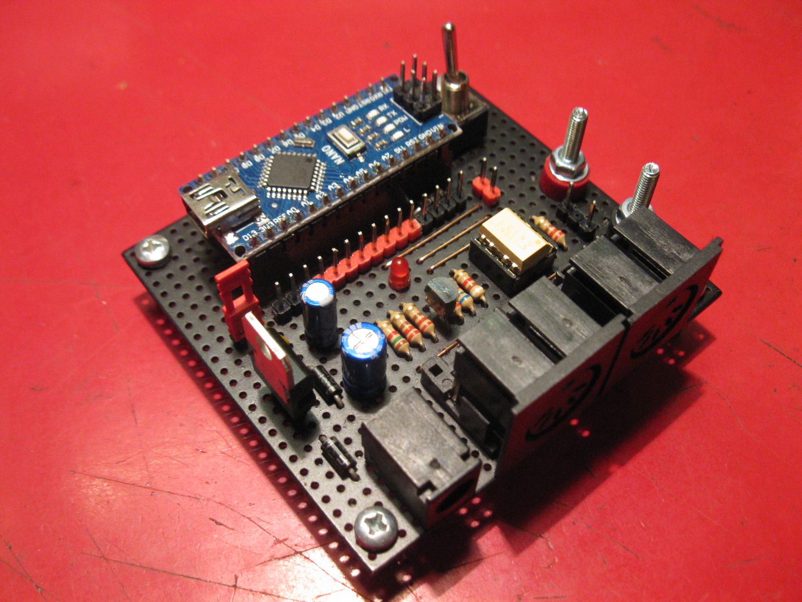

Before I could really do anything I first needed to add a midi output to the arduino. I followed along with this video, tested with
the example code and that worked fine. Next I had to figure out what messages I needed to send to change the parameters.
(note that when I mention the manual I am refering to the DW6000 owners manual which can be found here)
In the midi implementation section of the manual there are bytes and descriptions for all the MIDI messages but it doesn't really
say how to use them. It's probably something standard but that's where my knowledge of MIDI is lacking. I found some information
here that helped me get further:
First you have to declare a sysex array, for example
Code:
byte sysexArray[14] = {F0, 43, 10, 26, 02, 06, 01, 00, 1F, 01, 78, 00, 00, F7};
and then you send that array with:
Code:
MIDI.sendSysEx(14, sysexArray, true);
This made me realize that I'd probably have to send all the bytes mentioned in the manual for parameter change.
11110000 EXCLUSIVE
01000010 KORG ID 42H
00110000 FORMAT ID 30H
00000100 DW-6000 ID o4H
01000001 PARAMETER CHANGE 41H
0vvvvvvv PARAMETER OFFSET (See DW-6000 BIT MAP)
0vvvvvvv PARAMETER VALUE (See DW-6000 BIT MAP)
11110111 EOX
Initially this still didn't work untill I found out I had to change a setting on the DW6000 itself to enable it for sysex messages. After this
I could actually change the parameters. Razz I posted a test sketch here which repeatedly sweeps the filter cutoff frequency up/down.
here's a snippet of code that declares the sysex array:

PostPosted: Mon Jun 18, 2018 7:16 am    Post subject: Reply with quote  Mark this post and the followings unread
I made a test board for MIDI in & out + power. I haven't tested the input yet though. I also looked into the possibility of powering
the controller from the DW6000. The schematic is included in the service manual and the powersupply actually has 3x 5Volt
regulators. However I think it is better to just take the raw DC (11V) and built a seperate regulator in the controller. This way
I could also use an external DC supply if I'd want to.
I also changed the button setup to use an analog pin. Initially I used an R2R but the voltages I got out were not evenly spaced.
I calculated them and what I measures actually seemed to be correct which I found rather confusing. Untill I realized that an
R2R needs high and low signals, while the buttons can only provide a high signal. So I had to resort to a different setup.
 Filesize:  249.91 KB
 Viewed:  940 Time(s)
 Filesize:  270.48 KB
 Viewed:  946 Time(s)

These modules usually have possibility to change I2C address. See attached photo of such module (A0 A1 A2 soldered jumpers).
 Filesize:  274.02 KB

I did a bit of soldering over the weekend.
 Filesize:  349.32 KB
 Viewed:  597 Time(s)

PostPosted: Sun Aug 19, 2018 6:31 am    Post subject: Reply with quote  Mark this post and the followings unread
Cool
 Filesize:  231.53 KB
 Viewed:  515 Time(s)
 Filesize:  234.03 KB
 Viewed:  486 Time(s)
test fit
 Filesize:  252.76 KB
 Viewed:  526 Time(s)
