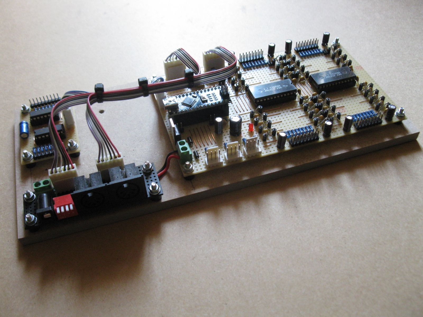

hardware:
The main core will be an Arduino Nano 3 (actually it's just a cheap chinese clone).
As mentioned I want to use potentiometers to control parameters but I am not sure yet if I want to do this for all parameters. There are
actually already 3 parameters for which I will use switches:
bend VCF on/off: determines if the joystick is used to change the VCF cutoff frequency. (I am not even sure if I will add a control for this)
VCF eg polarity: determines if the signal from the envelope generator for the VCF is inverted or not.
Chorus on/off: self-explanatory.
There are some more parameters that only have a limited amount of settings, like waveform, octave, VCF keyboard tracking, interval and
detune. There is no problem with using a pot for these and I can just design the front in such a way that it's easy to see what the setting is but
another possibility would be to use (rotary) switches with a resistor network. However, I wouldn't be able to use them as attenuators for CVs.
I am also not sure yet if I want to use all rotary pots or use sliders for some paramaters. Envelope generators make much more sense with
sliders and there might be some other parameters for which they are more suitable as well. Downside of sliders is that they are a PITA when
making a frontpanel (especially from MDF), finding the right knobs can be tricky and they are slightly more expensive and harder to obtain.
To be able to use so many analog controls I use multiplexers, it can only read 1 control at a time anyway. At the moment I've opted for 2x
4067 which is a 16 to 1 mux. That gives me a maximum of 32 analog inputs while using only 2 analog inputs on the arduino and 4 digital outputs.
I could use 4x 4051 (8 to 1 mux) which is a bit easier to obtain and because it has an inhibit pin I would only need 1 analog input on the arduino.
It would require 2 additional digital outputs though but only needs 3 control bits, so in total it requires 1 analog input and 5 digital ouputs.
I made a test board for it with trimpots which makes it easier to test the code I am writing. I only had 10 pots left though but more are ordered.
As you can see it also has 3 pushbuttons and LEDs. I could use toggle switches and leave out the LEDs which would make the code a bit simpler.
The advantage of pushbuttons is that you can set and change the state in code and they can be configured as momentary or latching. It's also
possible to combine buttons to do different things. (like pressing 1 & 2 at the same time will enter a different mode).
At the moment the switches (and LEDs) are all wired directly to digital input pins on the Arduino. However, I still have 1 unused analog input on
one of the muxes as I only need 31* analog controls. Earlier today I was thinking that I could just use the switches in combination with a resistor
network and connect it to the mux. That would save me 3 digital input pins on the arduino and it would be easy to add more buttons. For the
LEDs it might be possible to use the control lines for the muxes and one additonal output if I add some extra hardware.
If I add CV inputs I need some form of protection as the voltage levels can exceed 5V and also be negative. Grumble did some tests supplying
voltages to in- and outputs and posted the results here. According to those tests a 1K resistor in series might be sufficient. However the signals
first pass through a mux which also needs to be protected and I don't think simply using a resistor would be ok. Together with some diodes to clip
the voltage to the supply rails it could be fine though.
For the normalized sockets it would be easiest to connect them directly to +5V, but when you plug something in there is a moment where the tip
of the connector would be connected to +5V and thus whatever output is connected on the other side of the cable would be as well. In an ideal
world outputs are protected and this wouldn't cause any problems but better not to count on that. Adding a resistor in series should prevent any
problems but also causes a voltage drop in combination with the potentiometers. I could use a slightly higher voltage instead of +5V to compensate
for this or add buffers before the potentiometers. Another possibility is to make some adjustments in the code, I think it's even possible to adjust
the ADC voltage range itself.
I also need a powersupply. I'd like to make it so it all runs on +5V or maybe higher but at least a single supply. I could use a seperate supply for this
but maybe I can tap into the DW6000 PSU and add a connector for it on the back. It shouldn't be needing a lot of current anyway.
* there is 1 more parameter that I didn't implement which is the "Key Assign" setting. It already has 3 seperate buttons on the synth for this and
I don't think there would be much use in adding an external control for it.

PostPosted: Mon Jun 18, 2018 7:16 am    Post subject: Reply with quote  Mark this post and the followings unread
I made a test board for MIDI in & out + power. I haven't tested the input yet though. I also looked into the possibility of powering
the controller from the DW6000. The schematic is included in the service manual and the powersupply actually has 3x 5Volt
regulators. However I think it is better to just take the raw DC (11V) and built a seperate regulator in the controller. This way
I could also use an external DC supply if I'd want to.
I also changed the button setup to use an analog pin. Initially I used an R2R but the voltages I got out were not evenly spaced.
I calculated them and what I measures actually seemed to be correct which I found rather confusing. Untill I realized that an
R2R needs high and low signals, while the buttons can only provide a high signal. So I had to resort to a different setup.

I soldered a second midi cable, did a test and, after removing a solderbridge Embarassed , that worked.
I actually got it working together wth the controller with only a single line of code, at least when using the midi library.
Not sure if it is entirely correct but I played some midifiles from my PC and could adjust parameters while it was playing.

PostPosted: Mon Jul 16, 2018 7:06 am    Post subject: Reply with quote  Mark this post and the followings unread
I did a bit of soldering over the weekend.
 Filesize:  349.32 KB
 Viewed:  597 Time(s)
