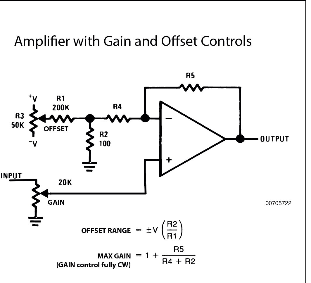

I've been looking around and found this cv scaling circuit. I used an lm324 because that's what I had lying around so I have the extra op amp already. Think it would be worth it to throw this in front of the cv input in an attempt to get this vco to track correctly? Or would that work?

I went ahead and bread boarded this up and after fiddling with resistors for a while I think I've got something. It tracks reasonably well with my ms 10 now. The lowest note and the highest note are perfectly in tune with a little bit of variation in the middle octave. Obviously it's not perfect but it is definitely better. I'm not sure why it is deviating in the middle octave though. Any thoughts?
