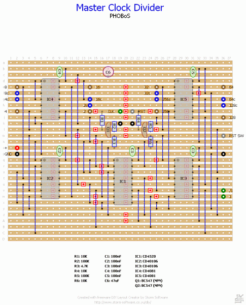

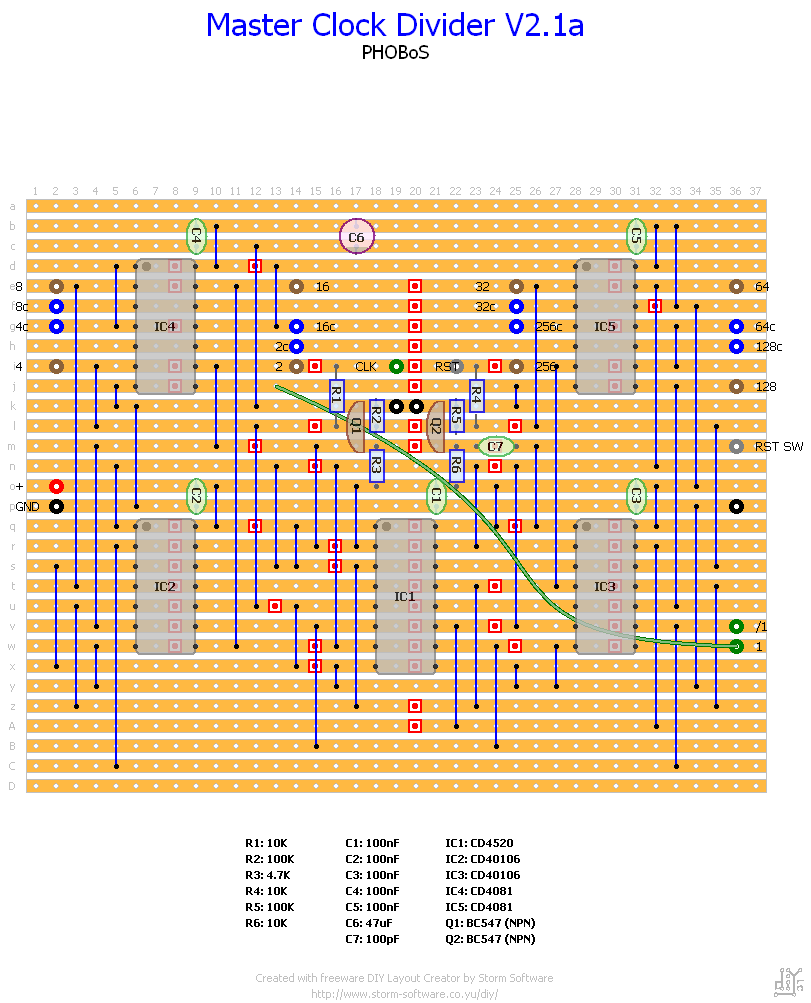

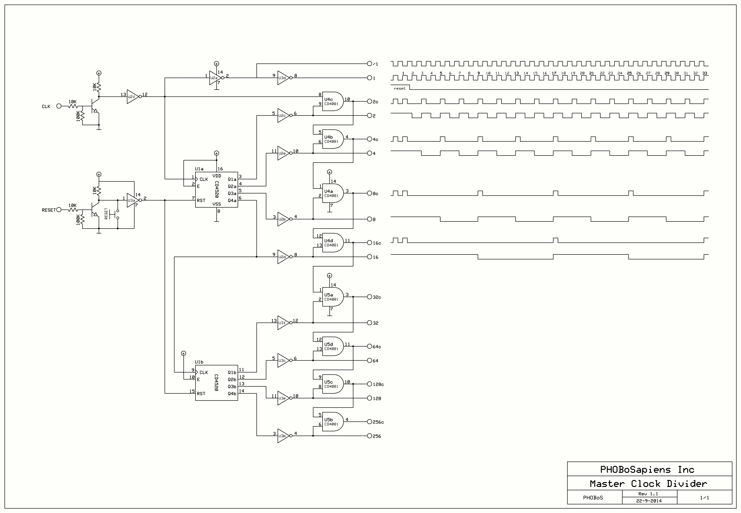

A binary counter with inverted outputs which makes more sense when used for rhythms. And every division has an extra
'c' output which stays high for only 1 clock cycle, as long as the clock signal is high.
I first made a layout with all the chips in a row, but when I finished the design I realized that it was too big to fit
on a standard sized (100x160) stripboard since the strips are oriented in the other direction Rolling Eyes . So I designed a new one
which is a bit larger but it gave me some extra room to add transistor buffers for the CLK and Reset inputs.
I haven't build it yet and only tested 2 outputs, so I'll update when I know it's fully working.
this version isn't working correct, an updated version is posted a few posts down

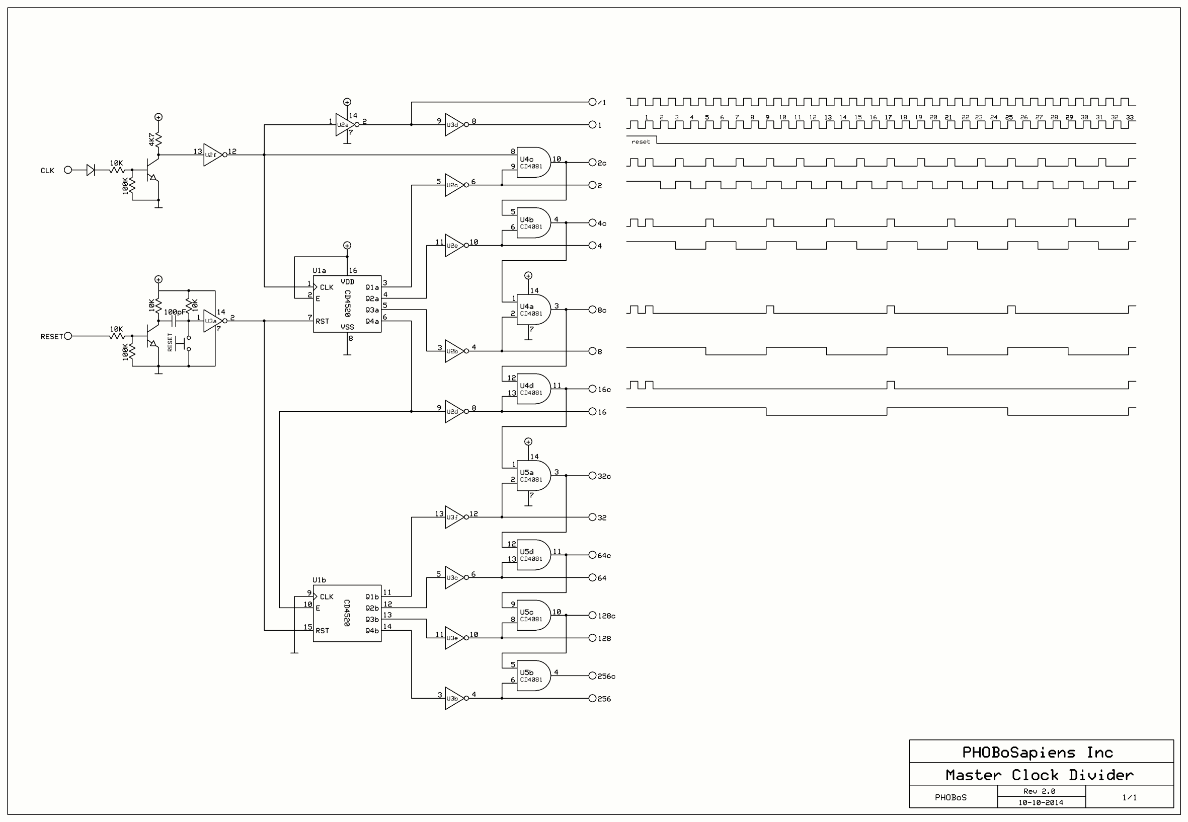

I build it and when I powered it up there were 3 things wrong with it Rolling Eyes
- output 256c was the same as output 128c
- outputs 32,64,128,256 were out of sync with the other 4 outputs. (The divisions were correct but they started at the wrong time)
- It double triggered on the clock so the /2 output was in sync with the CLK and /4 was /2 and so on.
The first problem was fixed pretty fast and caused by a mistake I made on the stripboard design:
I put the 256c output on the wrong trace. Embarassed (should be the one next to it)
Second problem was also fixed pretty fast after taking a look at the datasheet were I found the following:
The counter can be cascaded in the ripple mode by connecting Q4 to the enable input of the subsequent counter while the CLOCK input of the latter is held low.
What I had done was connect the CLOCK to Q4 and make the enable high. Luckely that was pretty easy to change on the stripboard.
Now for the third problem I have to do some more tests. Right now I have the CLK input of the CD4520 connected
to the output of U3d and that works great, but that shouldn't be necessary. I was actually having the
same problem with another divider circuit I breadboarded so I have to figure out how to fix that.
I also made two other small changes to the circuit;
a diode in series with the CLK input so I could connect something that has a negative output voltage.
a capacitor added to the reset input so that it only creates a short pulse. The reset button still works the same.
I will upload the updated versions once I have the double triggering problem figured out.

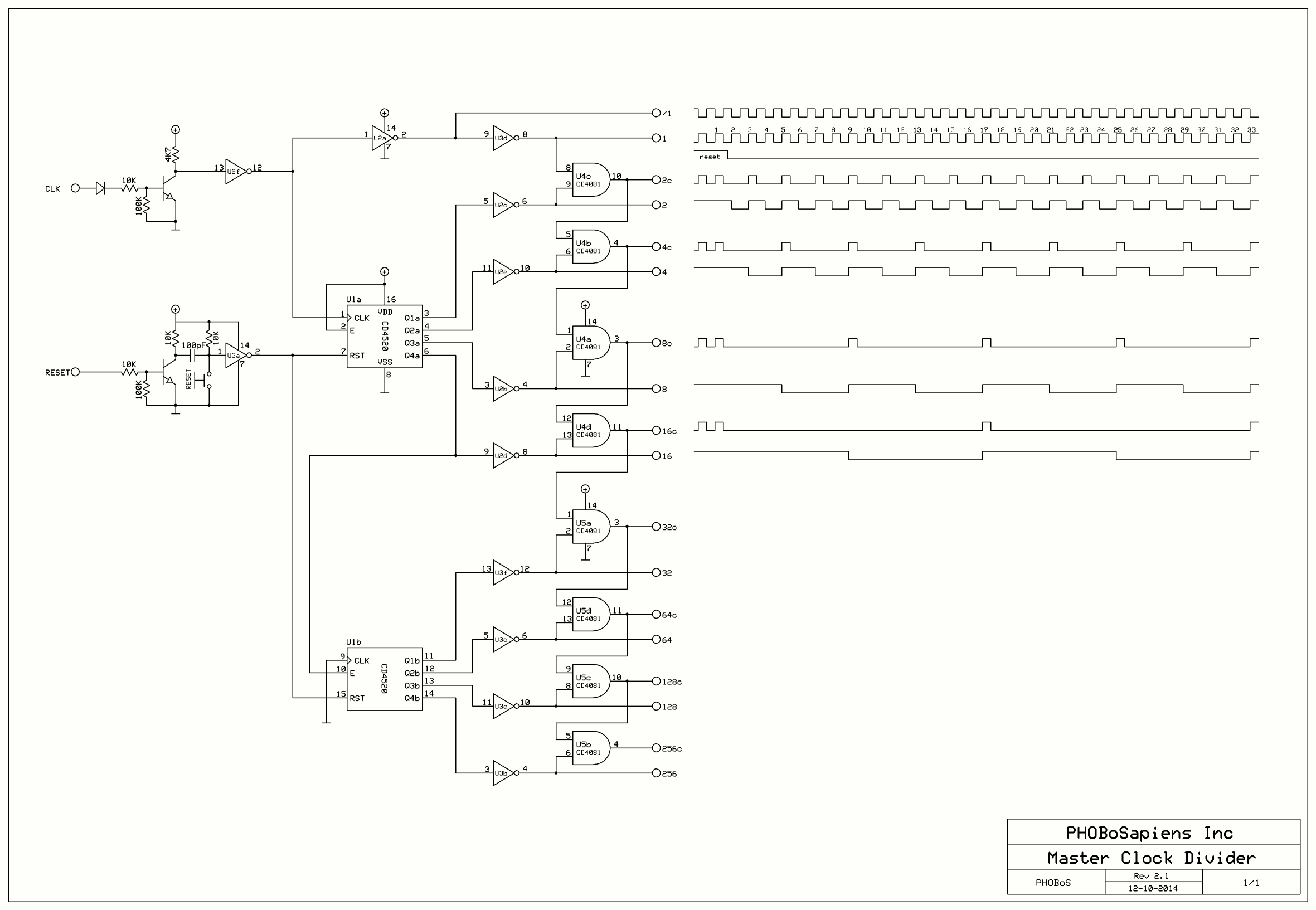

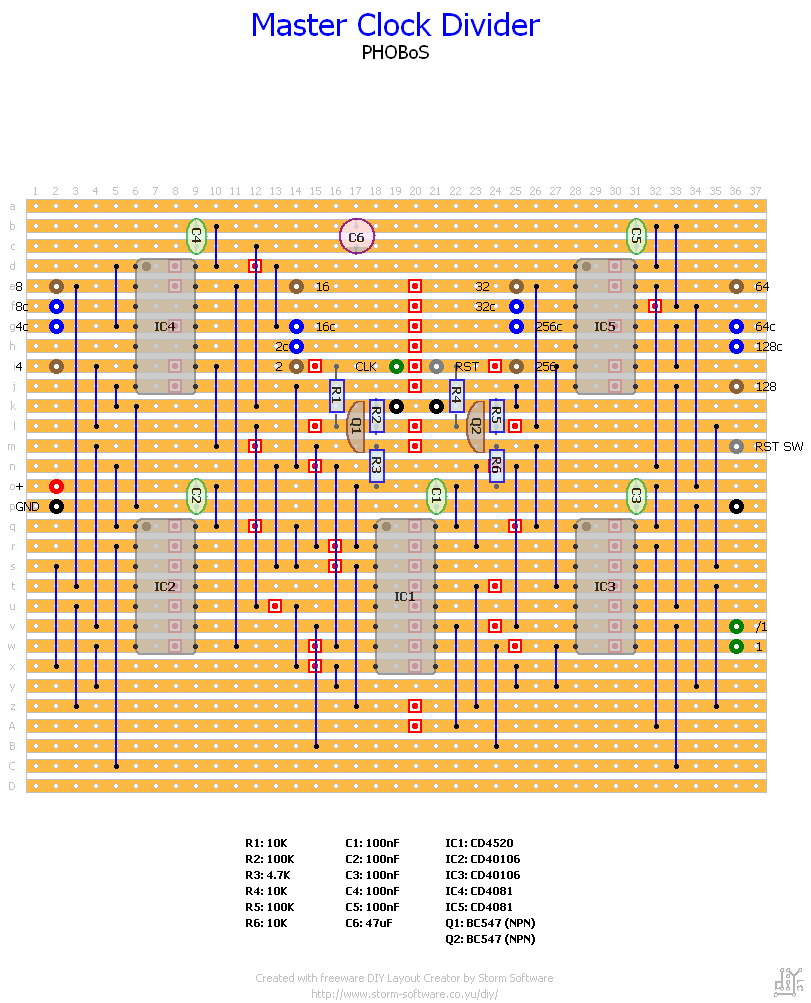

Posts: 5958
PostPosted: Sat Oct 11, 2014 6:11 am    Post subject: Reply with quote  Mark this post and the followings unread
Changing R3 (the pullup resistor attached to the input of U2f) from 10K to 4.7K seems to make it work. Very Happy
So here's the updated schematic and stripboard layout.
(note that there is a cut under C7!)
this version wasn't working 100% correct either, so there is another updated version posted a few posts down
Master Clock Divider schematic
 Filesize:  74.94 KB
 Viewed:  898 Time(s)
Master Clock Divider stripboard
 Filesize:  45.43 KB
 Viewed:  809 Time(s)

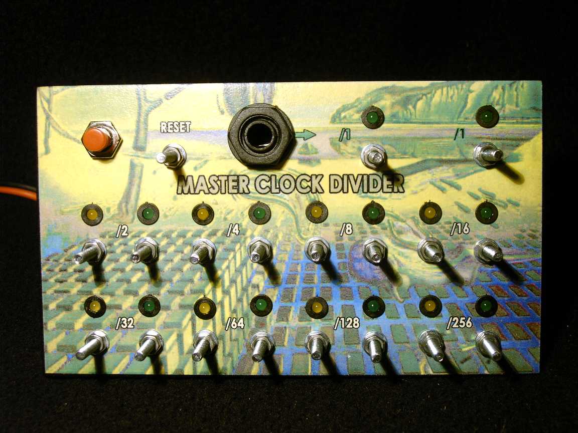

Posts: 5958
PostPosted: Sat Oct 11, 2014 11:28 am    Post subject: Reply with quote  Mark this post and the followings unread
and here's what it looks like Cool
I turned 2 cheap plastic CD storage racks into modular synth racks by adding some wooden mounting rails to it.
Will take some photos once I added the power section.

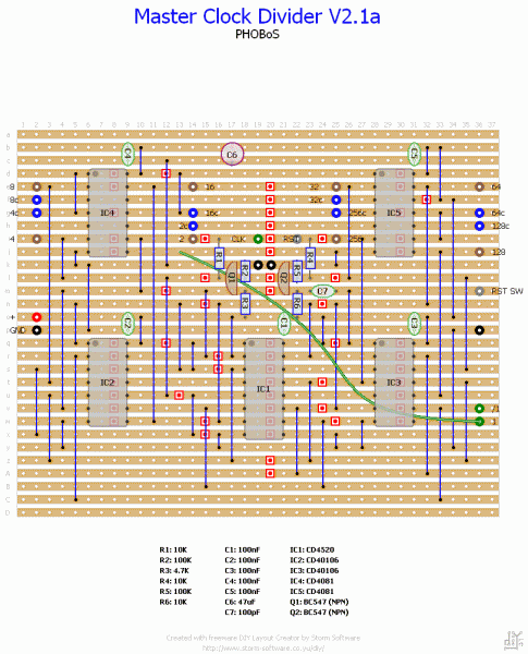

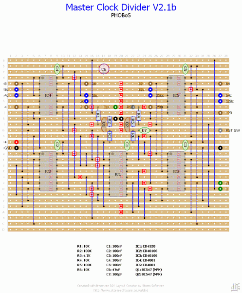

PostPosted: Sun Oct 12, 2014 5:40 am    Post subject: Reply with quote  Mark this post and the followings unread
hmm, so it seemed to work correct untill I started using it to control something else. No problem with the gate outputs
but apparently the c(locked) outputs send out a double pulse Confused . I fixed it (I think) by connecting the input of U4c (pin8) to
the output of U3d instead of U2f.
I just used some wire to connect the two points together (v2.1a) but I also made a stripboard design which uses jumpers (v2.1b).

knowing the CGS Master Divider i imagined that i need just this ,thanks for sharing it PHOBoS ,so i'd like to build it ,but i only need the gate outputs and i am not sure if i need the reset circuit ,can i just leave off the whole reset thing and U4 ,U5 ?
Posts: 5958
PostPosted: Sat May 04, 2019 9:49 am    Post subject: Reply with quote  Mark this post and the followings unread
yes, but connect the reset inputs of U1a/U1b to GND.
Note that the output voltage is the same as the supply voltage so if you'd like 5V outputs use a 5V supply.
I also recommend adding resistors on the outputs for protection.

..guess i should tie unused inputs from the second CD40106 to ground ? i made some PCB layout for it yesterday then i thought what to do with half 40106
Posts: 5958
PostPosted: Sun May 05, 2019 3:30 am    Post subject: Reply with quote  Mark this post and the followings unread
Yes you are correct, although it doesn't necessarily have to be GND.
You could also use V+ or any digital output signal. Sometimes that can be easier to route when designing a PCB.

i guess it would been easier with +V ,i drew it to run on 10V ,added a regulator on the input ,and 2K2 resistors at the outputs ,the manual reset button can be very useful with big divides but like this it's just 8 banana jacks so it fits well in 4U ,if you want i can remove the PCB layout

The power routing is a bit weird but it will probably work fine.
PostPosted: Wed May 08, 2019 9:18 pm    Post subject: Reply with quote  Mark this post and the followings unread
Possibly a silly question, but what is the 7810 voltage regulator doing?

PostPosted: Wed May 08, 2019 11:39 pm    Post subject: Reply with quote  Mark this post and the followings unread
i guess it can do without ,PHOBoS said the output depends on the positive supply so i wanted to make the gates around 10V
