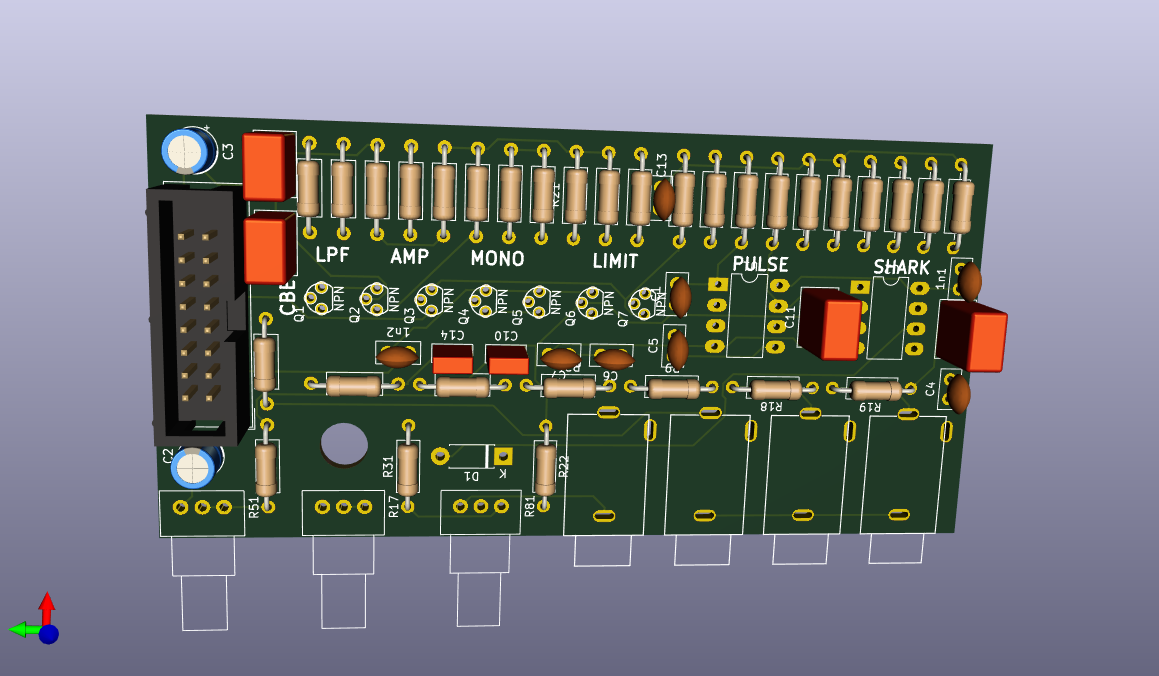

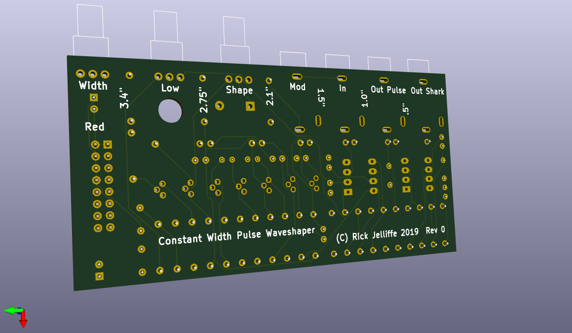

Teaser: Guess what I just sent off to the PCB fab?
 Filesize:  189.26 KB
 Viewed:  457 Time(s)
 Filesize:  111.57 KB
 Viewed:  493 Time(s)

My theory is that a module should not do so many things that you cannot get a grip on the general "sound" or character of it. Once it gets to a certain level of variability, it either needs to be split, or it needs separate personalities (which is why, I think, the successful DSP modules have top-level menus.) So really only two or three kinds of parameters per personality is the maximum (VCF: F and Q good, F Q and slope marginal; VCO: waveshape plus sync good, waveshaper in two axis plus sync marginal.)
I found the top section of the Elby Wavolver II a little difficult in this respect at first (and I can see the same issue in my Shell "Fibonacci " waveshaper module where I am still not happy that the labels are friendly enough): II think the triangle cutting by itself is a strong enough idea (and I would have called "fold" "wet/dry" because "fold" already has a different meaning. But it is a nice module, and I have a good sense of when to use it now.
For example, I have been working on an FSK waveshaper. I made a VST module (private) for this a decade ago, and it works really well: very nice with a breath controller. I say waveshaper, but really it is a VCO with no keyboard tracking, acting as a slave to some VCO with keyboard tracking. The master provides a sync pulse plus it provide FM modulation using the square wave.
So the effect is you have three strong tones: the master frequency and the two formants. Adjusting the master's pulse width alters the ratio of the two formants. I put a demo online
http://electro-music.com/forum/phpbb-files/fsk4amdemo_306.mp3 and a discussion at http://electro-music.com/forum/post-185288.html (someone implemented in an FPGA, which I thought was pretty impressive.)
Anyway, you can do this as a patch with a couple of VCOs and mixers. But it is fiddly, and it is a legitimate style of synthesis/waveshaping with really clear character and clear relationship between knob twiddling and the sound. So having a distinct character, I think it is exactly the kind of thing that would be best as a module,so that people can quickly get it patched into a master and in use. I kinda think that any cohesive patch, that someone might like as part of their signature sound, which takes 6 cables or more is a good candidate for a module.

(This is some thoughts on Ian's observation that waveshapers have not been taken up in the way you might expect given that they can quickly alter sound for a fraction of the price/rackspace of a VCO or EQ.)
My theory on why waveshapers are the most unexplored territory is that we still have some primitive/fundamental building blocks yet to be invented or implemented in analog. Certainly there are still numerous kinds of new waveshapers and control systems not done. This does not mean defeat: it means exploration and excitement.
Waveshapers now have more visibility than anytime in the past as a thing, especially when they can be used in a quick VCO-WS-LPG chain it seems, or when they can be modulated at audio rates. But I think we dont have the necessary control modules to make them shine as much as they could
Here is what I am thinking. Imagine a conventional 3 band parametric equalizer, with F, Q and boost/cut for each band. Now imagine instead that it takes the KCV as input and produces three CVs out. As the KCV gets to the F level, the output CV goes up (or down). This then drives parameters of a waveshaper designed to have very predictable audio effect.
This can be used to give key individual notes a different tone or response. My sax, for example, has a great sweet spot about A5 with only harmonics 1 2 and 4. Or think of the lowest notes of a clarinet chalameau register, the way it gets those overtones. Or think of wolf notes, where some instruments have particular notes which require extra skill to ieepunder control. (Wind and bow instrument players understand why I would want/demand note-specific interaction with tone, but I dont think it is on the radar for keyboard players or drummersthat much.)
Such a thing could be used with a sequencer too. The muso could easily set it up to provide key notes with particular character, and play around that.
Now this kind of thing, where different notes have different characters and the muso takes advantage of this when deciding what notes to play and how to play them is standard operating procedure for every instrument except synths (and perhaps Krumhorns and bagpipes.) We try to simulate the the effect with filter Q and resonators which affect the spectrum if every note, but waveshapers, which should be tools for the job, are out of the picture. Because, I think, the muso cannot easily go from "I want that top A to be sweeter and the middle C to be more singing" and translate them into the geometric terms of waveshaper modules.
So I think the challenge for opening up waveshapers to more people may be to package them for more convenient expressive/melodic interaction (which would also benefit percussive, noise, sequencer, drone, FX etc uses). And this may require other changes to our design thinking.
In concrete terms, maybe all our waveshapers need to have VC crossfaders with the original wave, to allow that kind of "parametric EQ" CV?; so that we can chain waveshapers and pull each in on different notes or articulations or sections. (I have started towards this in a couple of modules due July, which provide "Through" outputs from the audio input, saving a mult or muxer and a cable.) In network terms, as module designers, should our ideal topology for audio be a chain topology rather than a split/join graph topology?
Do modulars need to go more towards a guitar pedal approach, where you have a mega patch but only bring in certain processing when or as you need it? So the ideal is that eveyone has all their waveshapers patched in permanently, used or not? (Which means every processing module needs an in/out switch or a wet/dry knob or crossfader.) Is this an ergonomic mismatch?
