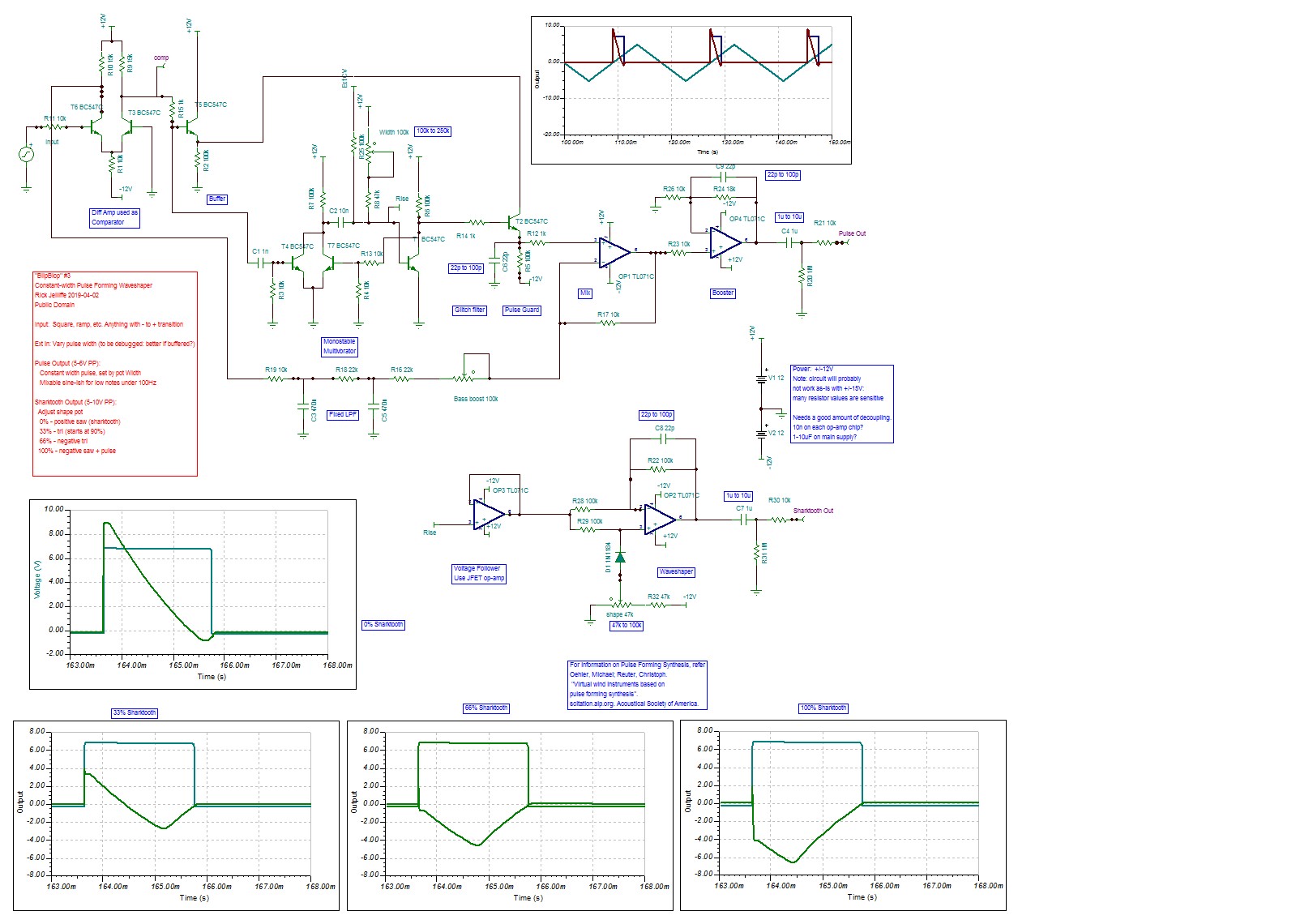

The Variophon synthesizer is very rare. It used a method of synthesis called "pulse forming synthesis", and this method is in fact almost impossible to replicate by stringing together standard synth modules, even though it is quite simple in concept. So I designed and simulated a circuit for it (TINA-TI) and generated some out audio, as a step to stimulating interest.
The basic idea is merely that the output has a fixed width pulse for every frequency: i.e. not say 50% of the wavelength but say 1ms regardless of frequency. (My implementation is just a comparator driving a monostable multivibrator with a selectable on period. Not complicated.)
What does that do? It allows a particular kind of formant generation, one that approximates pretty much of what happens in blown instruments like reed or brass instruments. There are academic papers on it, but let me explain like this: turn your ideas upside down.
First imagine a standard VCO with a pulse output set at 25% running at 400 Hz. Now imagine that we build a circuit to generate exactly the same wave, but using a sawtooth VCO going through some complex fixed filter (or convolution). Now imagine that you change the frequency of that sawtooth VCO going through that same fixed filter: you get the same kind of equalization or formant pattern, but it affects different harmonics now.
And it turns out that this is what happens when you have a fixed pulse waveshape, and you vary the space leaving the mark constant. This is "pulse forming" synthesis.
My implementation has two wrinkles: first when the note goes high enough that the pulse gets to 50%, it won't go more than 50%. And second, it allows you to mix in extra fundamental by having a fixed LPF at around 100Hz. Otherwise low notes get mighty thin.
Here is the circuit. (It really assumes a saw or square input (downward ramping) for the pulse guard.)
Example waveshape at 55Hz and Width knob at half.

Is there a reason you used transistors instead of opamps (or even comparators) and a 555? Great idea to use T2 for limiting PW to 50%, but is the rest just for the simulator?
Great circuit though!
Ricko
Joined: Dec 25, 2007
Posts: 251
Audio files: 27
PostPosted: Thu Oct 05, 2017 7:54 pm    Post subject: Reply with quote  Mark this post and the followings unread
Transistors? The only reason was to limit the different kinds of components. The simulator certainly has comparators and 555s.
I also wanted to have the rising signals in the multi-vibrator available, to be able provide a saw blip out. Having the internals exposed might make it easier to do the Variophon accent thing (slight pulse narrowing and compensating level increase when overblown). I don't think the diff amp comparator is any more complicated in parts count than a comparator chip, and it seemed a good pattern to be aware of. You could certainly implement most of the circuit using a CA3046 (BJT transistor array chip), if you wanted to make it less fiddly to build.
<RANT>Maybe in the back of my mind is the idea that there are all these neat things that can be done almost trivially with a couple of components, and yet we get the same boring tri/sine/saw/sq/pulse waves on VCO after VCO: even Moog went beyond them in the 1970s. I don't know why people put out a new VCO design if it just does the same the same thing as the previous 100 VCOs, or yet another ADSR etc, ...surely adding one extra little unique distinguishing feature per module is not too difficult, like a delay on an LFO etc. Otherwise we end up either with 4HP modules that do almost nothing and $800 modules that do so much, and nothing in between. [Money where my mouth is: I just ordered a Burmuda analog VCO rather than many other choices, because the designer bothered to put in something different, trivially implemented low-hanging fruit.] Anyway, since I don't want to rule the world the next best thing is to have fun suggesting positive little things that can fit in with existing modules. The nice Bergatrophon wind waveshaper is not exactly minimal, so I wanted to show we can get the same family of sounds a bit simpler. </RANT>

PostPosted: Thu Mar 28, 2019 6:05 am    Post subject: Reply with quote  Mark this post and the followings unread
News. I finally got around to building one, and it worked as expected. Quite pleased actually. I will post some audio this week.
Probably the mix pot only needs to be 50k or 22k: half of the travel has no effect. And a larger value fir the 10n cap in the monostable would allow larger pulses there. (The build used BC550 transistors, no difference I think.)
Also : Up-top I wrote that you could not do this with common modules, but actually you can get fixed-width triggered audio pulses with Serge's Universal Slope Generator (and I think with Math?), but they are much more complex circuits,.
To get the real Variophon operation, you would need a few additions tobthus circuit (to put height and pulse width under control of an accent CV, or to have a different shaped blips (up down tri/saw, or half sine).

PostPosted: Tue Apr 02, 2019 6:06 am    Post subject: Add sharktooth output Reply with quote  Mark this post and the followings unread
I have augmented the circuit to add a second waveshaper output, for triangle kind of shapes.
I take the ramp down from the monostable and put it through a simple folder to get a kind of triangle shape, with a pot to vary between various shapes. The pulse width also controls the width of this wave.
I have built this and it gives slightly different sounds to the pulse output, but definitely in the same family. (I am using 5532 for the 2 output buffers, seems fine. ) I'll put up a sample in due time.
You can see on the schematic the simulation results. On the oscilliscope I am getting fairly similar waves to the simulation, but not the sharktooth at 0%, not sure why.
I also have added an external in for mild pulse width modulation - seems to work fine . (For the Variophon, they alter the pulse with very slightly with register, breath level and KCV, but only slightly.) Also added a buffer on the pulse output to bring it up to some more useful level.
(Update: some 180k resistors had fallen into my 100k bin and gotten into the prototype. Correcting these and putting in a pot closer to 47k seems to have fixed that buzz and made the waveshapes closer to the expected.)

Oh yes, I've heard it's bad practice to use opamps as comparitors, bashing against the rails and all that. Lots of folks do it anyway. Very Happy
Instruments with open cylindrical tubes produce alternate +/- pulses. Clarinet, for example, and some kinds of organ pipes, I believe.
In my warped little world I consider the standard Tri and Square waves as double pulses, one up and the other down. They have odd harmonics only, because they are perfectly antisymmetric. The Wavolver and the present DPWG are the same things, except with the sides of the pulses shaved off. (And additionally, variable relative position and amplitude in the case of the new design.) The timbre space of the narrow antisymmetric pulses seemed to be new when I did the original double pulser, but there was never much interest in it.
Ian
https://www.youtube.com/channel/UC8mKuBoR8bfHTLYRJ1sl0RA
http://ijfritz.byethost4.com

My theory is that a module should not do so many things that you cannot get a grip on the general "sound" or character of it. Once it gets to a certain level of variability, it either needs to be split, or it needs separate personalities (which is why, I think, the successful DSP modules have top-level menus.) So really only two or three kinds of parameters per personality is the maximum (VCF: F and Q good, F Q and slope marginal; VCO: waveshape plus sync good, waveshaper in two axis plus sync marginal.)
I found the top section of the Elby Wavolver II a little difficult in this respect at first (and I can see the same issue in my Shell "Fibonacci " waveshaper module where I am still not happy that the labels are friendly enough): II think the triangle cutting by itself is a strong enough idea (and I would have called "fold" "wet/dry" because "fold" already has a different meaning. But it is a nice module, and I have a good sense of when to use it now.
For example, I have been working on an FSK waveshaper. I made a VST module (private) for this a decade ago, and it works really well: very nice with a breath controller. I say waveshaper, but really it is a VCO with no keyboard tracking, acting as a slave to some VCO with keyboard tracking. The master provides a sync pulse plus it provide FM modulation using the square wave.
So the effect is you have three strong tones: the master frequency and the two formants. Adjusting the master's pulse width alters the ratio of the two formants. I put a demo online
http://electro-music.com/forum/phpbb-files/fsk4amdemo_306.mp3 and a discussion at http://electro-music.com/forum/post-185288.html (someone implemented in an FPGA, which I thought was pretty impressive.)
Anyway, you can do this as a patch with a couple of VCOs and mixers. But it is fiddly, and it is a legitimate style of synthesis/waveshaping with really clear character and clear relationship between knob twiddling and the sound. So having a distinct character, I think it is exactly the kind of thing that would be best as a module,so that people can quickly get it patched into a master and in use. I kinda think that any cohesive patch, that someone might like as part of their signature sound, which takes 6 cables or more is a good candidate for a module.

Some time back I found a site with some nice research info on fixed width pulse waves, but I can’t locate it now. Don’t remember if it was connected to the Variophon or not. Anyone remember this? I breadboarded up a monostable pulse shaper at the time but didn’t really care for it, so I set it aside. The duty-cycle limiter trick is cool. I’ll put it on my list of ideas to try out in Reaktor.
It may be true that acoustic instruments don’t usually have double pulses. But it is also true that many instruments have second harmonics that are stronger than the fundamental. You can’t produce a spectrum like that with a single pulse. This was my reason for adding a second pulse — the fundamental can actually be completely cancelled (when the pulses are symmetrical).
