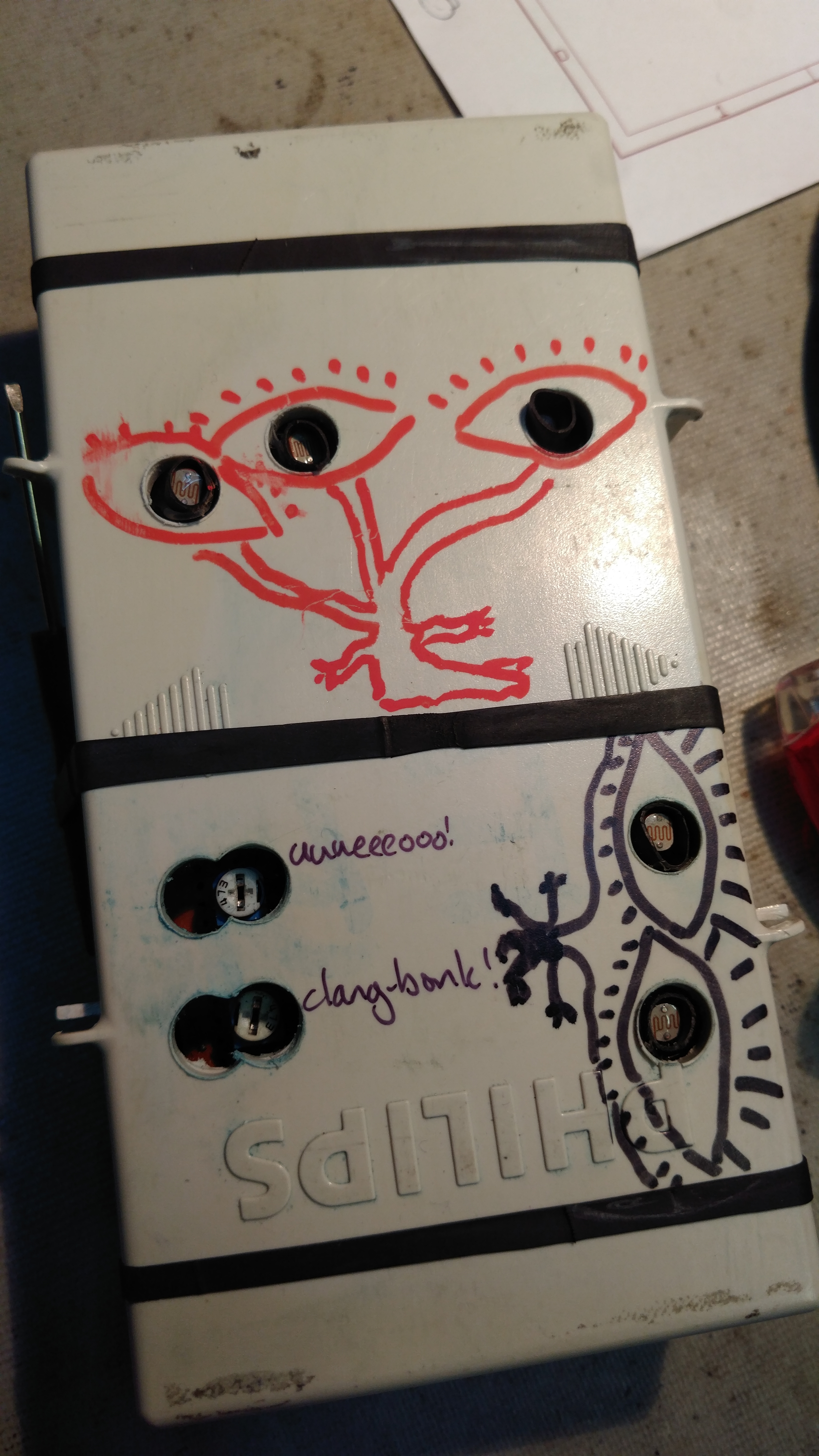

Just got to bring the build quality down to a more achievable level for me here.
This is 'uuueeeooo and clangbonk.'
They are a pair of light controlled lunettas, mixed together. Uuueeeooo is a 3 TRI oscillator drone with different base pitches, clangbonk is a decay only percussion with rate and decay control over an XOR From 2 of uuueeeooo's eyes.
Yep, its an old battery case, held together with rubberbands cut from bike tubes. Durable!
I found out my 8 year olds science theme for the term is light and sound, and that was a opportunity waaaaay too good to pass up. Im taking them in tomorrow and will challenge the kids to tell me what each of their eyes do, plus i will have some flashing bike lights (aka optical LFOs) to make the monsters really scream. Ill have a spectrum analyser app and my oscilloscope so if we get to it the kids can use light to manipulate sound and hear and see it at the same time....
Uuueeeooo and clang.bonk.
