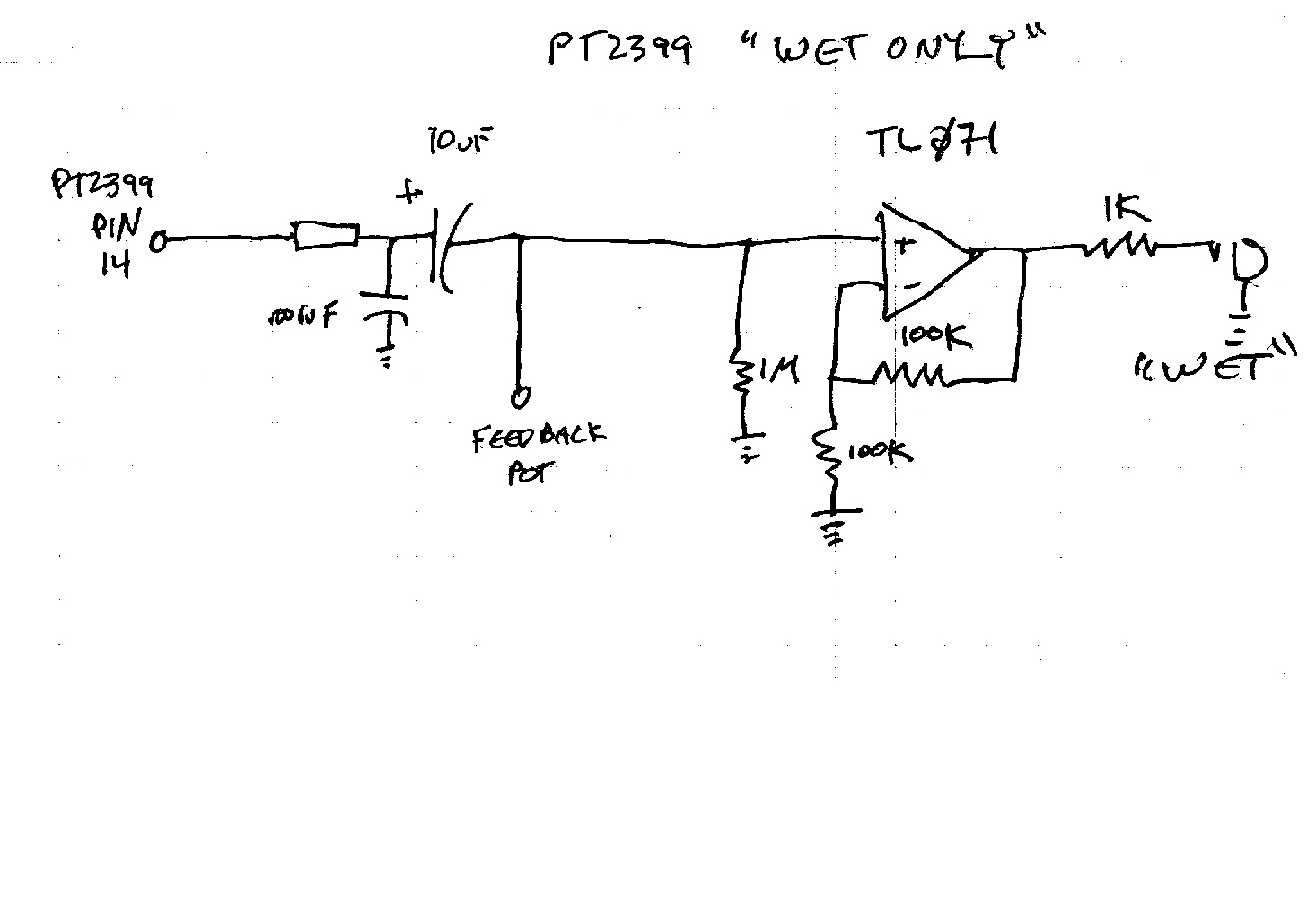

PostPosted: Mon Jun 29, 2020 12:37 pm    Post subject: Wet/Dry? Reply with quote  Mark this post and the followings unread
Hi there
I've built up the PT2399 based on the factory spec sheet as a start.
http://audiodiwhy.blogspot.com/2020/06/pt2399-based-synthesizer-echo-pt-cruiser.html
I am now beginning the process of modding this circuit.
I already have a simple effects send/receive where you put a VCA into the echo loop for CV control of echo (turns out: really easy mod).
Question, I want to add a wet/dry control to a PT2399 design.
I see Befaco has that on their "Crush 3" PT2399 but I can't understand how it works--seems like they use two stages of a 13700 OTA for this, but still, not sure.
How would that work?
I'd want to get rid of the source signal somehow and just end up with the rest of the echo signal (so--what goes back into pin 16, controlled by the feedback pot, only), but I can't see how you can do that w/ the PT2399
Perhaps invert the input and sum it back in to the ECHO signal to only get "everything else BUT input"? (but that would in some cases kill the feedback frequencies as well?)
Does anyone know of a PT2399 design where someone has already figured this out? Maybe something simple I am missing?
Thanks in advance.

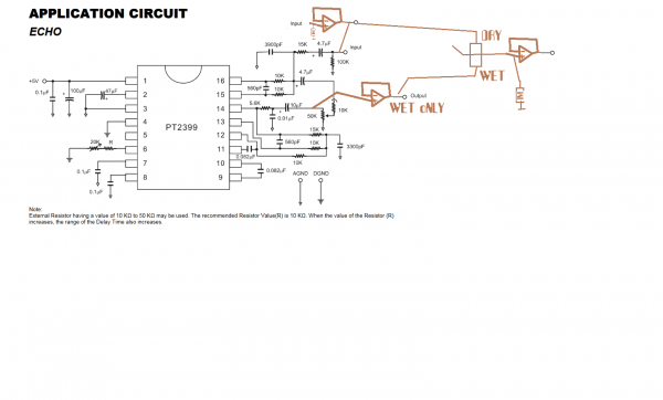

PostPosted: Mon Jun 29, 2020 10:26 pm    Post subject: Reply with quote  Mark this post and the followings unread
the simplest solution that comes to MY mind is attached
ife build two of the Rebote2.5 back in the days
http://www.tonepad.com/getFile.asp?id=98
there you could see how THEY mix together the dry and the wet

Yeh, I will test again, but the "dry" signal is fully present in the "wet" at that output pin from my tests so far. I'll look again, maybe I got that wrong? I need "wet only", as often as possible Very Happy
Back shortly.....

PostPosted: Tue Jun 30, 2020 11:34 am    Post subject: Reply with quote  Mark this post and the followings unread
Smile
the output in the datasheet was on pin 15
i "moved" it to pin 14, the input has no longer direct connection to the output
GL

PostPosted: Tue Jun 30, 2020 12:00 pm    Post subject: Reply with quote  Mark this post and the followings unread
gabbagabi wrote:
Smile
GL
HF
CU
Thanks gabbagabi, I will try scoping PIN 14. If that's "wet only" then we are good....easy solution.

well, dont scope directly on the pin Smile

PostPosted: Sun Jul 05, 2020 9:52 am    Post subject: Reply with quote  Mark this post and the followings unread
Gabbagabi! It Works! Very Happy
Saved my scope Razz
Here is what I used. So far I'm using 2K for the resistor on the left but that might change.
