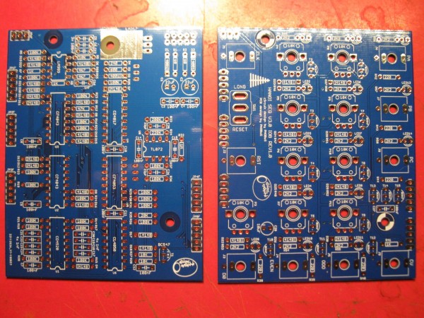

I am turning it into a eurorack sequencer and just received the PCBs.
Don't have all the parts yet though (mainly the pots) but they're on their way.

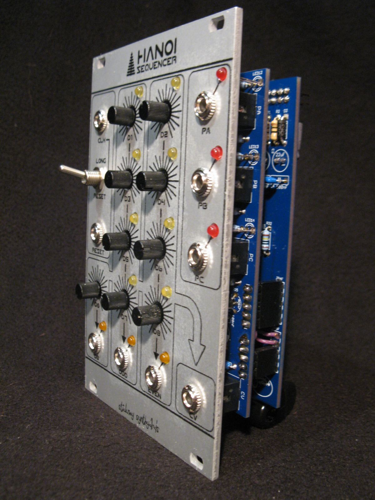

The parts arrived so I put it together. I did make a couple of mistakes in the PCB design Embarassed
but nothing major and the circuit works as it is.
First mistake I spotted was that I placed the pots in the order:
( 1 ) ( 5 )
( 2 ) ( 6 )
( 3 ) ( 7 )
( 4 ) ( 8 )
My intention was actually to have them in the order:
( 1 ) ( 2 )
( 3 ) ( 4 )
( 5 ) ( 6 )
( 7 ) ( 8 )
which makes more sense with the ODD, EVEN outputs below them (I also managed to swap those doh ).
To solve this I only had to swap some connections between the two PCBs.
Another mistake was that I misinterpreted the datasheet for the Thonkiconn connectors and made the holes
for the pins too small. Easily to solve with a small drill but that does destroy the through hole plating.
Luckily there is only one connector that has a trace on the top layer and that was very easy to reroute on
the bottom.
After powering up the main circuit board (without the chips) to measure some voltages I could smell that something
wasn't right. I quickly turned the power off and noticed one of the 10 ohm resistors looked a bit burned. So I am
glad I used those. I realized what the problem was almost immediately. There is a voltage regulator on the board and
as I did with a previous design I used the GND plane as a heatsink, although it shouldn't get very warm. But this is an
LM317 which doesn't have the backside connected to GND but the output so it was shorting that. A bit of insulation
solved the problem and for the rest the circuit worked perfect.
I played around with it a bit which resulted in Dubious Towers (hence the title).
