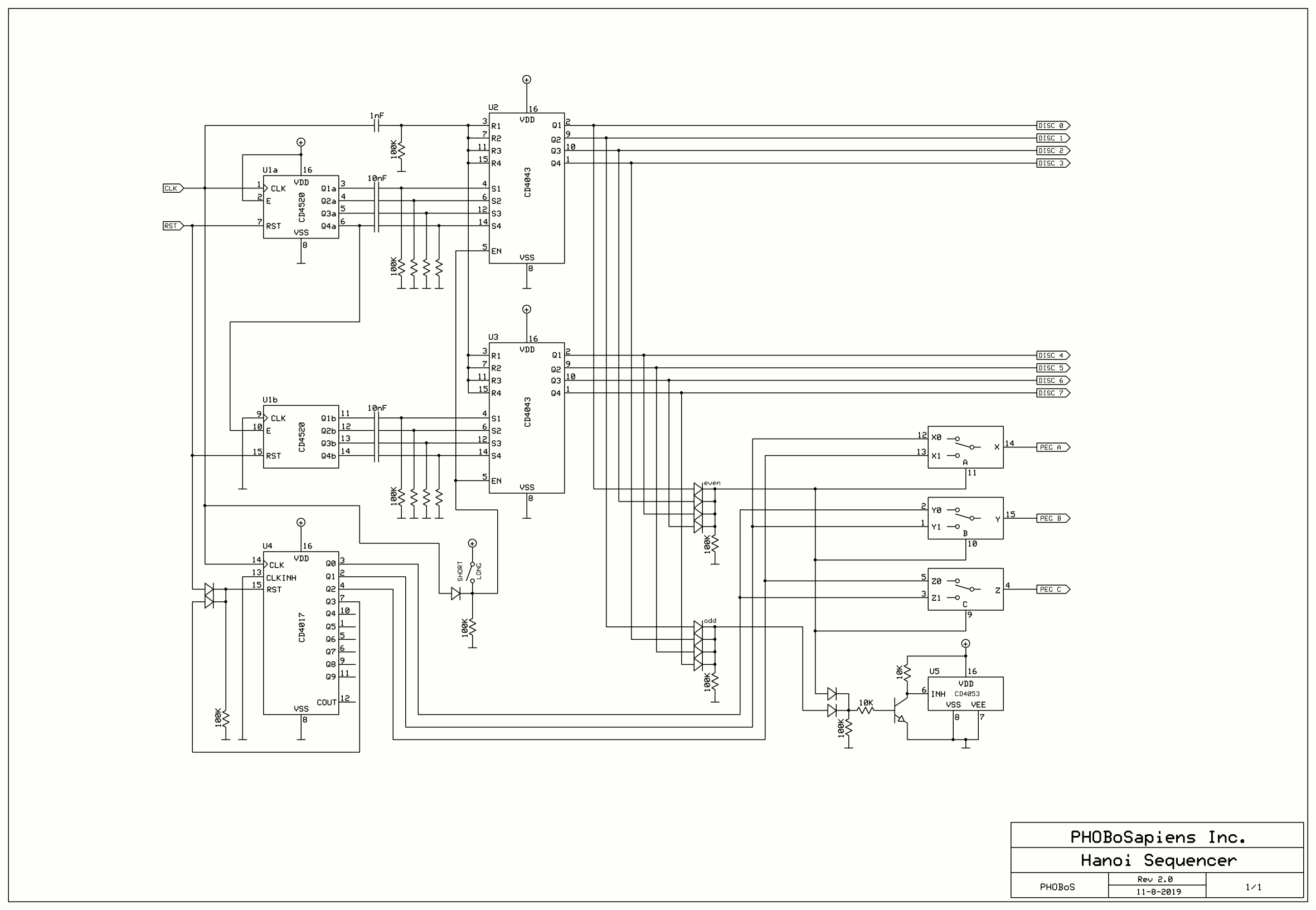

I managed to simplify it a little bit with some muxes. To know if an odd or even disc is moved you only have to look at odd or even,
you don't actually need to check both. At least not while discs are being moved. Also each peg can only be used for 2 of the 3 steps.
The muxes are controlled by the 'even' signal and switch between these 2 steps for each peg.
However this only works as long as discs are being moved which is not the case before the first step (or after the last).
So I added a NOR gate made with two diodes and a transistor to control the INH pin of the muxes. If no odd or even discs are being
moved it makes the INH pin high which disables the outputs of the muxes. This does mean the outputs are basically floating at that
state but that's actually not a problem unless you connect them directly to the input of another gate without a pulldown (or pullup)
resistor. If it is for a patchable system an input can be left unconnected anway so then it should work fine.
I also added the short/long switch to the Enable pins of the flip-flops. As with the muxes this means these outputs are basically floating
when the CLK is low (in short mode) but like I said that's not really a problem. And now short/long works on both discs and pegs outputs.
The diode between the 'odd' signal and the transistor could be left out but it might be nice to have both odd and even signals available
too. If used as outputs it would be a good idea to add some buffers to them.
tested
 Filesize:  85.29 KB
 Viewed:  470 Time(s)

I did breadboard the unrestricted Hanoi Sequencer V2 and that one seems to be working Very Happy.
I added 6 extra buffers (CD4050); 3 for the peg outputs, 2 for even/odd outputs and 1 extra output for the start/end
when no discs are moved. This was easy to add because it is just the signal that controls pin 6 of the CD4053.
Here's a demo video. Yellow LEDs are the 8 disc outputs (0 on the right), the green LEDs indicate even/odd, red LED is
start/end and the orange LEDs are the 3 peg outputs (A on the left). The 3 red LEDs in the bottom left corner are connected
to the 3-step counter. (background music: Luna Supreme (Part II))
( https://streamable.com/mbpr9 )
