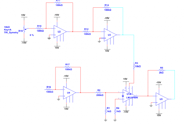

hi guys,
after burning some 13700 back in the days i wanted to manage to use them now.
so i breadboarded a simple vca with a 10k resistor on the gain input, a voltage divider 1:200 on the signal input and a inverting opamp-buffer on the output.
As i switched it on ive got a heavily overdriven signal but the cv was at 0V?
After some testing ive applied a negative cv and the signal got quiter, as the cv was -15V it was quiet.
Is that normal behavior, or what iam doing wrong here?
My simulator multisim is more or less confirming that behavior.

If I understand the question, it would seem to be about the Iabc pin.
Iabc current is referenced to -V not ground.
So to completely quiet a VCA made with LM13700, the Iabc pin needs to be at -V.
Also, the Iabc pin can withstand no more than 2 mA of current. Any more current will blow the amplifier (without any magic smoke fun either). So always make sure there is an appropriate resistor or other current limiting device in series with Iabc

PostPosted: Thu Feb 20, 2020 6:15 am    Post subject: Reply with quote  Mark this post and the followings unread
thanks for readindg my mind!
of course the question was about Iabc.
Good to know that neither iam stupid nor the chips Smile
