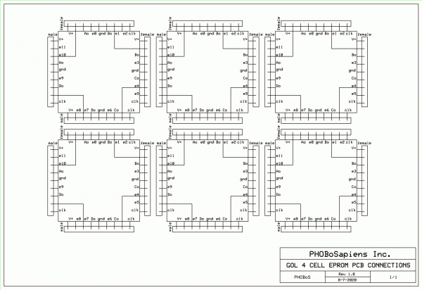

what I haven't been able to figure out yet is how to make the connection (unless I use wires) at least not for 'corner cells'. I'll check some tiling patterns
to see if I can find a useful shape or maybe I can route some things through other boards. So for example if I need to get the signal to a cell in the top left corner,
which would be the position of e11, I could probably just route it through e0 and/or e10.
Ok, it looks like I don't need a fancy shaped PCB to make the connections and can indeed just route the signals through the other PCBs.
So that would be 36 connections per PCB, but I'll probably have to go with 10 pin connectors so make it 40. In that case I might add some
resistors to create a voltage anyway. I do have a SILly amount of SIL resistor networks so maybe I can do something with those.

Posts: 24676
PostPosted: Wed Jul 08, 2020 4:35 pm    Post subject: Reply with quote  Mark this post and the followings unread
Looks pretty with the rotational and translational symmetries Cool
How many PCBs are you thinking of? enoughto make a toroid? Shocked
Posts: 5967
PostPosted: Wed Jul 08, 2020 5:12 pm    Post subject: Reply with quote  Mark this post and the followings unread
I'd probably start with a batch of 10, although the price per PCB (incl. shipping) is about the same for batches from 20 and up.
25 would be a nice grid of 5x5 boards = 10x10 cells.

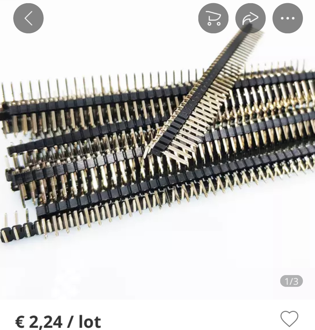

I dont know .. can't you just bend the connectors .. say pin headers, mabe 90 degree ones ... into the correct angle? Then other side can just be 90 degrees so they lay flat on the PCB.
Ah like here.
and then stop somewhere halfway .. like this:
Hmm .. the other side needs some magic to then .. or maybe just not 90 degrees but just straight up.
But I think that I would just use wires .. on the inside .. but soldered on the outside .. although closing the "door" might be a little tricky then .. hmm .. with connectors it will be tricky too.

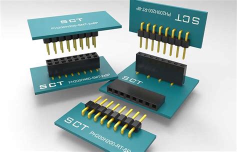

PostPosted: Tue Jul 14, 2020 10:55 am    Post subject: Reply with quote  Mark this post and the followings unread
So I can't just make all
of them the same and then connect it together.
Maybe you could.. by using pin headers everywhere and then a sex changer inbetween .. female to femal that is .. I think I've seen such things as break-off strips too.
But the other way around is possible too .. females on the boards, and male to male inbetween, might be cheaper ...

I was actually looking for those, be it the other way around. Well to be fair I only checked Tayda.
I'll look aroud a bit more as that's actually not such a bad idea.

bijvoorbeeld : https://benselectronics.nl/header-40-pins-male-male-dip-ronde-pinnen/ (a dutch site) .. but they seem rare ... and when i search for sex changers them things seem to be called gender changers these days.
anyway .. that's a double dick one .. didnt really see any double cunts .. you could solder gender force bend 'm together I guess .. soldering up their male ends .. but ugly enough to just use wires instead I guess.
We used to have plenty of that stuff in the old company ... too bad they didn't end up at your place.

I did find these, and these and even amazon has something (didn't really search there). But yeah they aren't very common.
I tried soldering some together years ago but that didn't really work out very well. I'll see how far I get with standard male and female connectors.

There are more types of board to board connectors.
Or you could use ribbon cable and make a flexible connection this way?
 Filesize:  30.44 KB
 Viewed:  10554 Time(s)
my synth
Posts: 5967
PostPosted: Wed Jul 15, 2020 2:56 am    Post subject: Reply with quote  Mark this post and the followings unread
ribbon cable wouldn't work as it also needs a to be mechanical connection, especially for a cube shape. I mean I don't want a floppy cube.
That picture does show something I still have to look for; low profile angled connectors, which oddly enough aren't the standard.
I did find them at TME and they might have some gender benders as well but I try to avoid ordering from there unless I really have to.
Will look a bit further once I am back from work, but I also need to figure out how many pins I actually need. I did make a start at the PCB design btw.

€ 2,24 | 10Pcs 2.54Mm 1x40Pin Ra Pin Header Haakse Male Pin Connector Vergulde Enkele Rij Breakable Header strip R1 R2 Optioneel
https://a.aliexpress.com/_B17fqF
 Filesize:  627.27 KB
 Viewed:  190 Time(s)
my synth
Posts: 5967
PostPosted: Wed Jul 15, 2020 6:18 am    Post subject: Reply with quote  Mark this post and the followings unread
Ah great so thats an option, thanks!
