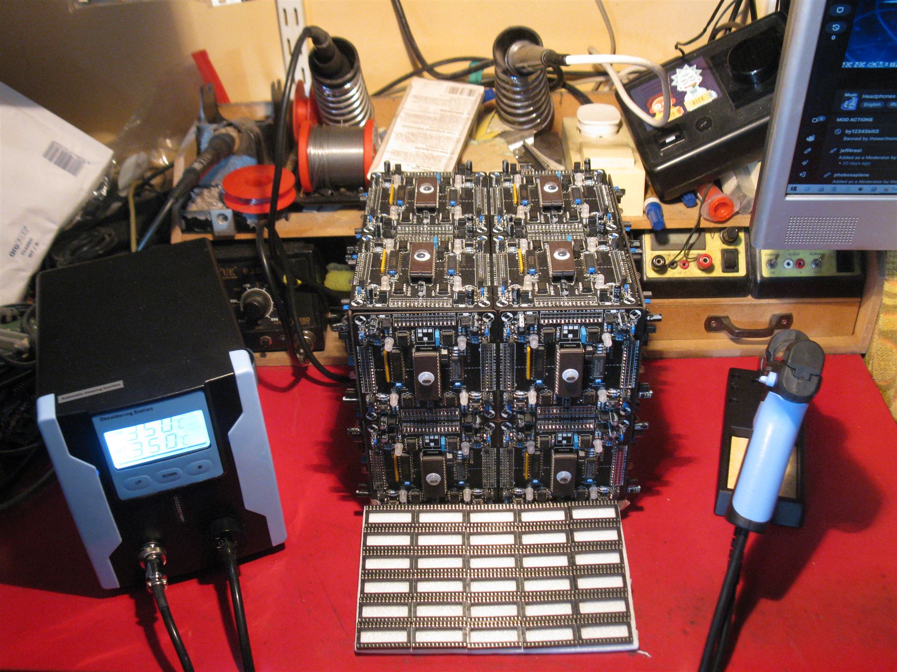

PostPosted: Mon Sep 07, 2020 5:32 am    Post subject: Reply with quote  Mark this post and the followings unread
I have some soldering to do Cool
25 PCBs weigh quite a bit and EPROMS have some weight to them too,
so I am curious how heavy the whole thing is going to be and if it will hold up without any reinforcements

Posts: 5975
PostPosted: Wed Oct 14, 2020 1:02 pm    Post subject: Reply with quote  Mark this post and the followings unread
almost there surprise

Posts: 5975
PostPosted: Wed Oct 14, 2020 1:06 pm    Post subject: Reply with quote  Mark this post and the followings unread
I made some jigs to keep the connectors in place while soldering
jig1 is for the 4 1x3 male pin headers on top of the PCBs
jig2 is for the connectors between the PCBs of one side of the cube
jig3 is for the connectors between the sides (haven't used that one yet)

Posts: 5975
PostPosted: Sun Oct 18, 2020 9:24 am    Post subject: Reply with quote  Mark this post and the followings unread
it's starting to take shape Cool

Posts: 5975
PostPosted: Wed Oct 21, 2020 2:37 pm    Post subject: Reply with quote  Mark this post and the followings unread
I have been testing the PCBs and it is still looking good.
I did have some unsoldered IC pins and a solder pad that was shorting (removed it with an x-acto knife).
Also some bad contact with a couple of EPROMs but I was already afraid that might happen as they feel
a bit loose in the sockets I used. Can get a bit more friction by bending the pins outwards.
Anyway, I managed to fix what didn't work and at the moment every side of 4 PCBs seems to be functioning properly.
Don't know yet what happens when I start connecting sides together which will be a bit trickier to test.

Posts: 5975
PostPosted: Sun Oct 25, 2020 7:39 am    Post subject: Reply with quote  Mark this post and the followings unread
Yesterday I tested connecting the sides together. I went through them in pairs, so connecting 2 sides together, test it,
rotate each side 90 degrees and test again, which means that after 3 rotations all side connections have been tested.
I did that for 3 pairs of sides to get them all tested. Found a couple more unsoldered pins Embarassed , had to replace
a connector and reseat some EPROMS but got them all to work. I am not really happy about the bad connections
with the EPROMs but I only see 2 options for that:
1. solder the EPROMs to the sockets. Apart from it probably being tricky to do that also doesn't seem very practical.
2. replace all the sockets with better ones. I used IC socket strips right now but some low-cost sockets would work better.
The reason that I didn't use those is that it is hard to remove large ICs from them and that can put some strain on the PCBs.
Aslo getting them out straight without a proper extraction tool can be difficult resulting in bend pins. Replacing would mean
desoldering 672 pins from double sided PCBs which I am not going to try without a proper desoldering tool.
Anyway after testing all the sides I put the whole cube together and,... I think it is actually working Razz
On powerup it seems to start pretty random so that is a way to create start conditions but turning it on/off all the time
might not be the best idea. I haven't found a pattern yet that keeps going apart from the standard blinker but some take
quite a couple of iterations to finish and it looks great!

I put the cube aside for a bit since I kept getting bad connections to the point that it would work fine for hours and then suddenly
go wrong which I could trace back to a bad EPROM connection and even just rotating it would sometimes cause an error.
I did another search for a desoldering gun and found one that is a bit more affordable. Did a quick test with it yesterday on some old
PCBs and it works great! Let's hope the cube behaves better after I've replaced all the sockets.
Blue Hell mentioned that I made a Systolic array https://en.wikipedia.org/wiki/Systolic_array Very Happy
Hadn't heard of it before so nice to see it is an existing concept. It's also mentioned in this PDF that I haven't actually read yet.
http://studentnet.cs.manchester.ac.uk/resources/library/3rd-year-projects/2016/adam.saeid.pdf
 Filesize:  414.02 KB
 Viewed:  222 Time(s)
Posts: 5975
PostPosted: Fri Jan 29, 2021 3:33 pm    Post subject: Reply with quote  Mark this post and the followings unread
After desoldering all the socket strips and soldering in the new sockets I placed the EPROMS back in and tested all the connections
measuring directly on the EPROM pins. There aren't any faulty connections anymore so that was definitely an improvement. I put the
cube back together, powered it up, set a very simple pattern that I know loops aaaand,... it didn't work as it should Mad
I set the cube aside for a couple of days as I just didn't have the energy to look into it, while contemplating what might be the problem
this time and evaluating my life choices.
Well today I felt like I should try to figure it out so I set the pattern and checked at which step a certain output didn't behave. I then reset
the pattern and manually clocked it untill the step just before it went wrong and measured all the logic levels that would be responsible for
setting the output. The EPROM behaved as it should and the input on the flipflop was ok but it didn't flip or flop. Hmm, which one is the flip
and which one the flop ? I guess in this case it flopped because it didn't flip.
Anyway, while measuring the logic levels I noticed something that I thought I had mentioned here before but maybe that was in the chat;
the voltages were a bit low. I am using a different supply which can supply plenty of power, so not the one I initially tested with which dropped
down to about 3.5V with a toasty regulator. So the problem isn't the supply but the crappy alligator leads I am using which btw are fine for low
current use. I doubled them up and that increased the voltage a bit and the cube behaved better but still not correct. That's when I remembered
something from an earlier test. The control circuit, which is just an oscillator and a debounced switch for manual stepping, should not be connected
to the supply directly but get its power from the cube, at least untill I use proper wires. After doing that it finally behaved again so now I have it
flashing away to see if it will keep running without any errors. I will have to test the pattern in different directions but I am not expecting any
problems with that,... we'll see. Once I know it works 100% I can start trying to figure out some other patterns. I have a hunch there are some
interesting patterns that will loop around the whole cube but it might be hard to discover them.
I also thought about using different rule sets, which I can do by reprogramming the EPROMS. But I think it would be far more practical to either
do that entirely in software first, though I am not sure how to visualize that, or make a mini arduino controlled cube for testing.
