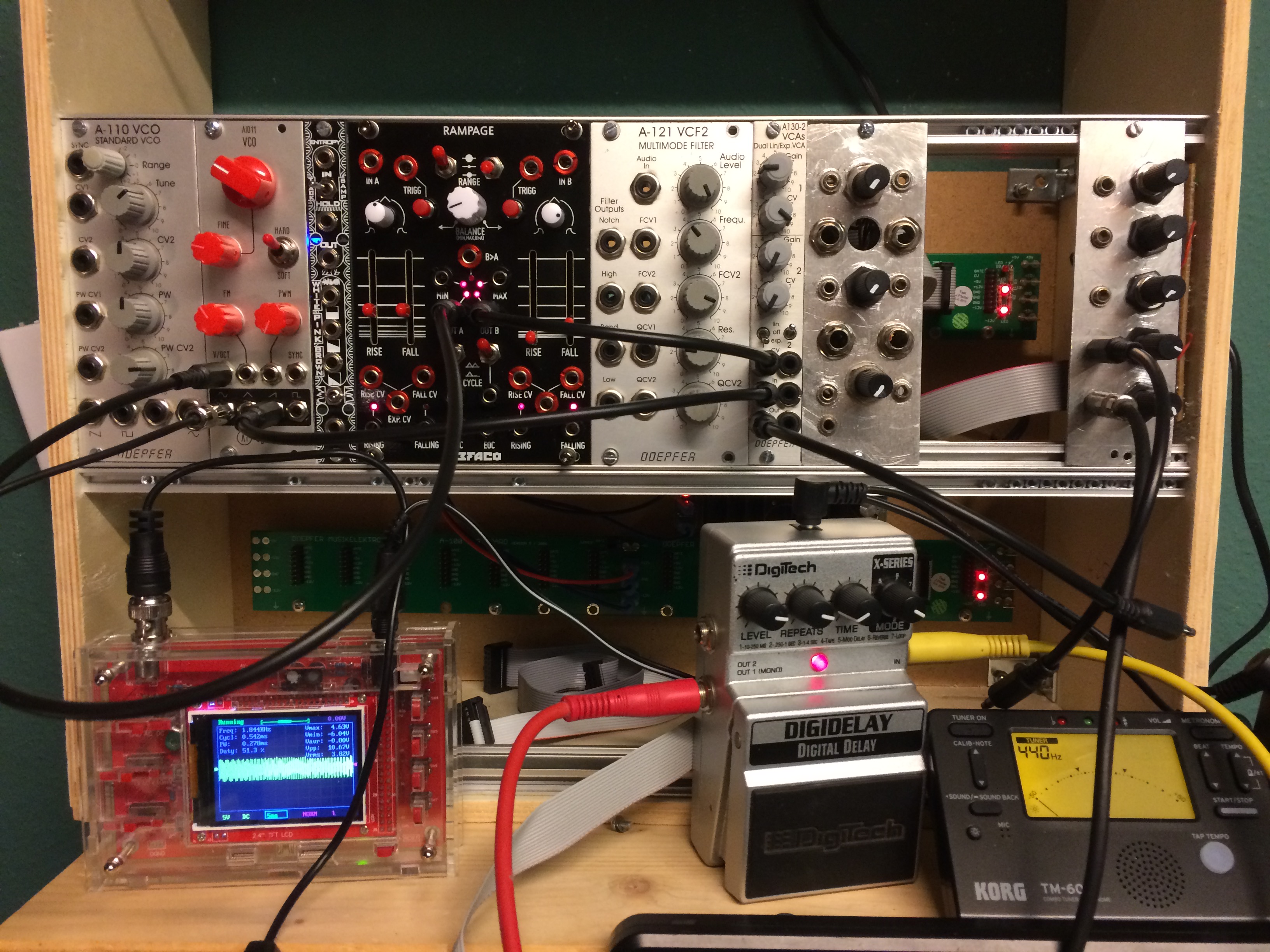

I have started a modular once again. This time it's mostly gonna be Kits and modules from scratch since I finally feel adequately skilled and equiped to go that way. My builds from scratch are a dual guitar pedal interface/ eurorack-level-amp (based on Ken Stone's design) - attenuverter (fonik's) - 440Hz Oscillator (non functional, based on TL07x datasheet schem) - module and that audio mixer (one channel doesn't work but I really can't get whats going wrong, three channels are sufficient for the moment anyway...). Making panels without a proper saw is kind of tricky but I'm getting better with every cut of my jigsaw...hehe. Another successful build is a 555 based Dub Siren for my brother for christmas. Thats as from scratch as it can get - even made the case (also just getting into woodworking...).
Everything except the Doepfers is DIY - some from Kits (thonk) and some from scratch (the obvious ones).

nice work. I've used a jigsaw too to cut panels to size but usually cut them slightly larger. Then clamp it between 2 pieces of angled aluminium
and use a file to get it straight and to the correct size.

Thanks! Yeah, I've also got myself a set of files of all shapes and sizes (metal files) and funnily I also started clamping them in as you described. I have one of those universal saw/drill/work benches making it easy clamping in. One of my next pieces will probably be one of you LFOs, btw Wink

we might have the same kind of workbench and I also have that same oscilloscope.
If it's an LFO with opamps keep an eye on the inv/noninv inputs, I switched those up in at least one schematic.
