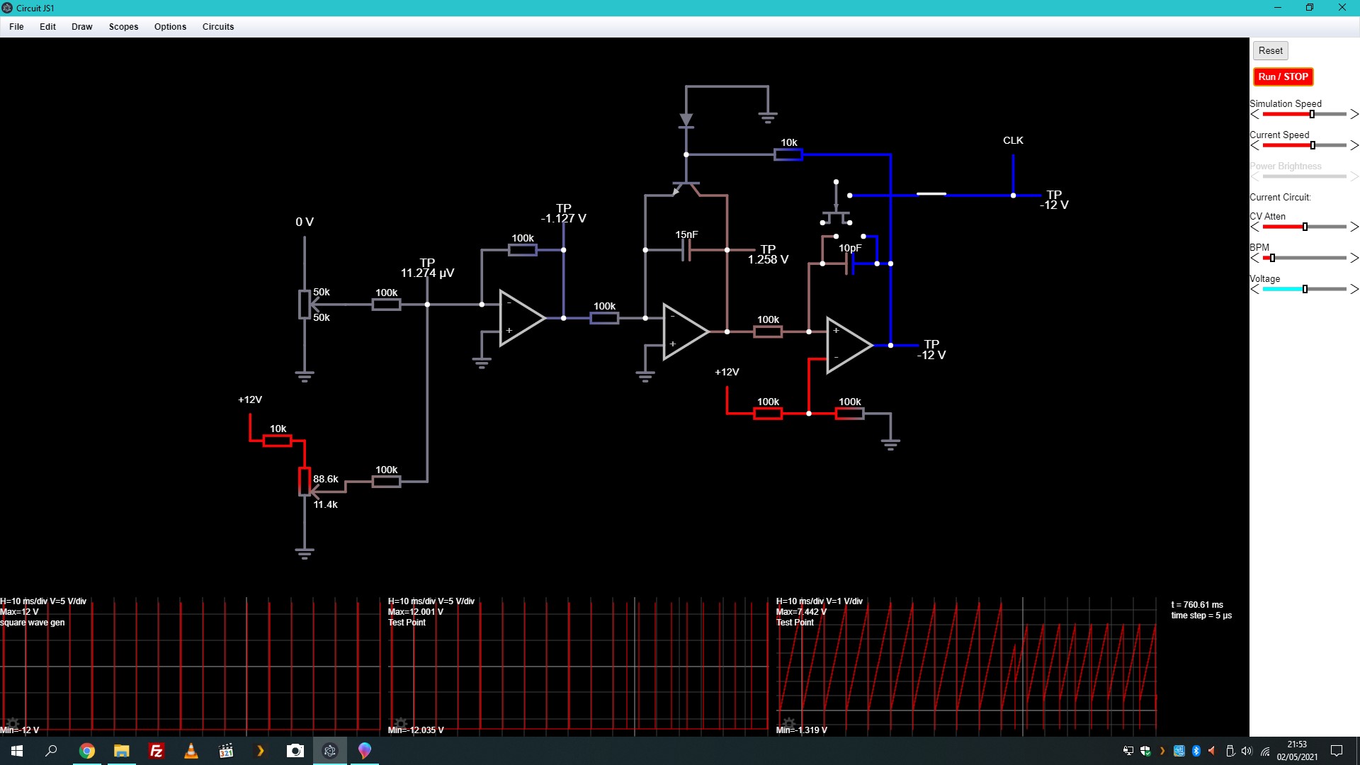

i am trying to figure out a way to create a clock signal which can be controlled using potentiometers and external voltages and can also be reset asynchronously so that i can keep multiple clocks in time with each other using a trigger at the start of each bar.
I've looked at 555 Timer IC's and have managed all of that except the reset part. Does anyone have an idea for how to go about this? Either with 555 Timers or some other method?
My brain is about to explode trying to understand the 555 timer and i'm getting really frustrated.
I've added an image and Falstad File of my current 555 Timer setup which works well, except for resetting.
NM
p.s. i guess i need an oscillator which can be adjusted by pots, control voltages and has a sync function like hard sync and is linear not exponential

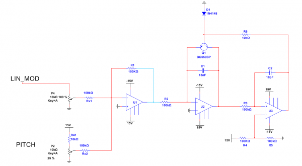

may this could be a starting point?
edit: pic updated, the transistor was wrong orientated

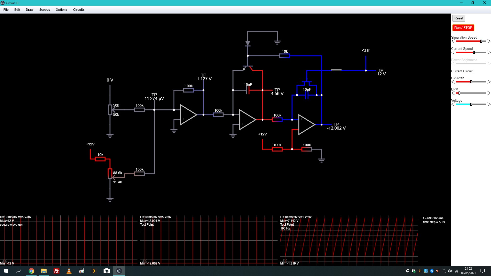

I've simulated it and it works well. The only problem i'm having is implementing a reset function. I'm shorting the 10pf cap using a JFET but that stops the regular pulses coming from U3 from working properly.
The pulses are -12V to 12V on the JFETs base(???) leg. Not sure what that leg is called on a JFET.
Any ideas?
NM

How I see things ...
For a reset you should short C1, and as as Q1 already does that peridically for the 'regular' reset .. it should be sufficient to make the base of Q1 forced high for a short! time.
This should 'override' the regular reset from U3, so maybe a (left pointing) diode in series with R6 and then an extra diode and resistor where you put in the (short) reset pulse?
The pulse must be short, as oscillation will be inhibited for the duration of the reset signal. But it must not be too short, as otherwise the capacitor will not be discharged completely. You may want some differentiating RC thingy to make a short pulse with a defined length there, and then fiddle a bit with the RC time.
The 'base' of a FET is called the gate.
C2 (the 10pF one) is just making the regular reset from U3 a bit faster.

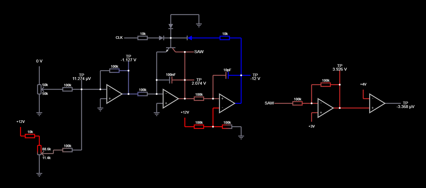

i've tried that out and it seems to work ok. I can shorten the pulse like you said with an RC setup. Something like a clock to trigger converter does.
Excellent. I've been mashing my brain trying to figure this out. It's gonna be a long time before i'm even slightly competent with this stuff.
Your idea defo helped me get in the right direction, so thanks BH.
I inverted the sawtooth with some offset and used a comparator on it to get a nice clock pulse from it.
NM

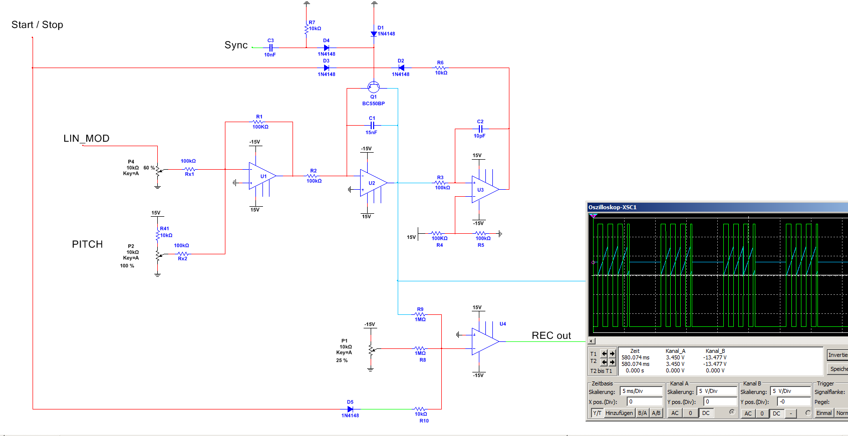

uh, ah
things are going fast these days Shocked
i dunno if the idea wiht all the diodes on the transistor base will work, but i like how it looks, and my simulator also says it works.
i included an idea for the start/stop input, and seperate reset input, the simulator says again it works Very Happy
do you can breadboard? iam exepted from any hardware otherwise i would do it myself
a guessing:
100nf as integration cap could be a bit high in reality, because it could be that the reset time (determinated by the 10pF cap) could be to short to discharge a fully loaded 100nf Cap, i have in memory that if putted a 15nF in.
same time i was using a 10Mohm resistor as integration resistor (R2), i guess that way i was reaching like 3 seconds or so.
are you planing to have the pulse width modulated?
cheers, looking forward to hear about your progress

the start-stop-gate-low-function could be implemented as shown.
for low frequencys u should consider for R2 a high-value resistor 1M up to 10M.
