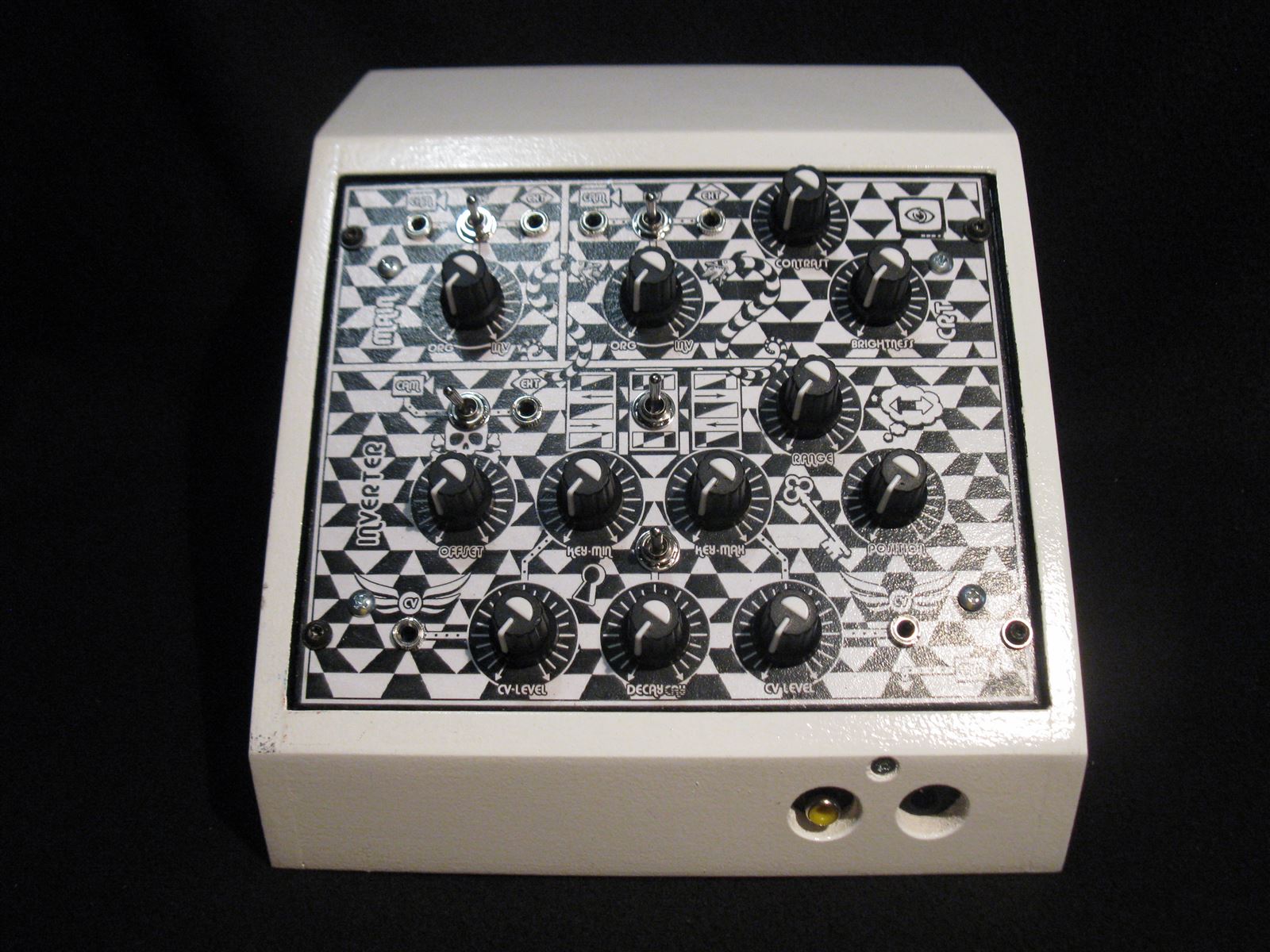

And another project finished, a Video Inverter (inverts chroma and luma).

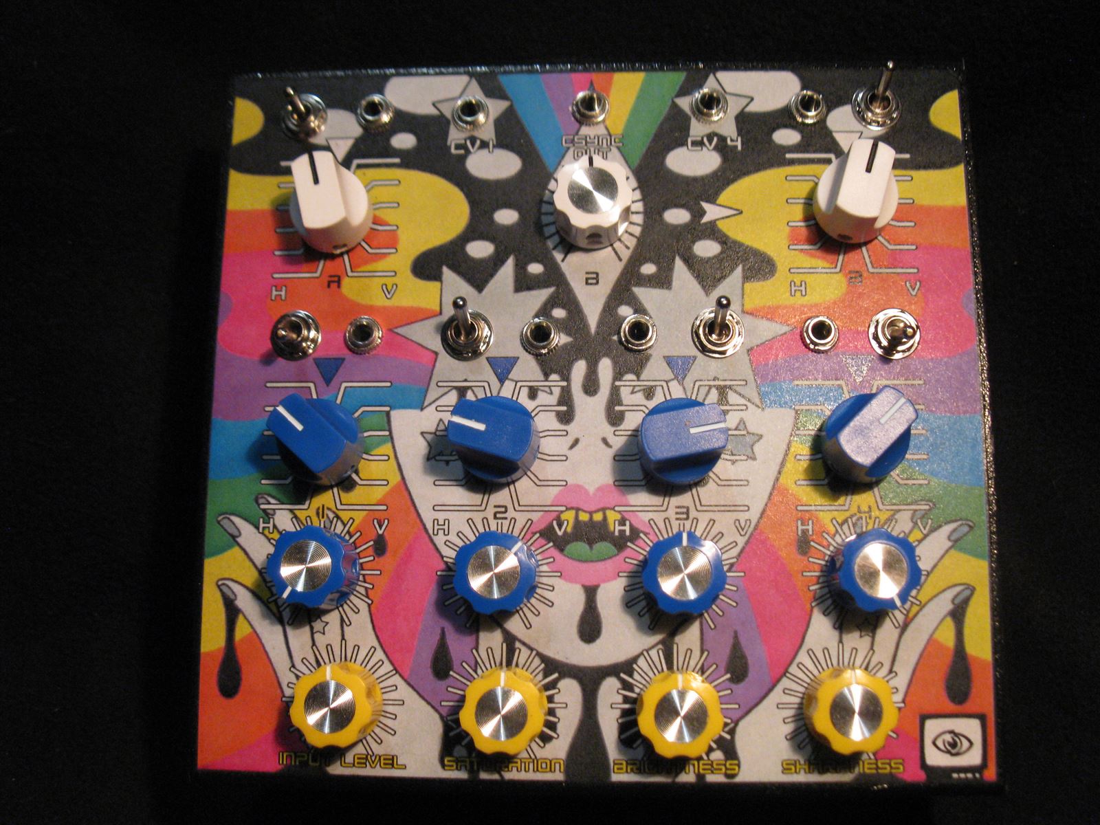

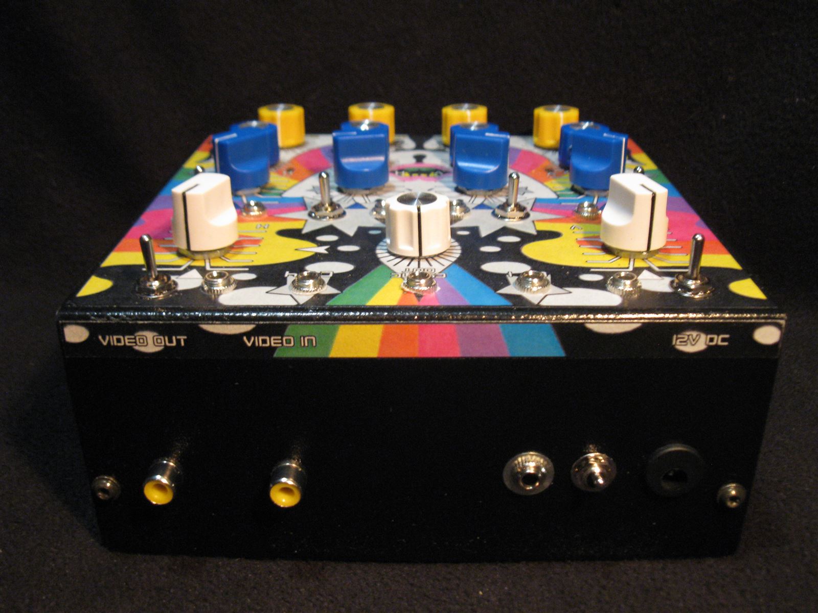

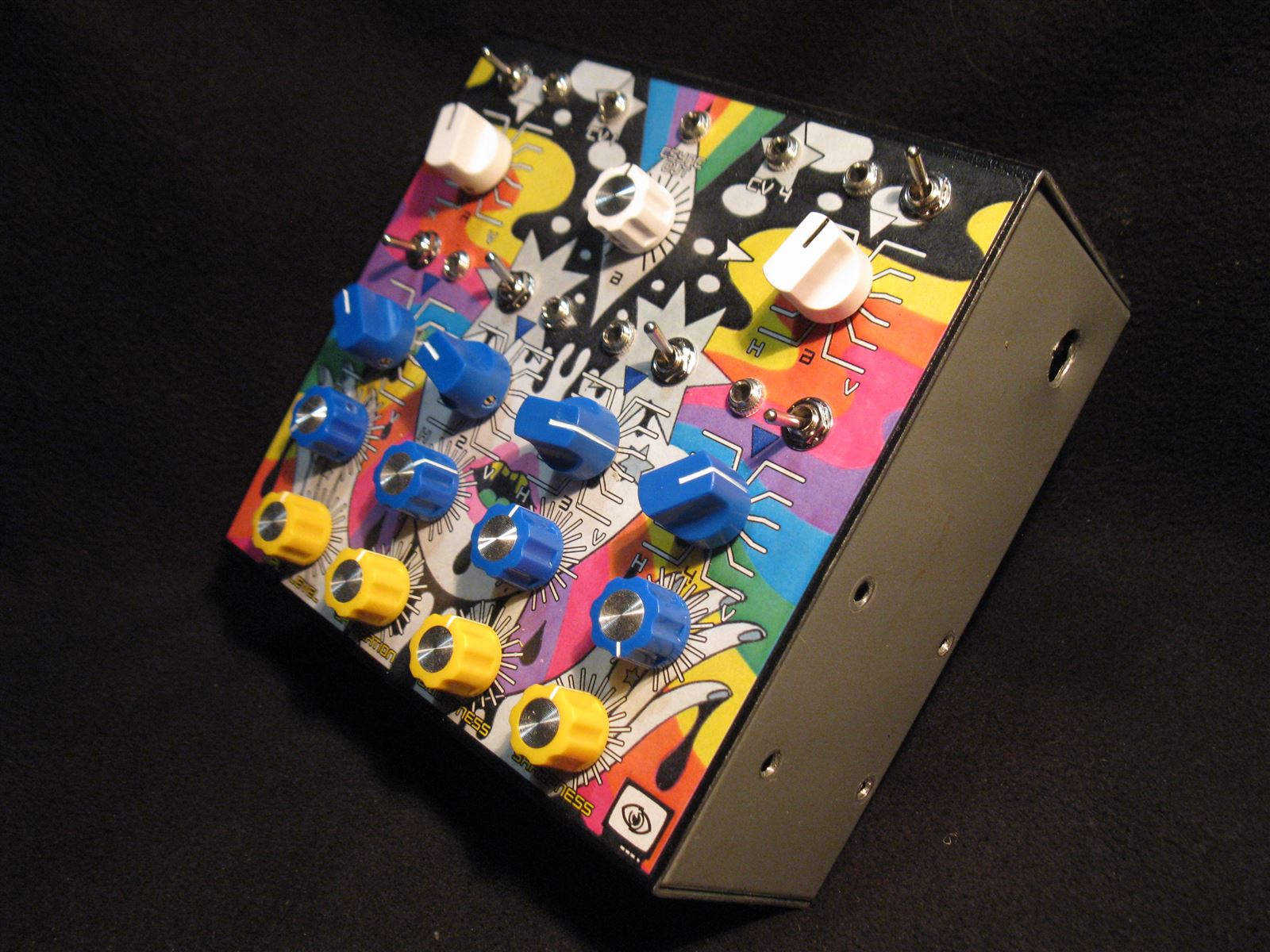

The Phosterizer. a video posterizer effect which is a modified version of an Elektor Magazine video effect generator (June 1983 issue).
The enclosure used to be a bench power supply, hence the holes in the sides. I was thinking of covering it up with some wood but
I don't think it's worth wasting material and time on, it would just make it more bulky. Maybe I'll glue some thin black cardboard or
plastic on it. Connector and switch on the backside are a last minute addition so not labeled. Haven't been able to record it properly
as capturing and encoding makes it all kinds of blurry but you can find some earlier tests here and here.

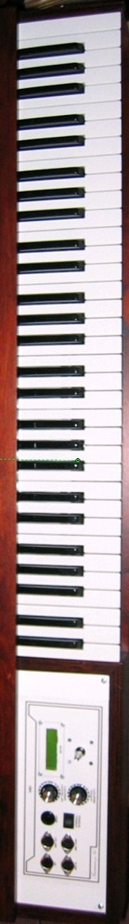

Wind controller.
A pressure sensor is read with a BluePill STM32, programmed with the Arduino IDE.
The waveform of the pressure is displayed on an Oled display.
the output is from a multiplying DAC, so with a potmeter I can set the amplitude, while with the rotary encoder I can set the offset, and by pressing the switch of the encoder, the output of the pressure sensor (I2C controlled) is calibrated to 0 volt out.
Also a gate is implemented, when pressure is applied, the gate goes HIGH, and goes LOW again when there is no more pressure measured.
