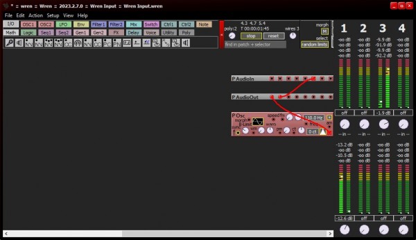

Hello @BlueHell and everyone else.
I tried my best to make external audio input work but I can’t get it done. Is it possible or am I missing something here?
Input itself is working as I can see the level meter inside Wren, but I cannot get a connection to actually hear anything. I tried patching the input module directly into the output module but even then… nothing happens.
What can I do and how can I solve this?
Thanks a lot for your hard work programming all this, it is so amazing.
Edit: I of course did assign the ASIO driver‘s in- and outputs to each in- and output to the individual ones in the menu. I use a Focusrite Scarlett and I use their ASIO. Even if I change the order nothing happens. What I forgot to tell is that the program crashes as soon as I start the audio test. Happens with any configuration and driver. But as I can hear the patches I thought that might be a tiny bug not too important for working inside the synth. Smile

PostPosted: Sun Feb 05, 2023 4:17 pm    Post subject: Reply with quote  Mark this post and the followings unread
Cheers Smile
First of all: Thanks for your reply to that absolutely noob-question.
Indeed as soon as I press "run" the input-meter shows that there is input on channel x (in my case input channel is 6, it wont work on 5 either.)
I took a screenshot, I hope it speaks for itself. I can hear the oscillator on channel 1 but i cannot hear any input audio from channel x (6) on output 1 or 2 as it is patched.

Posts: 24676
PostPosted: Sun Feb 05, 2023 5:39 pm    Post subject: Reply with quote  Mark this post and the followings unread
Octave-Shift wrote:
I feel dumb and a bit lost here Embarassed
Don't - you may just have found a bug Shocked .. will look into it soon.
Posts: 24676
PostPosted: Mon Feb 06, 2023 5:12 pm    Post subject: Reply with quote  Mark this post and the followings unread
Yup, after looking I can confirm that audio in is not working properly ... trying to find a reason ...

Posts: 24676
PostPosted: Tue Feb 07, 2023 10:00 am    Post subject: Reply with quote  Mark this post and the followings unread
Sorry for the confusion that I caused ... that module should work okay of course .. and I apparently had never used it yet .. or properly tested it.
Thanks for reporting it Cool
Anyway, the init code for input modules made them point to wrong (unitialized) locations fo picking up audio data (due to there being an address of a pointer instead of the pointer itself - I'm not good at mult level indirections).
I think i fixed it and I've made and published a new release (2013.2.7.0) which you should be able to obtain from within Wren itself (menu: Help / Full update ...).
And if not ... see the blog : https://bluehell.nl/blogje/ or the Wiki : https://bluehell.nl/wren/wiki/doku.php?id=download for more info on downloading and installation.
Hope this will work for you!

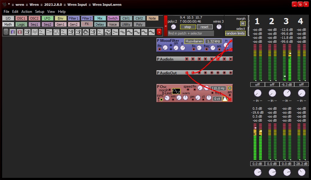

After installing the full update (thanky for even revisioning without any delay at all - you really don't have to do that so quick btw) I tried to open the patch I took the screenshot of and I can say it works - partially.
Here's what I encountered: Directly after initial reopening and hitting run it works but as soon as I repatch the input cable (or add another module) it suddenly won't anymore. Even if I reconnect it to the same output again there won't be any sound at all. All I can do is completely reopen the pre-saved patch.
I provided you two more screenshots (I only shrunk the screen width for the shot)
PS: One single time I could (somehow) manage to make the oscillator go nuts, sine being way too low in volume, saw being too high and square running even at a different frequency drunken

PostPosted: Wed Feb 08, 2023 7:40 am    Post subject:
Subject description: another bug fix - 2023.2.8.0
Just made another new release (2023.2.8.0) to fix the rewiring issue.
These were artifacts intruduced the new (a tiny bit more efficient) way of signal propagation in patches that i did a while ago.
It used to be that all modules needed a fixup after the patch changed ... forgot that such is still needed for the input modules in a patch and that such is also needed after rewiring and not just after module addition / removal.
As to the oscillator going soft : with a voice count greater than one this can happen as the oscillator phase is random and the different voice signals will be summed before sent to a physical output.
When the phase difference happens to be 180 degrees there will be no output at all.
With a little random modulation of the phase or frequency of the oscillator this will be gone (and it will make the sound more lively too Cool ).
For the saw and square remarks, as well as for the non-crashing of audio testing : I have no idea what could cause that or how i could try to reproduce the issues (I do not have proper ASIO anymore since my RME interface broke down, using a cheap Behringer thingie for now).

PostPosted: Wed Feb 08, 2023 2:22 pm    Post subject: Reply with quote  Mark this post and the followings unread
Just see the screenshot Wink Very Happy
love cheers
Great work, now it's doing what it should. Respect and a HUGE Thank You.
One thing I noticed. though (hope you're not going mad at me, but all I want do do is help this great masterpiece of work to even more improve) is, as soon as I insert or even start to drag a module into the main window, the sound of the internal oscillator changes even before I drop it.
As you can see, the chosen waveform is a sine, it then changes to a (didn't watch it through an oscilloscope, yet) mixture between (as I identify it by ear) saw and square immediately, still showing the chosen sine in the window, and so it does change a little bit any time I add another module, not even by wiring, but by their pure existence. Seems it changes the amount of harmonics (?) (Out-of-phase shouldn't be the case, then?)

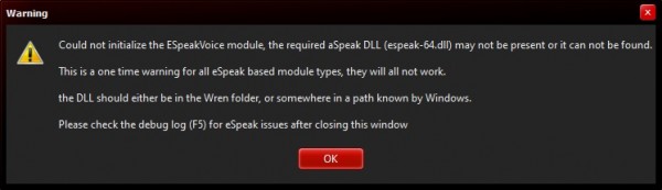

Can you help me out with two things?
I got a message that I'll need the eSpeak.dll (when using the eSpeak module) and another rp8*something*.dll (when I accidentally inserted the Mono Convolver module Shocked Where can I get these dlls?

Posts: 24676
PostPosted: Thu Feb 09, 2023 5:15 pm    Post subject: Reply with quote  Mark this post and the followings unread
The DLL's should be in the folder where Wren.exe got installed. If this is not the case or when that did not work ... you can manually download this zip file and extract the DLL's from it. When they are already in the Wren folder there is no need to do a download.
However, And! In order to use ESpeak it must be downloaded and installed apart from the DLL that is in the Wren distribution - there is a link to ESpeak on https://bluehell.nl/wren/wiki/doku.php?id=installation&s[]=espeak .. when that does not work .. try google Smile
I'm getting these issues too, not just with eSpeak but with libfftw3-64.dll as well. The files are DEFINITELY in the Wren folder but for some reason Wren itself is acting like they're not there.

IMLXH wrote:
Octave-Shift wrote:
I got a message that I'll need the eSpeak.dll (when using the eSpeak module) and another rp8*something*.dll (when I accidentally inserted the Mono Convolver module :shock: Where can I get these dlls?
What helped someone with this a little while ago was to add the Wren exe folder to the path.

PostPosted: Fri Dec 29, 2023 12:32 pm    Post subject: Reply with quote  Mark this post and the followings unread
Setting the path was reported (in the chat room) to have worked again .. for how to set the windows path variable see : https://helpdeskgeek.com/windows-10/add-windows-path-environment-variable/ .. for instance Wink
