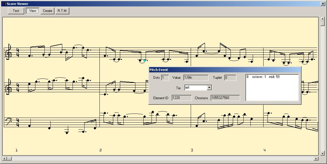

Some clarification.
The composition engine does what I would call notational computation, by which I mean that in creating score it uses data objects that directly map to the visual score. As a consequence, when it comes to notes, notation is the only input type contemplated at this time, i.e. no midi input. (I’m not against it, just not willing to spend the necessary time to do it myself.) As the design stands, rhythms may be represented in one of two ways illustrated in the drawing. Assuming an unslugish pace we have at the first bar line big-time anticipation modeled as tied pentuplets. The blue brace straddling the second bar line represents a rhythm abstraction. Aurally the same thing happens at both places.
Technical definition wrote:
The length of a note is modeled several different ways, one of which, called the relative representation, is a pair of floating point numbers: the first is a (unit normalized) percentage of its notated length, the second a (unit normalized) percentage of its length used as a starting time offset. Thus a value pair (1.0, 0.0) would leave a performed note unchanged from its notated length and time of occurrence.
The rhythm abstraction is partly a template that provides a list of note length objects and their relative representations. So, for example, the brace ‘r’ rhythm in the drawing must encode for its last note the relative representation pair (1.2, .2) to meet the condition that aurally the same thing happens here and at the previous bar line. (There are more dimensions to the rhythm abstraction than these, however.)
So generally does that sound like a broad enough a definition of rhythm? Or if it chafes, how so?

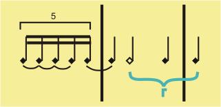

‘nother aspect of rhythm
Time is modeled as part of the “natural” tree structure of the composition. The span nodes of which this tree is composed have natural children as well as several types of “adopted” children. Adopted child spans have a length that is the same as their parent and have no inherent right to change their length. But they can freely decompose into sub spans of arbitrary length* that could eventually decompose into measures different in number, tempo, and meter from those of the natural tree. The only restriction being that the adopted span’s series of measures begin and end synchronously with its adoptive parent. At this point adopted spans are “provided for” (have a minimal interface to stubs) but have no implementation. Though that is in the very near future.
That it would be a relatively simple matter to provide adopted spans with measure streams parallel to those of the natural tree only occurred to me in the past couple of days (while thinking about your grooves) and awaits some distant future time to have design work done--sigh. In the mean time I will try not to make that implementation more difficult than needs be.
*Though the sum of all sub-span lengths must equal that of their parent span. This is true of all children (sub-spans) of all spans.

PostPosted: Tue Oct 11, 2005 1:00 am    Post subject: Reply with quote  Mark this post and the followings unread
It's fine anyway, Since note-length is proportional to the bar length anyway having a starting offset proportional to the note-length will inherently also be proportional to the length if a bar.
Sanity checking might be harder this way though.
Imagine we have a passage in 4/4 where we just had a phrase which devides that into two half notes. In some musical movement this now changes to a halfnote followed straight (in notation) by a 32nd stab.
If we asume that first part was just played with quite a bit of shuffle and the second halfnote was quite "late" compared to where it's notated and we want to preserve that suffle then the 32nd note in the second massage might conceivable be "late" by more then a 32nd note duration. I'm not too woried by 32nd notes being offset by a relative factor of "1" and possibly slightly more but I think once we start having halfnotes with such offsets then it sarts to become a bit silly.
I'm pointing this out because I have a Roland PMA-5 lieing around here which does something similar. It's a small pocket sequencer where once uou place a note on the bar then you can change it's settings, including offset. This can lead to confusing and silly sitations because the PMA isn't smart enough to realise at what stage it's be more apropriate to move the notated note tot eh next position and reset it's offset to "0". I think the PMA expresses offset in midi clock ticks so that sort of amounts to the same thing too.
Starting offsets should be relative to the "ideal" or "notated" length imho, not to the actual offset one. I agree that the amount of data stays the same but once we need to recalculate some of it some of the time based on floats then we should minimise the amount of recalculations done in a series or projects that are worked on for a long time with lots of edits will start to slowly suffer from rounding errors creeping up. Those would be a serious problem that would be hard to correct later.
Asuming we'll have sanity checks and the program will do it's math properly then I have no problem with swaping representations about as long as the informations stays constant.
