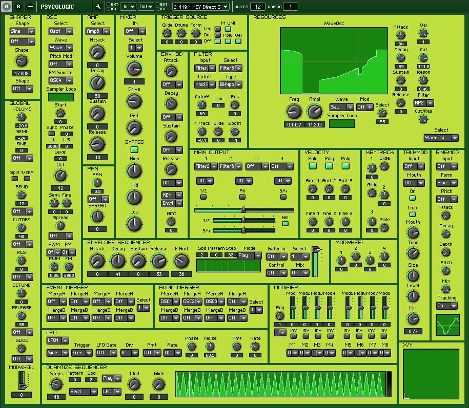

my opinion is that i can easier use distortion without maxing out in reaktor, tough i haven't made all posible routings on the nord modular g2 yet. I noticed that the nord envelopes are more sharp and very natural. the filters also have a different but more "crispy sound" as the nord makers say.
I've created a modular synth in reaktor wich has an overal usage of 30% cpu on 48khz with a dualcore amd. on 96khz it can rise to 70% so thats what makes reaktor a thumb down.
furthermore you will encounter lots of problems in reaktor with sequencer routings, mono and polyfonic routings, and specific routing orders wich work best or not at all in the trigger sections. Also mathemetic modules makes things more difficult but also more realistic. I haven't got the brains to create Core modules but that way you maybe might safe cpu or just comsume even more. I fixed all problems myself in the psycologic wich occured with complex routing. There was nothing to be found on the native instruments website wich could help me solve this unless i shared this instrument. And that was not exactly my plan after a year of work.
I have some preset preview demo's Smile
these are from the early beta stage, the new preset demo's are yet to be made.
I think reaktor has a lot of advantage but also disadvantage, thats why both really is something to combine Very Happy
The interface (no time for photoshop yet)

i've created a spec list. to give a view of its power.
(modulation index routing and audio index routing can be found below)
SPECS:
OSC 1
Saw
Bi-Saw
Tri
Par
Sine
Pulse
Bi-Pulse
Noise
Random
Sampler
Input
Wave
Pitch Mod (Route Osc pitch to the Modulation Index)
FM Source (Route an audio signal according to the Audio Routing Index to the FM input)
Sampler: Can be used with loop functions if turned on in the reaktor sampler settings,
has start position control, Loop Start, Loop Length.
Volume Control, Octave, Semi, Fine, Unison Spread (-12/+12, can be routed to the Modulation Index) PWM and FM can
also be routed to the Modulation Index
OSC 2, 3 and 4 holds the same functions except "Wave"
4x AMP ENVELOPE ADSR
each with clock synced delay
4x MiXER
Sat Distortion and lo, mid, hi EQ
4x ANALOG ENV MOD
ADSR can be modulated (modulation index can be found below). Single Trigger function, route ENVELOPE SEQUENCER out
to analog envelope in.
2x MOD ENV POINT STEP ENVELOPE
Can set multiple envelope points. Can be synced to internal BPM or DAW Master Clock BPM. And also route ENVELOPE
SEQUENCER out to the Point step envelope input.
2x ENVELOPE SEQUENCER
ADSR SEQ event control, Speed, 64 Patterns, Stepsize, Triggermode: Play/1step/Gate
Has 1 Audio input (according to the Audio Routing Index) and Mix control can be routed to the Modulation Index.
Control can be set to Gate or OFF.
Can be used as event or audio for stutter and gate fx and can trigger sequence steps to the Analog and Pointstep
Envelopes.
4x FILTER
12DB HP
12DB BP
12DB LP
Notch
24DB HP
24DB BH
24DB BP
24DB BL
24DB LP
Peak EQ
Comb
SATLP
ANALOG LP
Mix, Keytracking, Glide.
Cutoff can be routed to the Modulation index.
Each filter has 1 Audio input (Routing according to the Audio Routing Index)
SHAPER
Sine
Soft
Hard
Virus
XP1
XP2
XP3
XP4
XP5
Shape amount can be routed to the Modulation Index.
Has 1 Audio input (Routing according to the Audio Routing Index)
GLOBAL
Volume
Semi
Fine
Pitch can be routed to the Modulation Index
Split, Exclude OUTPUT 1/2
Bend Range (can also be routed to the Modulation Index)
Cutoff (controls all filter cutoff, can also be routed to the Modulation Index)
Resonance (controls all filter res, can also be routed to the Modulation Index)
Detune (controles unison de tune -1/+1)
Release (controles all envelope release except for the pointstep envelope, can also be routed to the Modulation
Index)
Glide (controles overal glide on filter and pitch, can be routed to the Modulation Index)
Modwheel (sends cc01, or can be used in the modulation index)
2x QUANTIZE SEQUENCER
64 Steps, Stepsize, 64 Patterns, Speed, Play/1shot/Gate mode, Mod amount control, Glide.
4x LFO
Sine
Triangle
Square
Saw
Random
Noise
Phase Control
Noize Control
Trigger: Free/Gate/Midi/Song
Amt can be routed to the Modulation Index
Rate can be routed to the Modulation Index
8x EVENT MERGER
Each event merger holds 4 sources to one destination. (As found in the Modulation Index)
4x AUDIO MERGER
Eacht audio merger holds 4 sources to one destination. (As found in the Audio Routing Index)
MODIFIER
The modifier has 8 Mod faders. Fader 1 to 4 have bipolar values from -64/+64 and Fader 5 to 8 have bipolar values
from -1/+1
You can select each faders range with the range combo box. The Range rotary divides the selected modifier input and
the faders apply the offset.
(every fader act's as a signal bridge and must be routed further according to the Modulation routing Index)
PAN
Control Pan from left to right. (can be used according to the Modulation routing Index)
Control the Unison Pan Spread.
3x VELOCITY
Can be used with the Modulation routing Index.
Can be set to Poly or Mono.
Control Amt and fine amt.
3x KEYTRACKING
Control Keytrack value.
Control Glide.
4x MODWHEEL
Can be used with the Modulation routing index.
Adjust modwheel range with each rotary.
TALKMOD
Input (according to the Audio routing Index)
Mouth control (can be routed to the Modulation index)
Compress switch
Tone Control
Size Control
Level Control
Mix Control
RINGMOD
Waveform Select
Pitch Mod can be routed to the Modulation Index
AD Control
Depth Control
Pitch Control
Mix Control
Key Tracking Switch
Wave Draw
X/Y
Can be used with the Modulatioin routing Index.
MAIN OUTPUT
Has 4 Outputs
Crossfade osc 1/2
Crossfade osc 3/4
Crossfade osc 1&2/osc 3&4
Route crossfade mixfunctions to the Modulation Index.
Kill function to disable crossfader and directly send outputs to the Mono FX section and safe some cpu.
*RESOURCES* (This section contains most FX to reduce the interface size)
Select box contains:
MoD Env A (see above Point step envelope)
Mod Env B (see above Point step envelope)
Distortion (5 Bands Distortion FX)
Dynamic Sweep (Ownmade Experimental Sweep and Detune FX)
Arpegiator (Powerfull note, groove, event sequencer)
Diffuser Chorus (FX)
Fattener (FX)
Flanger (FX)
Phaser (FX)
Pitch Shifter (FX)
Stereo Filter (FX)
Chorus (FX)
Grainer (FX)
LoFi (FX)
Reverb (FX)
Gate (FX)
Sync Delay (FX)
Equalizer (FX)
Feedback Pitcher (FX)
Pitch Formula (Modulation FX)
Phase Shifter (FX)
Snapshot (preset control for morphing)
Aftertouch (Modulation routing Index)
Wave Osc (OSC 1 Wave OSC)
***** MODULATION ROUTING INDEX *****
Analog Env1
Analog Env2
Analog Env3
Analog Env4
Mod Env A (Point step)
Mod Env B (Point step)
Quantize Seq 1
Quantize Seq 2
EnvSeq 1
EnvSeq 2
X-Axis
Y-Axis
XY Press
Event Merger A
Event Merger B
Event Merger C
Event Merger D
Event Merger E
Event Merger F
Event Merger G
Event Merger H
KeyTrack 1
KeyTrack 2
Keytrack 3
ModW 1
ModW 2
ModW 3
ModW 4
Vel 1
Vel 2
Vel 3
Modify 1
Modify 2
Modify 3
Modify 4
Modify 5
Modify 6
Modify 7
Modify 8
Gate
LFO 1
LFO 2
LFO 3
LFO 4
ARP Event
On
Pitch Ladder 1
Pitch Ladder 2
Aftertouch 1
Aftertouch 2
Aftertouch 3
Aftertouch 4
*****AUDIO ROUTING INDEX*****
OSC 1
OSC 2
OSC 3
OSC 4
Filter 1
Filter 2
Filter 3
Filter 4
Mixer 1
Mixer 2
Mixer 3
Mixer 4
Audio Merger A
Audio Merger B
Audio Merger C
Audio Merger D
Ringmod
Shaper
Talkmod
EnvSeq 1
EnvSeq 2

wow!
That's a fantastic synth you put together in Reaktor. The demos show a lot of capabilities and a very large range of sounds.
Good job. thumb up

tnx Smile Ill defo make some new preset demo's today couse the latest version i made had affected a lot of snapshots and i had to rebuild 127 new presets. There seems to be a lot of interrest, i dont think this is a topic to promote for selling :p but you can pm me for that.
So i hope you can hear the difference with reaktor and nord, couse in some points of view my nord g2 still lacks dsp processing.. I need a Expansion for the g2 but it's hard to find here in holland.. Tell me if anyone has a spare one pls!
At the moment this synth is best viewed on a 1280x1024 resolution.
