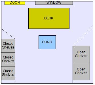

My entire room is non-symmetrical, with double-walled structure, carpeted wall-to-wall and ceiling to floor, then covered with acoustic material. photo here--

Do you have a floorplan .. measurements in meters?
How thick is that foam stuff? How high is the ceiling?

Trivia: A full foam clad room is rarely ideal. The foam will dampen the highs and mids. Adding some reflective surfaces behind you, possibly a hard diffusor.. and possible some sheets of paper or whatever around you might imrpove things a bit. Still bass problems will not be "solved" by the foam. Real basstraps might still be needed. There is rarely such a thing as too many bass traps. You can make such yourself. Basically these are panels. I will find some links for you later on. I am making a new set of such for my own studio right now too.
The drivers used in the Madison Studiio Monitors are quite good. Decent specs and they seem to be far far better than what you would find in Behringer and similar low end studio monitors.
The room is quite small, isn´t it?

I don't depend on the foam for low end damping. The shape of the room does that -- on each side of the room, there's odd shaped shelves that prevent standing waves, and the window is a double pane with an inverse "V" shape, which also prevents standing waves with the rear wall. The door is a double door (can't see the other that opens out in that pic), and when closed, I can hear my heart beating. In fact, even with the door open I can't hear my door bell ring upstairs (studio is in a basement).
No dimensions yet, but here's the basics (~4mx4.5m):
