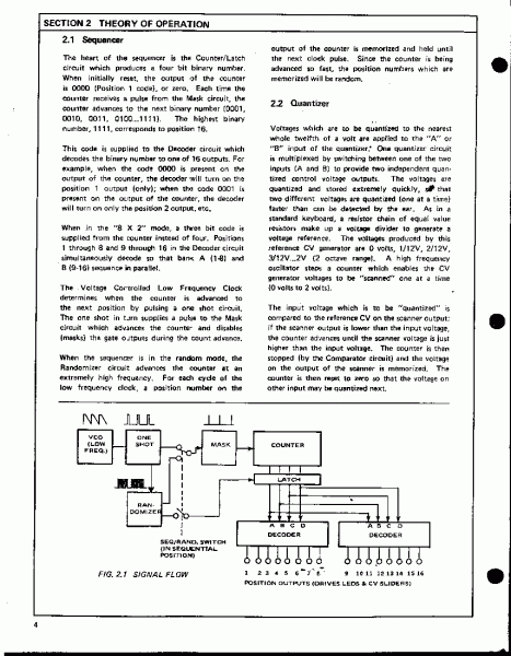

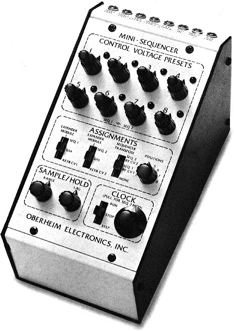

hey i suggest looking at the oberheim mini-sequencer schematic, it does use an r-2-r ladder with a counter, but, of course, you can sub any DAC for it. an 8bit is supercheap nowadays, not like back then..
this is the one i am planning to build, it's very simple. the polyfusion one is simple too.. i always forget where i get what schematic???

PostPosted: Tue Sep 05, 2006 2:31 pm    Post subject: Reply with quote  Mark this post and the followings unread
off the library...
thats the one.. the whole sequencer looks great huh? you know, ever since i got the schematics for the SEM and the 2/4 voice controllers, i have been thinking bout making one... some real good circuits in there least ways....
here is a link.
http://homepage.mac.com/ersatzplanet/Pages/ObiePages.html
lotsa goodstuff..
