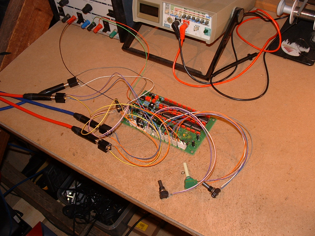

PostPosted: Sun Jan 20, 2008 3:24 pm    Post subject: Troubleshooting and calibrating Reply with quote  Mark this post and the followings unread
So I finally got my Tau Pipe put together, and I've found a few things that I can't figure out.
The unit is cleanly passing audio, except...
First, the LFO doesn't seem to work. The Tau will sweep if I hook an external LFO up to it, but not otherwise. Without the external LFO hooked up, if I move the Rate pot, the board will sweep to a new position (slightly), but then settles down and won't move again unless I move the pot.
Second, when hooked up to the external LFO (my MOTM one), when the LFO goes negative in output, the Aux Out on the Tau Pipe goes crazy, while the Main Out doesn't. There's a huge variation in level there, too. This is when set to Phasing, not vibrato.
Lastly, is there a post (or a document somewhere) that describes how we should calibrate this thing for optimum performance, aside from the 1V/Oct calibration?
thanks, y'all.

PostPosted: Mon Jan 21, 2008 3:06 pm    Post subject: Re: Troubleshooting and calibrating Reply with quote  Mark this post and the followings unread
thanks, y'all.
eric
Sounds like two different faults at least.
Have you checked supply voltages at Opamps (+/-15V)?
Any different components than on the BOM?
Checked all solder joints?
JH.

PostPosted: Tue Jan 22, 2008 10:34 am    Post subject: Reply with quote  Mark this post and the followings unread
ericcoleridge wrote:
I had a similar results so far with my Tau Pipe. It passes audio, but no phasing and no LFO. Actually it might be phasing, it sounds like the audio is filtered--but no movement. A couple times when I powered it up initially, it would give a burst of "swoosh", and the LEDs would blink, but then it immediately stops.
I checked the power, cap and chip orientation, etc, but am at a loss. So, I sent it to a friend to take a look at. I probably overlooked something very obvious.
Bingo. That's what I'm seeing here. Nice clean +/-15V, all the controls work, all the jacks accept CV's and do the correct things with them, there's nice strong phasing (boy does it sound good!), but no sweep unless I give it an external LFO or sweep the Pitch pot manually. Or move the Rate pot, but then it settles back down again and doesn't actually keep moving.
jhaible
Joined: May 25, 2007
Posts: 2014
PostPosted: Tue Jan 22, 2008 12:30 pm    Post subject: Reply with quote  Mark this post and the followings unread
Are the two LEDs taking turns in glowing?
Are all the diodes soldered in with the right orientation?
(If D2 in http://www.jhaible.heim.at/tau/jh_tau_sch_page3_control.pdf is reversed, the LFO would oscillate, but with an offset where it would be blocked by D1 ...)
If the LFO does not oscillate, what are the voltages on all 8 pins of U6 (the TL071 closest to the voltage regulators) ?
JH.
eframp
Joined: Sep 11, 2007
Posts: 25
Location: Atlanta, GA
PostPosted: Tue Jan 22, 2008 3:47 pm    Post subject: Reply with quote  Mark this post and the followings unread
On mine, the "Down" LED is stuck on.
The bands match the silkscreening.
1: 0.135
2: 0.006
3: 0
4: -15.11
5: 0.134
6: gnd
7: 14.61
8: 15.14
jhaible
Posts: 2014
PostPosted: Tue Jan 22, 2008 4:05 pm    Post subject: Reply with quote  Mark this post and the followings unread
eframp wrote:
1: 0.135
2: 0.006
3: 0
4: -15.11
5: 0.134
6: gnd
7: 14.61
8: 15.14
That looks like a perfectly valid condition within an ordinary LFO cycle.
Pin 1 should further ramp down, and when it crosses 0V, Pin 7 should jump to -14V, causing pin 1 to ramp up.
Strange that apparently it doesn't.
In that state you described, the center pin of the "Rate" connector should be positive. Is it? (If you turn the Rate potentiometer all the way clockwise, it should be about +14V.)
Another thought: Could C54 be leaking? It should be a 470nF polyester cap - you don't have an electrolytic cap here, no? (Just to be sure.)
JH.

PostPosted: Wed Jan 23, 2008 1:47 am    Post subject: Reply with quote  Mark this post and the followings unread
Is it around +14V when the pot is fully cw?
JH.
eframp
Posts: 25
PostPosted: Wed Jan 23, 2008 8:19 am    Post subject: Reply with quote  Mark this post and the followings unread
JH -
Between center pin and either side is 0V. Between center pin and ground is about 0.006V.
And the cap is indeed a poly, not electrolytic.
Sad
e

And if a picture is worth a thousand words (well, probably closer to 15 words in today's economy)
http://www.ericframpton.com/clients/Phaser%20PCB.jpg

PostPosted: Wed Jan 23, 2008 5:18 pm    Post subject: Reply with quote  Mark this post and the followings unread
eframp wrote:
JH -
Sad
e
All right - I think I have figured it out:
The clockwise end of the pot (red wire in your picture) must have the same voltage as Pin 7 of the TL072. Which also must be the same at the right end of the 12k resistor (near the "LM317" silkscreening).
If it's not the same, you have a broken connection along that way.
Let me know what you find. Broken wire, bad solder joint, or broken copper trace, or bad IC socket.

PostPosted: Thu Jan 24, 2008 2:51 pm    Post subject: Reply with quote  Mark this post and the followings unread
You called it right. Turns out it was the pad of pin 7 that I'd inadvertently pulled off the board from an earlier soldering mistake. Some bus-wire from the pin to the resistor, et voila, oscillation! It seemed so obvious after you pointed it out... <sigh>
Thanks for designing a cool module, and for your extra help getting mine going.
e

funkyfarm
Joined: Jan 21, 2007
Posts: 583
PostPosted: Wed Jan 30, 2008 2:48 am    Post subject: Reply with quote  Mark this post and the followings unread
Spectacular !
but i guess i can hear some clicks when you use an "external CV via a P3 sequencer and a PolyDAC"
Did you try the smooth function ? (or is it another matter ?)
Techman
Joined: Jun 07, 2007
Posts: 9
Location: Barnet, UK
PostPosted: Wed Jan 30, 2008 6:45 am    Post subject: Reply with quote  Mark this post and the followings unread
Hi Funkyfarm,
I guess you're talking about the clicks starting around 1'35" ? It's possible this is just going from one extreme of CV to another. I was just randomly turning the pots on the sequencer. The smooth function was, indeed, off at the time.
I've attached a picture of the board as it was when the recording was made. Note that this versions uses the CA3046 in the array.
Andy
