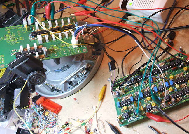

finished finally over the weekend.. working well as expected! thanks for this project. now i gotta make a panel so i can use it...
 Filesize:  433.98 KB
 Viewed:  456 Time(s)

Cool. That's a nice Panavise you've got there. Shocked
I just have to wire the switches. Wish I had time. Sad
