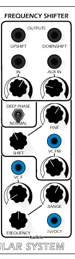

I've been trying to make a new front panel for my Frequency Shifter. I think I've got it kinda correct. Though I'm, as always, confused about how to bundle the range, tune, manual and fine knobs..? Any ideas?
I've got a few more components to go - and then my boards are finished. Hope to get it all up and running before summer!

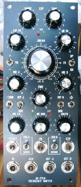

PostPosted: Tue Mar 31, 2009 10:34 am    Post subject: My panel design Reply with quote  Mark this post and the followings unread

PostPosted: Tue Mar 31, 2009 10:39 am    Post subject: Reply with quote  Mark this post and the followings unread
Beautiful!
