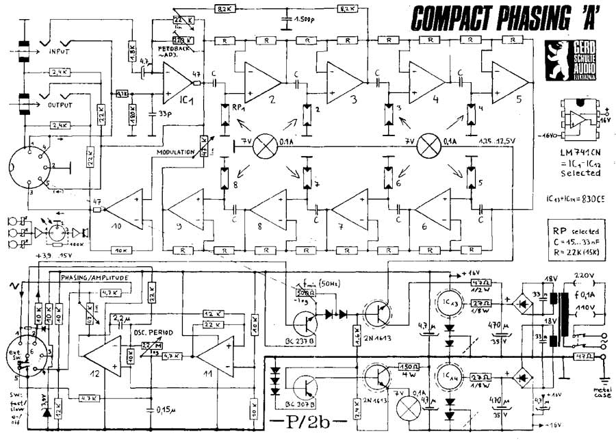

b-funk
Joined: Jul 17, 2007
Posts: 193
Location: Berlin
PostPosted: Tue Nov 17, 2009 11:00 am    Post subject: Reply with quote  Mark this post and the followings unread
Just in case someone is curious how the original Schulte was designed... Wink
PS: I´m back. More soon...
 Filesize:  95.08 KB
 Viewed:  812 Time(s)
