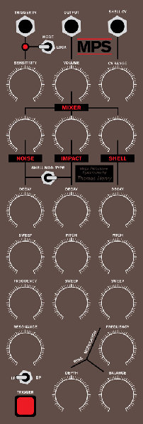

PostPosted: Sun Dec 21, 2008 4:03 pm    Post subject: Status LED? Reply with quote  Mark this post and the followings unread
I've started designing my front panel and I'm working off of other peoples panels, the schematics, and Scott's original post about the front panel controls. I see on schematic 2 a "Status" LED. Is this the same as the trigger LED? Should it be in close proximity to the Impact section of the front panel?
Thanks all!

PostPosted: Sun Dec 21, 2008 9:24 pm    Post subject: Dual Henry MPS Reply with quote  Mark this post and the followings unread
Ok...worked on this tonight. Thoughts?
-dustin

PostPosted: Mon Dec 22, 2008 3:39 am    Post subject: Reply with quote  Mark this post and the followings unread
Hello dustin,
Nice panel. Good choice to have a twin! Much better than a single one. I can confirm this because I just finished to build and test my double mps module (soon I 'll come with a picture). It's GREAT !
It seems you forgot (or you made the choice to leave out) the triggered/locked switch... but it is a great feature for the MPS because it gives infinite decay to all oscillators transforming the MPS in a 4 voice traditional synth.
I also noticed that the resonance pot is in the impact section... this could may be a bit confusing...

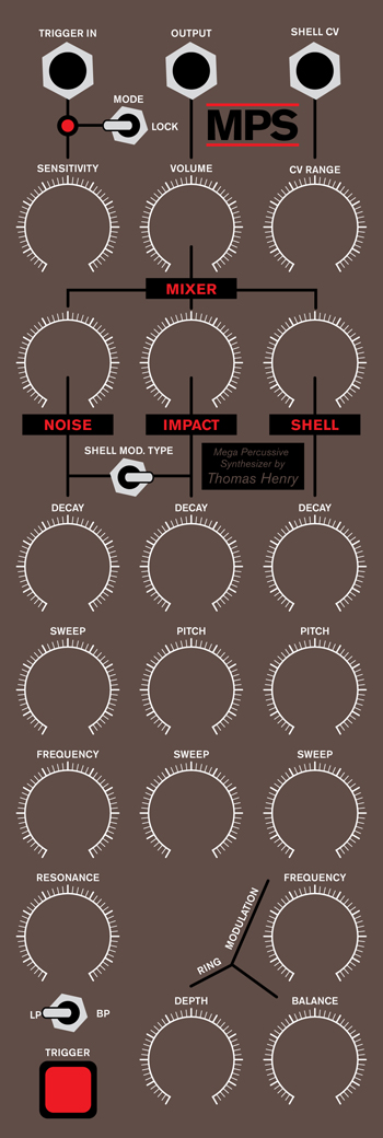

PostPosted: Tue Dec 23, 2008 12:21 pm    Post subject: Reply with quote  Mark this post and the followings unread
tommi:
Thanks for the input! Greatly appreciated, here is a new one with the changes you mentioned. I really like the community response as it helps development.

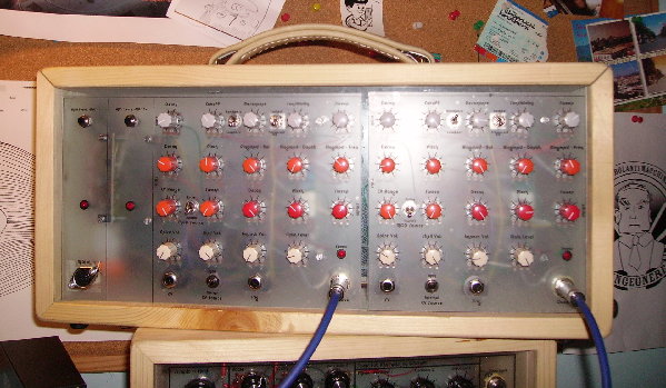

PostPosted: Wed Dec 24, 2008 3:52 am    Post subject: Reply with quote  Mark this post and the followings unread
Happy holydays to everybody.
Here's a picture of my completed MPS.
Cheers, t

PostPosted: Wed Jan 28, 2009 2:21 pm    Post subject: MPS MOTM size PANEL DESIGN
Subject description: Questions about correctness
I'm just starting my build of the MPS and have gone through this thread as best I could (lots to read Shocked ) as well as read some of Scotts site. I would like some feedback on my panel to make sure it's correct Very Happy (I think I have everything in the right place).
Right now I've got everything on there. I also saw Uncle Krunkus's panel with the three CV inputs which is what I would like to do, has anyone come up with a "safe" way to do this?
If anybody sees anything out of place or a mod that I missed please let me know Very Happy Very Happy
