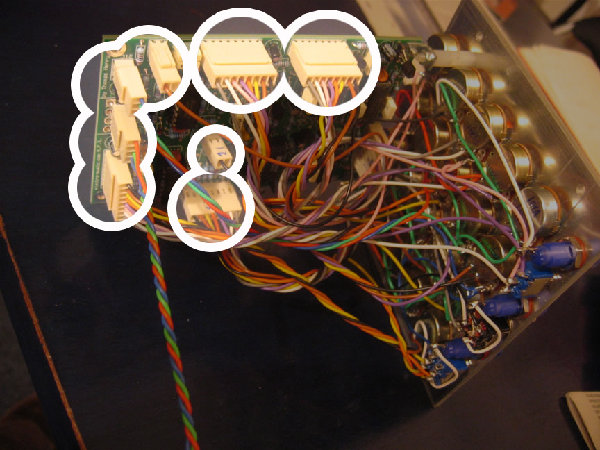

PostPosted: Wed May 06, 2009 9:33 am    Post subject: MPS SUPER NOOB QUESTION Reply with quote  Mark this post and the followings unread
Could someone tell me what these wiring harness-type connectors are? and where I might buy some. They don't appear on my parts list for the MPS, but looking at the pcb, it seems that this is what I should use. The cleaner, the better.
Thanks,
Andy
 Filesize:  246.96 KB
 Viewed:  216 Time(s)
creatorlars
Joined: Nov 26, 2007
Posts: 524
Location: Denton, TX
PostPosted: Wed May 06, 2009 11:15 am    Post subject: Reply with quote  Mark this post and the followings unread
I'd like to know also, as well as what tool is used to attach the wires.
hendrixworkshop
Joined: May 06, 2009
Posts: 57
Location: Austin, TX
PostPosted: Wed May 06, 2009 12:04 pm    Post subject: wiring method Reply with quote  Mark this post and the followings unread
I bet you just push a stripped wire into the slot. Maybe they come wire attached already. I would like that.
Luka
Joined: Jun 29, 2007
Posts: 1003
Location: Melb.
PostPosted: Wed May 06, 2009 3:25 pm    Post subject: Reply with quote  Mark this post and the followings unread
headers
http://www.futurlec.com.au/ConnPolHead.jsp
problemchild
melbourne australia
hendrixworkshop
Posts: 57
PostPosted: Thu May 07, 2009 6:52 am    Post subject: Problem solved! Reply with quote  Mark this post and the followings unread
Thanks Luka! Problem solved.
