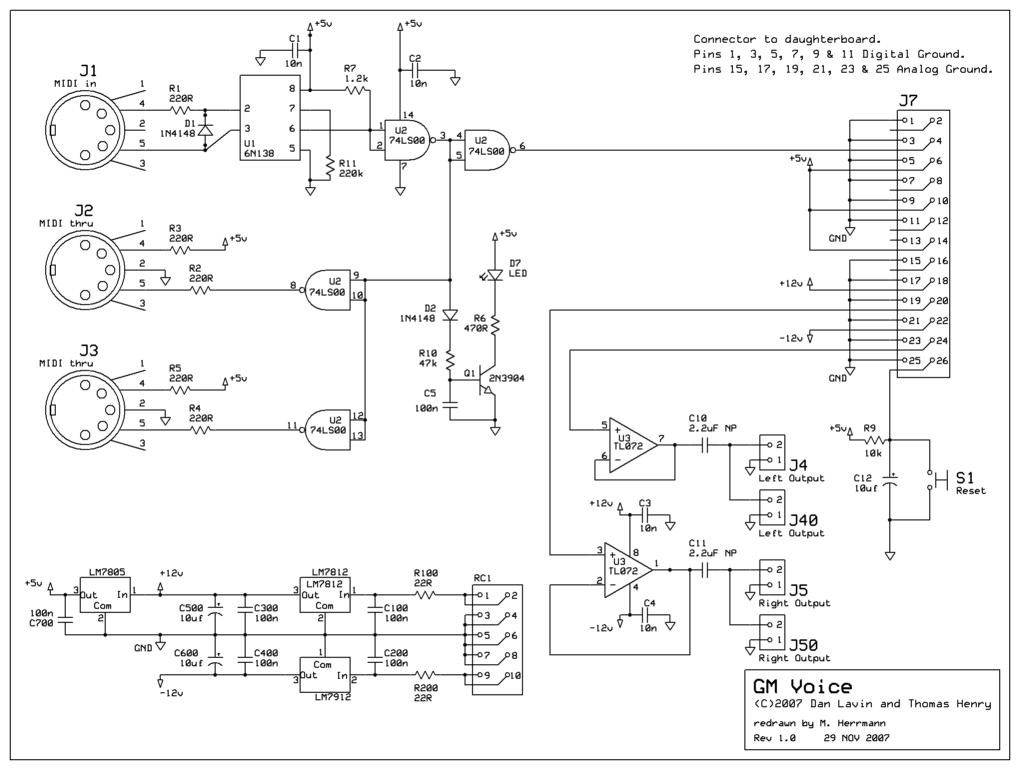

PostPosted: Sat Jul 05, 2008 8:05 am    Post subject: Reply with quote  Mark this post and the followings unread
i tried the new LM7805 regulators on the breadboarded circuit. same effect: the regulator immediately gets hot as does the protecting 22R resistor i use on the positive 12V power rail. the voltage on the +12V rail drops to about 8V.
as soon as i use a stand alone PSU for the 5V everythings going well. i am still puzzled.
where does the heat come from? why does the protecting 22R resistor get hot? could the +/-12V PSU be the cause? i believe not. i tried two different: the power one from my modular and my small switching PSU from my working bench (never have had any problems with both). what would happen if they could not provide enough current?
Question Question Question
absolutely clueless.
should i replace the ICs one by one?
Posts: 24662
Audio files: 329
PostPosted: Sat Jul 05, 2008 8:36 am    Post subject: Reply with quote  Mark this post and the followings unread
Matthias this is nuts ... Shocked
could you draw it as a schematic?
PostPosted: Sat Jul 05, 2008 9:41 am    Post subject: Reply with quote  Mark this post and the followings unread
jan, thank you so much for taking care. i will surely provide you with a schematic tomorrow.

PostPosted: Thu Jul 10, 2008 8:19 am    Post subject: Reply with quote  Mark this post and the followings unread
hello jan,
still no oscilloscope working, but here are the two schematics.
1st the schematic as i breadboarded the GMvoice.
2nd the schematic according to the board i etched.
since it is actually working it has something to do with the PSU, i think. again, the 22R protecting resistor R100 and the regulator are getting really hot. i have to shut the circuit down in order to prevent them from smoking...
any ideas?
i hopefully i will build a wallwart based PSU (ray wilsons design) soon and try that one.
Posts: 24662
Audio files: 329
PostPosted: Thu Jul 10, 2008 2:00 pm    Post subject: Reply with quote  Mark this post and the followings unread
From one of your earlier posts :
as soon as i replace the laboratory PSU by a LM7805 regulator, the voltage on the positive rail (12 or 15V) drops by approx. 20% and the LM7805 gets hot.
the power consumption is about 120mA on the 5V rail and about 270mA on the 12V rail, which seems reasonable to me.
When that's still correct and when looking at the bottom schematic there is 390 mA running through the 22R, when I interpret the measurements correctly that is ... anyway .. if so that means you're loosing 8.6 V over R100, and it has to dissipate about 4 Watt - that means HOT HOT HOT ... also it means that the 12V will drop probably, you said you started at 15V so that would leave about 5V before the 12V regulator.
Otoh, when I interpret things wrong, it would still mean 270 mA over 22 R -> 5V over R100 -> leaving 10 V before the 12V regulator and a dissipation in R100 of about 1.25W it would get HOT.
So I'd say .. just remove the 22R resistors Laughing
PostPosted: Fri Jul 11, 2008 4:01 am    Post subject: Reply with quote  Mark this post and the followings unread
removed the 22R and got rid of the voltage drop! great. again you saved my day, jan.
simply maths. unfortunately this is exactly what i am missing Shocked
however i am now in need for a appropriate heatsink.
P = V * A, am i right?
how do i calculate the Watt dissipating at LM7805 when sucking 150mA from 15V? Watt = (15V-5V) * 0.150A = 1.5W ?
this question may be silly, but i don't know much about these things. the maths of electronics is still a kind of holy grail for me...
Posts: 24662
Audio files: 329
PostPosted: Fri Jul 11, 2008 4:24 am    Post subject: Reply with quote  Mark this post and the followings unread
Good, glad it works now Cool
And your calculations are correct.
