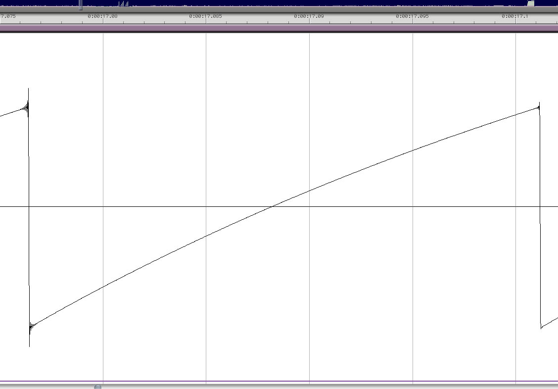

An interesting characteristic which deserves research are the two bumps in the noise floor in the bass region. If they produce amplitude bumps at those frequencies, it would be like having a pair of tight EQ bands built-in. Search flickr.com for my 904a test printout, and let me know if the response indicated would be audible.

b) the main reason a 901 has a different sound is the sawtooth is really a sort of distorted triangle, which then makes both the Sine and Triangle 'not perfect'. Pulse is pulse Smile Does this add something? Sure, but not to the extent people think. I will bet that the *output amplitude* of a 901 is different than a 921, and THAT makes the sound out of the 904As different
looks like a saw to me, but i might just be a fat pig in a wheelchair.
the ringing at the top is caused by the A/D conversion and is unavoidable.
sawtooth from a rev 2 Moog 901B.
 Filesize:  87.33 KB
 Viewed:  240 Time(s)
Laughing Those bumps look like line frequency hum to me. (60 Hz and 3 X 60 Hz). Rolling Eyes

frijitz wrote:
I know that they are line-related frequencies, but are they actual weaknesses in the design allowing it through to such a degree, or are they bumps in the frequency response? Wish we'd done a spectral scan...and check the type of power supply we used in the test. I do not believe that it has any hum Smile
Plus, if the 904a is so very frail, why would anyone want it, much less offer it for sale?
