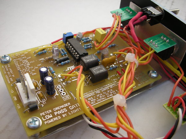

PostPosted: Fri Oct 03, 2008 1:24 am    Post subject: Reply with quote  Mark this post and the followings unread
Here's a photo of the first (old) prototype "slopass version with vtl5c4" in a nice FPE panel (also attached). Express PCB sells 3 of these for 64 US shipped to your door in 3 days. I have a triple Preamp with headphone amplifier I am working on at the moment.
Enjoy the photo!

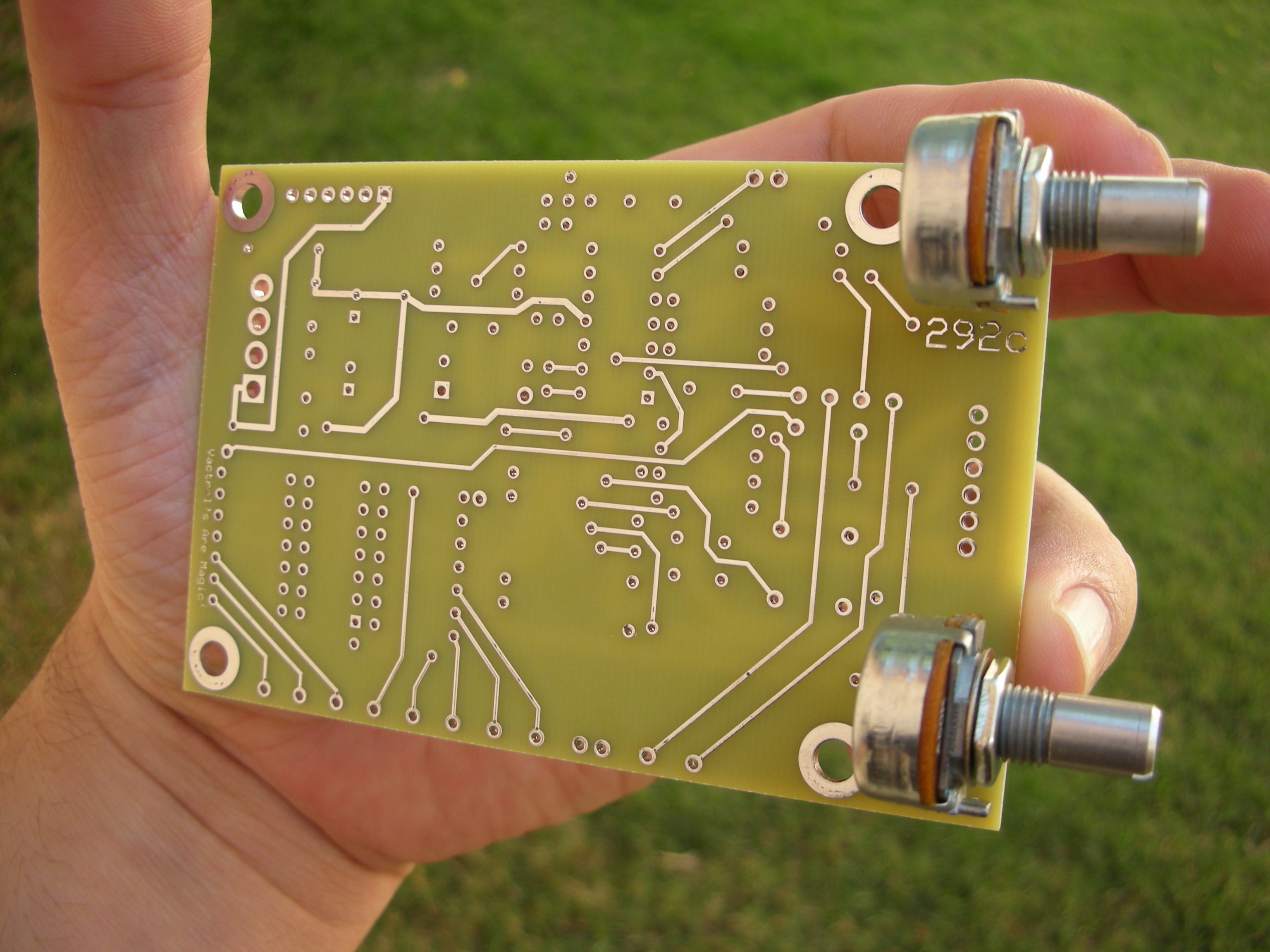

Hey guys,
I just received the non-solder masked prototypes and took a couple of quick snapshots. You will see there are two carbon pots mounted on these.
Here are any issues I notice immediately:
I have found one connection that needs to be modified by the pots. Nothing spacing the pots off the PCB won't fix, but I'd rather eliminate any potential for trouble by the final design (as you would expect me to do my best job here). With the smaller Alpha pots, the metal surrounding the pot pins can short out the connection between the pots. The Alpha pots also need to be about 1/8th of an inch closer to the edge of the board to avoid having to bend the PCB when mounting to the panel via the pots.
Nothing else yet. I realize and you will see that the pads for soldering are smaller, but this whole PCB is fairly compact and larger spacing will not work. I needed to make sure the connections don't short out. In my proto's without the solder mask it is more of an issue that it will be when the production versions are created. I can say that Express PCB does not sacrifice quality to be "Express". The PCB's look great and will look even better with any kinks worked out and sitting proudly behind your future panels. I have attached two photos, but two more can be found at my Flickr page.
