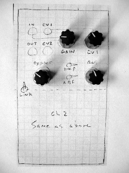

Sketch of dual layout for Frac Rack.
The Offset and Resonance pots are spaced in agreement with the PCB. I'll pursue this further once I have an actual board here. I think the way the PCB's laid out, the board would be above those two pots and my deep switch needs to creep upwards a bit to clear it. Should be possible.
If DC coupling the input works well I'll use a pull switch pot to add that feature. Not sure how carried away to get with the Link switch. Might be a DPDT switching Ch1 out to one of Ch2's Audio summing inputs and Ch1 CV sum stage out to one of Ch2's CV summing inputs.
Don't mock my mockup! ;-)
The part of my 3PDT switch which sits behind the panel is huge. It possibly won't fit that close next to another switch as your sketch suggests.
Couldn't simply the jack's switching contact replace the switch which is going to link the two LPGs?

The part of my 3PDT switch which sits behind the panel is huge...
It's not hard to find ones about 1/2" square and some are smaller. Should fit between the two board mounted pots right over where it's wires will go into the PCB. Won't know for sure until I have the board of course.
I'm using banana plugs. Also, if I do what I described it needs a DPDT.

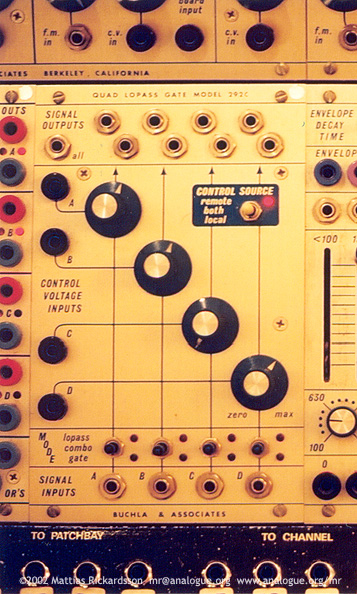

Speaking of homage and original - alas, how I miss Buchla's original 'diagonal style' panel design in the suggested dual panel above. I've seen nice diagonal designs for dual LPGs as well.
Not that it matters functionally, but it surely gives the original 292 a distinctive visual character, and when it comes to modulars I listen with my eyes as well. Laughing
In case you're wondering what mr was talking about...
/mr
Joined: Aug 05, 2007
Posts: 223
PostPosted: Thu Oct 09, 2008 3:06 pm    Post subject: Reply with quote  Mark this post and the followings unread
...or the later 292C, with remote capabilities for the Buchla 300 system:
