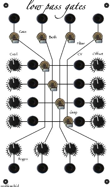

PostPosted: Wed Oct 15, 2008 9:09 pm    Post subject: Reply with quote  Mark this post and the followings unread
well my layouts are a bit different from the norm so it probably isnt much use to most poeple. it took me some time to get it to this stage with the options i wanted to include.
ive come up with a sort of euro layout for MOTM sized panels
this is a 3U wide, 5U high panel (where U is 1.75inch)
uses low profile panel components (davis clone knobs and banana jacks)
i havent tested it on cardboard yet but will
i think there should be just enough room to get your fingers around the knobs
still need to work on my labels and line work a bit, they are all just snapped to grid instead of lining up with objects
but yeah, this is fitting in with my form, it you want to get some context of how it fits in check my blog link below as ive made a quite a few posts of late showing the designs for my case
problemchild modular LPG draft 3

neandrewthal
Joined: May 11, 2007
Posts: 672
PostPosted: Thu Oct 16, 2008 9:03 am    Post subject: Reply with quote  Mark this post and the followings unread
That's why I like to see them Very Happy My layout keep getting further and further from MOTM standard, so it's always inspirational to see someone else phucking with the phormat. I like how you kept the diagonal thing going without wasting too much space.
