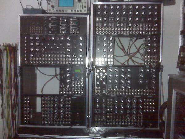

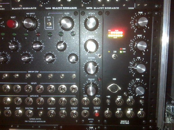

Hi all,
Here is what I built this year Smile Most panels from Bridechamber, thanks Scott!! except a few I had custom made from FPE. Sorry for the crappy quality, I only have my cell phone as a camera.
1 x Oakley multimix stooge version from bridechamber
2 x MOTM 190 uVCA
1 x MFOS ADSR
4 x Multiples
1 x CGS/bridchamber analog computer
1 x CGS utility LFO
1 x mankato filter with suit and tie guy panel
1 x MOTM 440 with marc barielle mod
1 x CGS event sequencer
1 x CGS cynare with mod for impact and control of all six osc
2 x quantix 8
1x Tellun neural agonizer
1 x MOTM 120BD mod
1 x Oakley OMS 410
I bought a prebuilt system with the basics off ebay about 2yrs ago which got damaged (dropped) in shipping (all the pots had sheared off from the PCBs) and sat in a repair shop for almost a year!!! I finally got it back early last summer and instantly wanted more Smile My first kit was the Oakley multimix which to my surprise was fairly easy to build and worked without any hassels, after that I jumped in head first and haven't looked back!! I have just as many stuffed PCBs waiting for panels from Bridechamber or FPE, can't wait to get those done, especially the Klee sequencer (come on Scott!!).

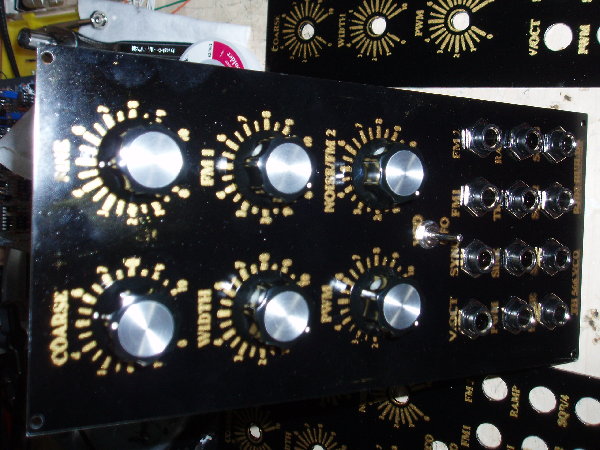

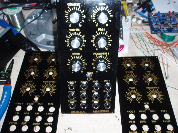

ok, so i know im a few days late, but here's my first attempt at DIY panel design and printing:

hey, those look just fine! Did you use photographic inkjet paper and clear coat? How did you get those dials?

thanks edison. they look better in the pics than in person, i smudged the gold ink in alot of places.
i drilled with a press, then flat black auto paint, made a stencil with EZSCREEN PRINT, and used some gold gocco ink a friend gave me, then clear coat. i think i'll finish the row in black/gold, and then try a few other methods.
