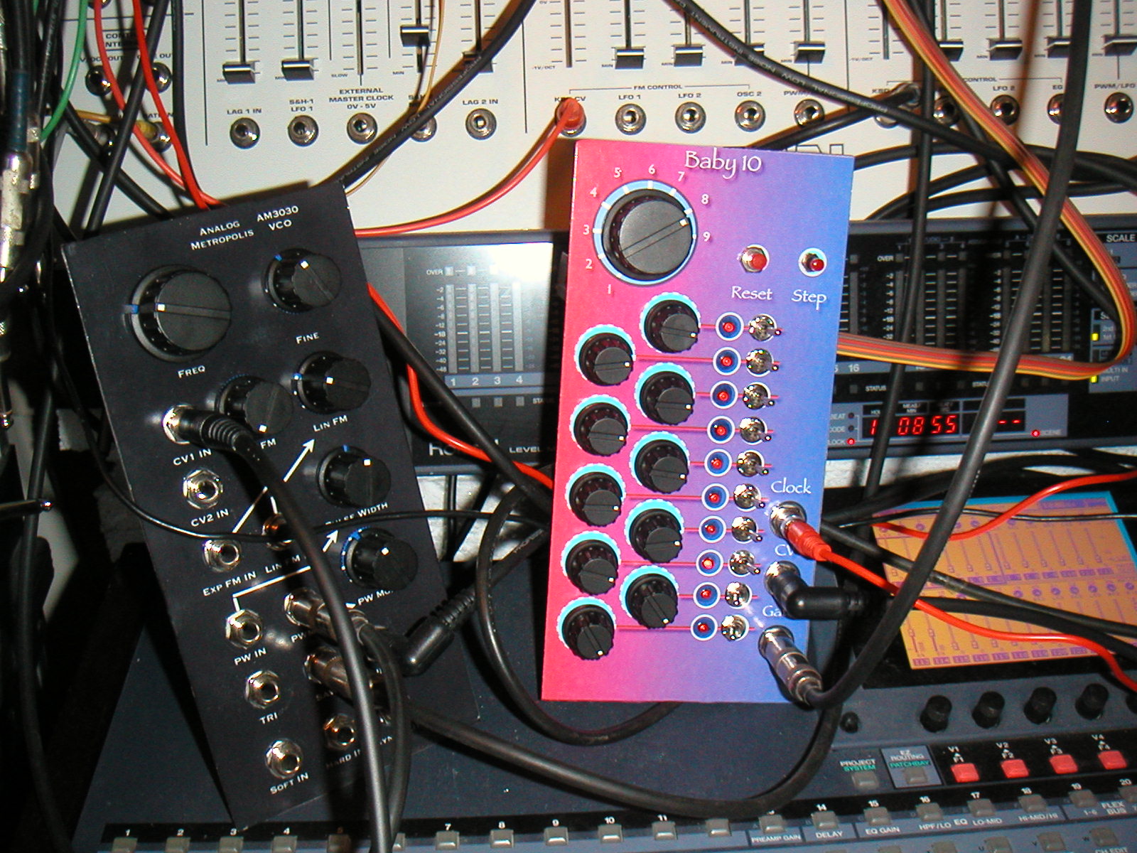

Right, 2008 isn't over, I have 20 in the backlog, so what did I do yesterday and today? Right, I built a Baby 10... What can I say, the klee needed something to go with it. Now I need to use the other 4017 for a clock divider... Very Happy

that's exactly what i do (no, not exactly, i use ken stones VC divider)! it's real fun to control the klee with a baby10 and a clock divider. good choice, IMHO.

Your Baby 10 is a bit more grown up than mine! I used your version of the schematic though, but without the extra set of CV and the Ken Stone PCB. I just did up a stripboard, and it wasn't too much work to debug. The panel is the most work on a Baby 10 anyway.
And yes, your videos are exactly how I wanted to do this, so I'm following you on that..! It was your video for the Klee that made me want to build a baby10 and a clock divider... Maybe I'll have the clock divider before NYE... I'll use Yve's schematic but only one chip's worth.
Thanks for the inspiration! But my panel graphics are different. Wink

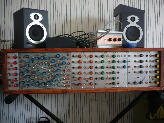

My 5HE builds this Year:
Haible Scanner and two motm VCOs
( with minijacks )
Haible Scanner and Motm VCOs

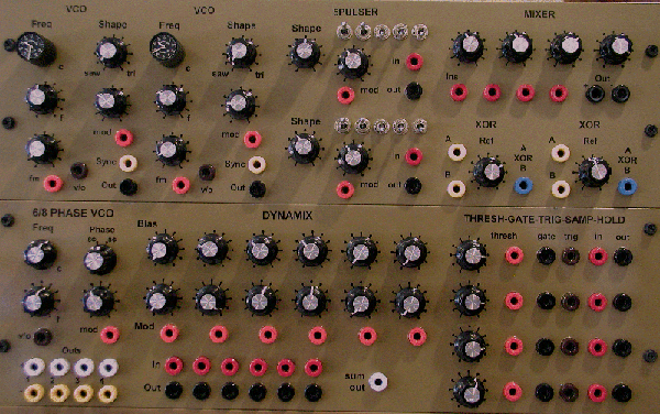

Most of my efforts in '08 went into new circuit development. I have a box full of completed circuits ready for panels. Here are two panels I did manage to get completed. These are 5.25 x 19 inch rack panels with water-slide decals for labeling.
Top Panel:
2 ea SawTri VCOs. These have Saw cores with dial-a-tempco compensation and built-in SNIC-based Saw-Tri morphers
http://home.comcast.net/~ijfritz/sy_cir9.htm
http://home.comcast.net/~ijfritz/sy_cir10.htm
2 ea 5Pulser waveshapers. Highly synergistic with the TriSaw VCOs
http://home.comcast.net/~ijfritz/sy_cir8.htm
http://bridechamber.com/bridechamber.com/F%205Pulser.html
1 ea 4-in mixer
2 ea Analog XOR circuits
http://electro-music.com/forum/viewtopic.php?highlight=analog+xor&t=21851
Bottom Panel:
1 ea 6/8 Phase Sin VCO.
http://electro-music.com/forum/viewtopic.php?highlight=quadrature+oscillator&t=19841
1 ea Dynamix. A bank of 6 FET-based VCAs for wave mixing and scanning.
4 ea TGTSH (Threshold, Gate, Trigger, Sample/Hold) units.
http://home.comcast.net/~ijfritz/ch_cir3.htm
http://bridechamber.com/bridechamber.com/F%20TGTSH.html
Happy New Year to all!

Ian - Your stuff is just amazing, also. What the heck are those frequency knobs - are they just for show or are they functional?
frijitz
Joined: May 04, 2007
Posts: 1734
Location: NM USA
Audio files: 54
PostPosted: Fri Jan 02, 2009 10:56 pm    Post subject: Reply with quote  Mark this post and the followings unread
They're Knobpots. I was able to get a bunch out of a salvage yard many years ago.
http://www.bourns.com/bu/bu11_13knobpot.html
Ian

neandrewthal, nice panel work! It's coming ever closer to the Serge aesthetic.
neandrewthal
Joined: May 11, 2007
Posts: 672
PostPosted: Sat Jan 03, 2009 2:44 pm    Post subject: Reply with quote  Mark this post and the followings unread
Thanks, It is getting closer to the serge. From now on, I'm going in 2 separate directions. The "boring" utilitarian modules will be on a serge-style grid for maximum space effectiveness, while the "sexy" modules will be more moog/buchla inspired, each having it's own unique layout and bigger knobs for tweaking. Coincidentally, the latter are proving harder to design layouts for, hence the blank spaces Laughing
Note: the modules in the bottom corners are just inverted screenshots from Thomas White's excellent FPD designs for the Klee and MFOS sequencer. I'll be getting these panels from bridechamber when they are ready.
