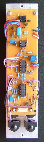

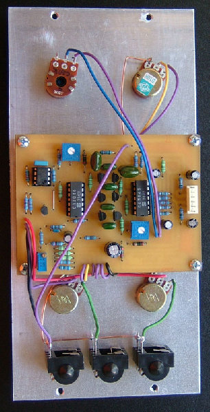

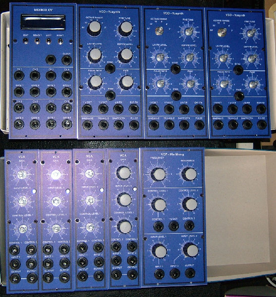

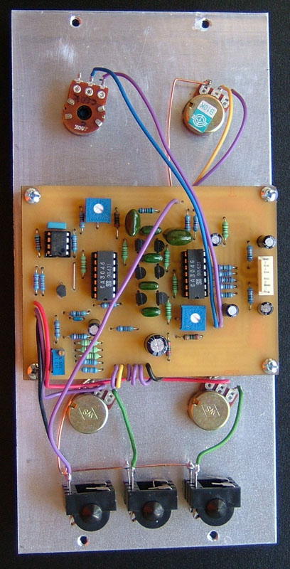

Hi:
I recently finished some modules. There are some knobs missing, but all
are working (except the MIDIbox CV, I have to finish the wiring).
The list:
3 x Yusynth VCO
4 x Yusynth VCA
1 x Yusynth MiniMoog VCF

LetterBeacon
Joined: Mar 18, 2008 Posts: 454 Location: London, UK
Posted: Sun Feb 01, 2009 6:21 pm Post subject:
Good work!
I'm building the Minimoog filter at the moment - did you have any problems when you fired it up at all, or was it a fairly straight forward build? |
Sebo
Joined: Apr 27, 2007 Posts: 564 Location: Argentina
Posted: Sun Feb 01, 2009 7:16 pm Post subject:
The MiniMoog VCF works at first power up (as all the other modules).
I built another MiniMoog VCF for a friend before this one, at that time
I put the TL072 pointing at the wrong direction, and the filter didn't work
until I realized that.
Also my friend forgot the filter powered on (is a stand alone unit) for more
than a day, when he checked, the cutoff frequency knob did't work
anymore. After some troubleshooting I found that one transistor at one of
the CA3046 was dead. _________________ Sebo
My Music:
https://www.facebook.com/cosaquitos/ |

numbertalk
Joined: May 05, 2008 Posts: 992 Location: Austin, TX
Posted: Mon Feb 02, 2009 7:55 am Post subject:
| LetterBeacon wrote: | Good work!
Not sure how you plan to power it but if you're using less than +/-15VDC the filter won't self oscillate & you won't get deep resonance out of it. When I built mine I hadn't installed a power supply yet and was trying to run off of 2 9V batteries and encountered this issue. |

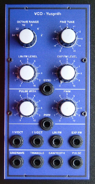

Sebo
Posted: Tue Feb 10, 2009 5:13 pm Post subject:
I just finished the MIDIbox CV, and then calibrated the 3 VCOs.
They are working great, I get 6 octaves of good tunning in 2 of them and
a little more than 7 in the other.
I'm only having one issue, I can't tune one of the VCOs low enough. The
initial trimmer is all way down but I can reach the low C (C0) for about a semitone.
The other 2 are fine, I tunned the problematic one an octave upper for the
moment but I want to tune it just like the others, I will add a resistor in
serie with the trimmer, I think that will be enough.
The octave selectors worked better than I expected.
Next I will work in the ADSRs and in the Quantix-8.
| yusynth wrote: | Hi Sebo
Your photos are now included in the galleries at my site
Cheers |
I see them, thank you!!!
And Thank You for sharing all those designs, PCB, info, and being so helpfull!!!! _________________ Sebo
My Music:
yusynth
Joined: Nov 24, 2005 Posts: 1314 Location: France
Posted: Wed Feb 11, 2009 12:45 am Post subject:
| Sebo wrote: |
serie with the trimmer, I think that will be enough. |
Well this looks like some resistor has not the right value just do a thorough check then. Check also that the tempco resistor is corectly soldered. Then if you don't find a faulty resistor, you may reduce the value of R8 (make it 390K instead of 470K) _________________ Yves |
Sebo
Posted: Wed Feb 11, 2009 4:46 pm Post subject:
In the other two VCOs, I had to turn the trim to the limit to get the tunning right,
and in this one I just can't reach it.
I think there are 2 reason for this, one is the fact that I used 200K trimpots
(I can't find 220K), and the other is that the octave selector lower position
is -5V, if I did correctly the math, in your original design the coarse tune
pot turned all CCW will be -5.5V.
I was thinking of changing the trimpot for a 250K one (adding a resistor will be
a little difficult), but changing R8 will be cheaper and faster (I already
have a 390K resistor).
Thanks again. _________________ Sebo

Sebo
Posted: Mon Feb 16, 2009 4:25 pm Post subject:
I changed R8 for a 390K, and is tunned correctly now.
Also I finished one ADSR and is working right. I haven't had the time to wire the other 3. I will post some pictures soon.
I have a question:
In the Wavefolder can I replace the 2 matched BC547 by a 2SC1583? _________________ Sebo
My Music:

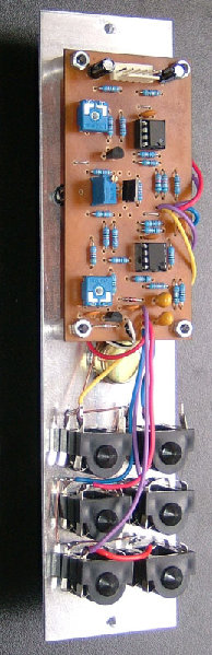

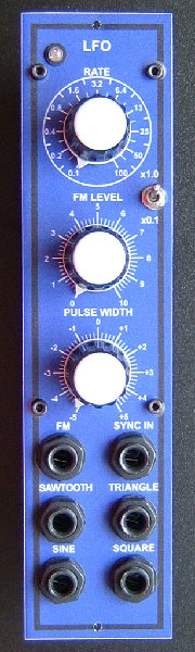

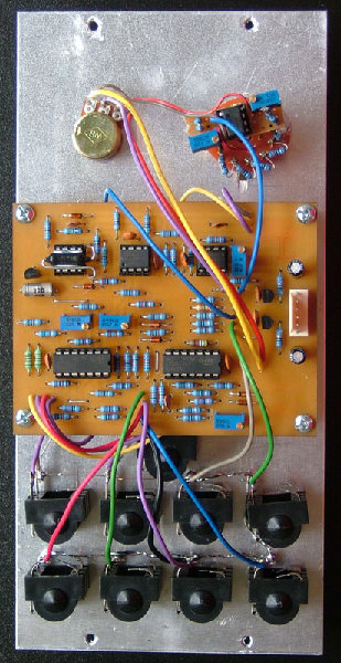

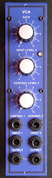

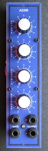

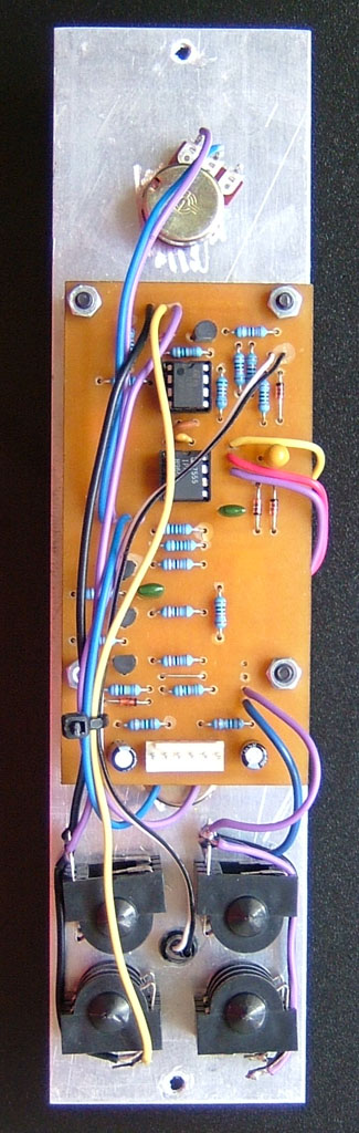

Sebo
Posted: Sat Apr 04, 2009 1:22 pm Post subject:
Some more modules finished...

yusynth
Posted: Sun Apr 05, 2009 12:42 am Post subject:
I will add these ASAP in the modules' gallery of my web site. Thanks a lot ! _________________ Yves |

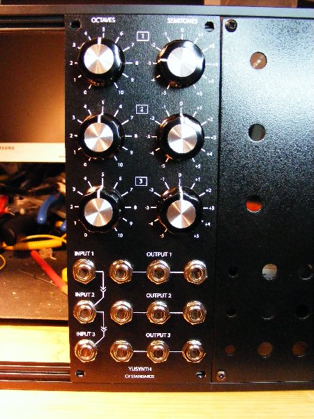

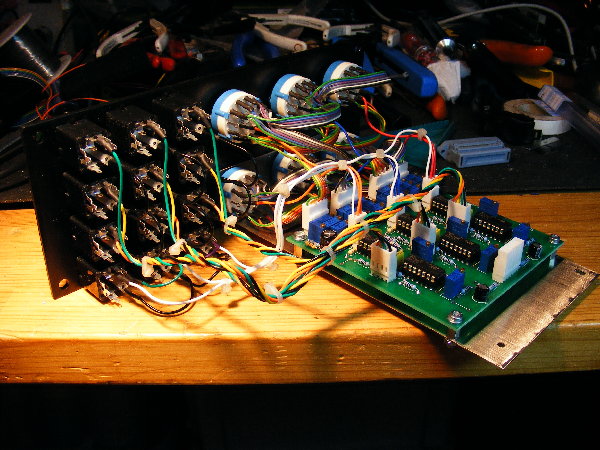

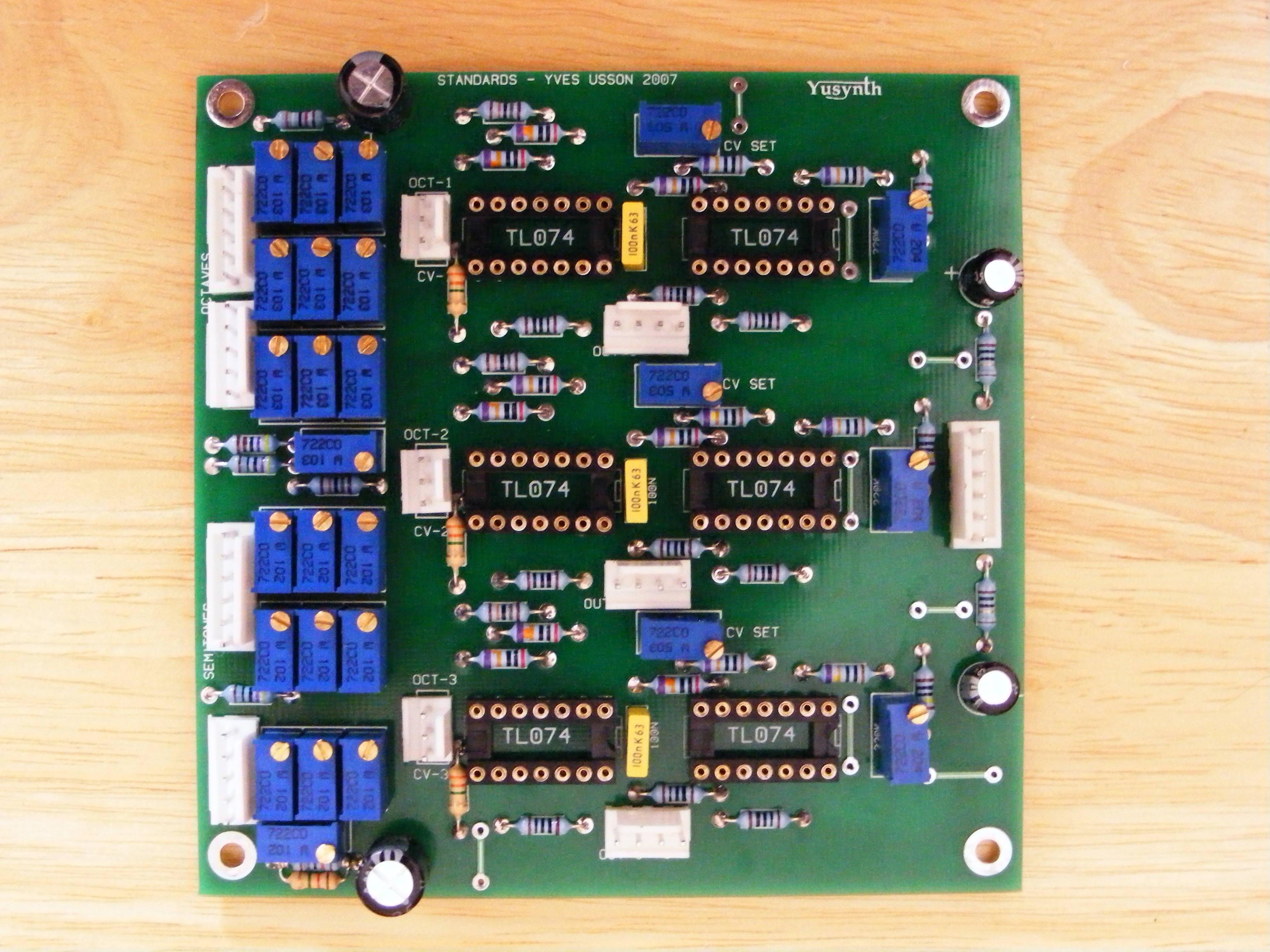

Posted: Fri May 29, 2009 5:04 pm Post subject:
Completed my first synth module - a Yusynth CV Standards.
This uses a Bridechamber front panel and PCB.
| Description: |
| Populated Bridechamber sourced PCB - just waiting for the chips. |
