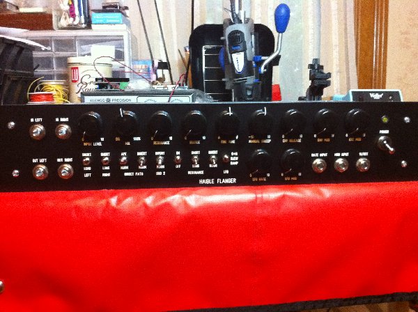

A few photos.
 Filesize:  1.73 MB
 Viewed:  555 Time(s)
 Filesize:  1.69 MB
 Viewed:  527 Time(s)
 Filesize:  1.65 MB
 Viewed:  511 Time(s)
 Filesize:  2.16 MB
 Viewed:  571 Time(s)
