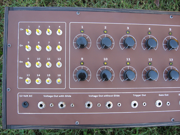

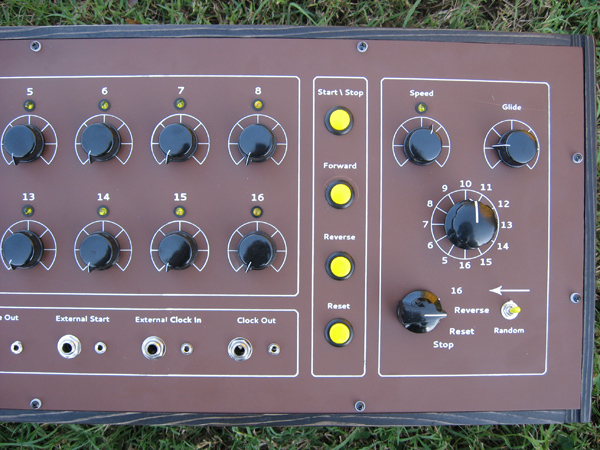

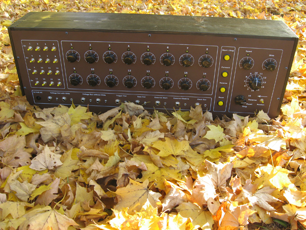

MFOS 16 step sequencer project I build for a person.

nice look,nice colors !
PostPosted: Thu Oct 21, 2010 3:42 am    Post subject: Reply with quote  Mark this post and the followings unread
is the panel realy that brownish? how did you do it? looks awesome!

PostPosted: Thu Oct 21, 2010 4:27 am    Post subject: Reply with quote  Mark this post and the followings unread
lucky person, hope you will be suitably rewarded

PostPosted: Thu Oct 21, 2010 10:16 am    Post subject: Reply with quote  Mark this post and the followings unread
Yes it is a rust brown color. It is enamel paint. I am learning silk screening and finger joining wood. I got a sheet of AL, cut it to size, 3 coats primer, 6 coats paint, then silk screened the text. The box is ebony stain. Thanks for the nice comments.

Hey Delayed!
Great job on the silk screening! The rust brown color is very cool! Can you tell us some more details on how you did the screen printing? What kind of ink did you use? Did you have the screen made and coated with emulsion for you? I am thinking of trying this as well, hope you can give some guidance!
Phil
delayed
Joined: Jun 24, 2008
Posts: 130
Location: TN
PostPosted: Fri Oct 22, 2010 3:46 pm    Post subject: Reply with quote  Mark this post and the followings unread
Nothing fancy because I am cheap. I am using normal quart/gallon enamel paint you get at any home store for the text and enamel spray paint for the primer and main color. I found that you really need plenty of coats of primer or the nuts will chip the paint easy. I leave it a day between coats for the primer and main color and 2-3 days for the text to dry.
Made my own screen with Speedball emulsion (I picked speedball because you can get 40-50% coupons from different hobby stores. It makes it the cheapest option. Nazdar it suppose to be the better brand to use for paint and emulsion) and got used screens off ebay and craiglist. You need over 200 for the text 300+ is better for the screens. I used light bulbs for the first panels I made. That works fine for sizes under 8x10. Over that you need another lamp/bulb for each 8x10 area. It takes lots of trial and error to figure out the burning of the screen. I got lucky and found a UV light table on craigstlist for this one. Which worked better than the hanging lights because this is almost 30 inches long. But as long as you are working under 8x10 a photobulb works fine.
This process takes a lot of time and effort for a single print. Silk screening is not really made for this. The set up fee on the cheap side is about 100+ dollars buying mostly used items. But on the other side I have lots of time at the moment and like learning new things. A print this size would have been 100s of dollars to get one made from the normal places that people use. This method also gives you nice results, (better with more practice) and a chance to pick out mostly any colors you want. The little things like tape, wood, hinges, cleaners, towels, squeegee add up the cost. Since you are in NJ I would think that you could find used items easy on the cheap to try it out.
Hopefully that helps a bit. There are lots of videos on the web for printing tees and posters but little about metal. The method is the same, just a change in the paint/clean up items.
