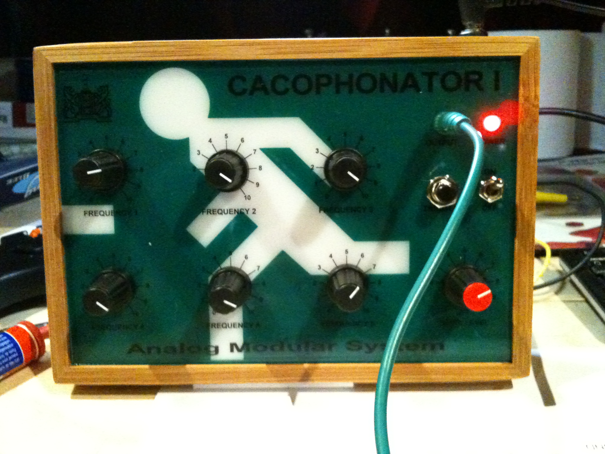

Hello !!
Here is my Cacophonator I.
Fun project to do, generate some freaky sounds.
Have to finish my box with a back light.
Grt,
Chris

PostPosted: Mon Oct 22, 2012 3:41 pm    Post subject: Reply with quote  Mark this post and the followings unread
Hey that looks pretty cool! Is that a recycled sign? It has a certain Athletico Spizz look about it. Laughing
