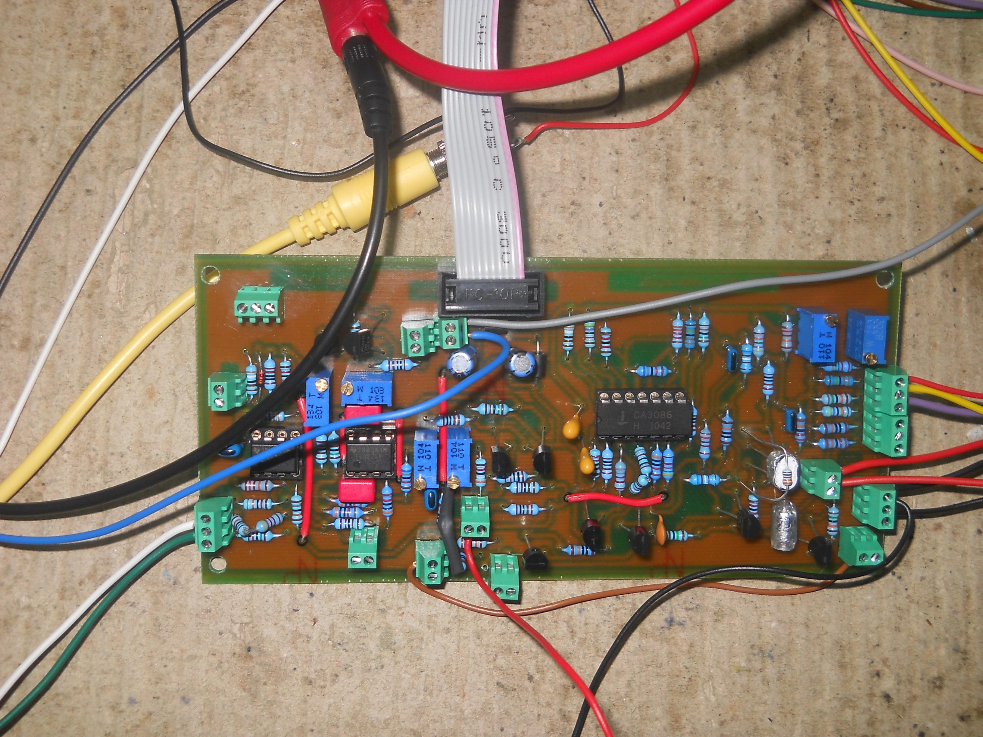

Hi Tim and guys
sorry i'm not english native so hope to write in a understandable way Smile
Tim your vco working well the first time i've powered it on , also the
calibration procedure it is comes in a fast way .
now i want build others 3 vco for think in poly like your build , but i've to waiting that the 2N5459 arrive ( bought 50 pics on ebay) and other some miss stuff .
For this first build i've use the 2n3906 instead of the 2n5910 , 4,7pf instead of the 5pf and 2k tempco 3300 ppm instead of the 1.87k 3500 ppm , yeahh work fine equally , but i want use the rigth stuff for the others three vco
for hear if it change some or not .
I've tryed also to replace the CA3086 with CA3046 seems the same
result but i've not dept the change , therefore back with the CA3086 just for respect the original circuit .
In the pcb layout i've change just some pad for add the screw terminals (love this terminals) and the IDC connection because i prefert it .
will post updates when I get the material to build other vco .
Again many thanks Tim for your work Smile

Thanks for the kind words Muied Lumens! Smile
paulstone,
Nice looking PCB, glad it's working for you. Cool
I will be posting the PCB and build info for the sub oscillator divider soon.

Hi THeff.
I finally manage to complit the vco build.
I must say...I love it!
The square sounds very very good, specially with a bit of PW.
As you said it was easy to tune.
I have one thing with the Tri, the top of the Tri is not spiky like it should be, the spike of the Tri is in the opposit way arround, and I actually can hear this, do you have Any idea why it happanes?
Again, I thank you for this amazing vco.
Isak E.

PostPosted: Wed May 14, 2014 7:13 pm    Post subject: Reply with quote  Mark this post and the followings unread
Hi paulstone,
I'm glad you got the osc divider working, it's a great little circuit.
Isak,
I'm not quite sure what you are seeing with the triangle output but, it sounds like it is folding back on itself. I have never seen this on any of the eight boards that I built so I'm not sure what would cause it.
I can only suggest that you double check the components in the triangle section and make sure there are no solder splashes shorting the PCB traces since they are pretty close together.
-THeff

PostPosted: Sun May 18, 2014 2:13 pm    Post subject: Reply with quote  Mark this post and the followings unread
hi Theff.
thank you for your reply.
i'll do my best to find the problem and let you know.
isak E.

PostPosted: Tue Jun 10, 2014 6:35 am    Post subject: Reply with quote  Mark this post and the followings unread
Hi THeff.
i didnt manage to fix the issue yet.
i thought maybe a pic of the tip tri wave shape will help?
this is what i see:
and the top it is not steady, it always moves.
any ideas? Confused
cheers.
PostPosted: Tue Jun 10, 2014 7:52 am    Post subject: Reply with quote  Mark this post and the followings unread
Is there any trim for the triangle? I've seen sort of similar things in other VCOs where the up ramp and down ramp sides of the triangle didn't meet correctly, normally there's a trim to line them up....

PostPosted: Tue Jun 10, 2014 8:35 am    Post subject: Reply with quote  Mark this post and the followings unread
Yes, there is a trim, but when I trim it to be centered the top of the Tri is going inside and it's hearible!
Have a look!

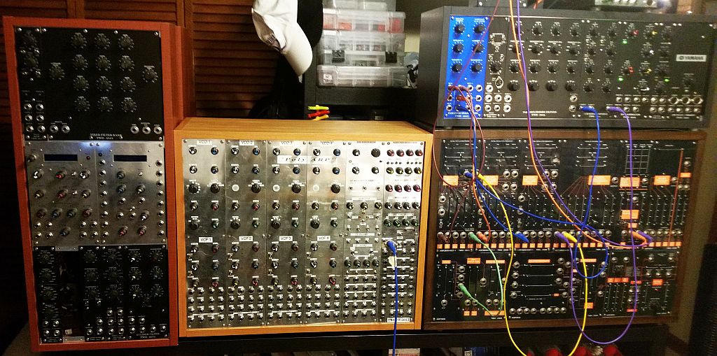

PostPosted: Sun Dec 27, 2015 6:41 pm    Post subject: New song
Subject description: I made a new recoding today.
Greetings all,
I haven't posted anything in a very long time so I thought I would drag out the PolyArp and see what I could do today. I found a MIDI file lurking on my computer with no name, just a number. It has a lot of cool arpeggios so I made a recording of it. All of the sounds are from the PolyArp, except the drums.
Since it didn't have a name, I called the song ArpAmbience. If you recognize it, please let me know.
Cheers and Happy New Year!

Thanks stringsthings,
I wasn't sure how playable it was going to be due to the pitch drift of the four analog VCOs, but I am very pleased with the results. I made an attenuation patch cord so that I could plug a guitar tuner into the Sine output of each oscillator and that makes tuning fast and easy. I hope you build a cool synth in the near future.
Regards,
-THeff
