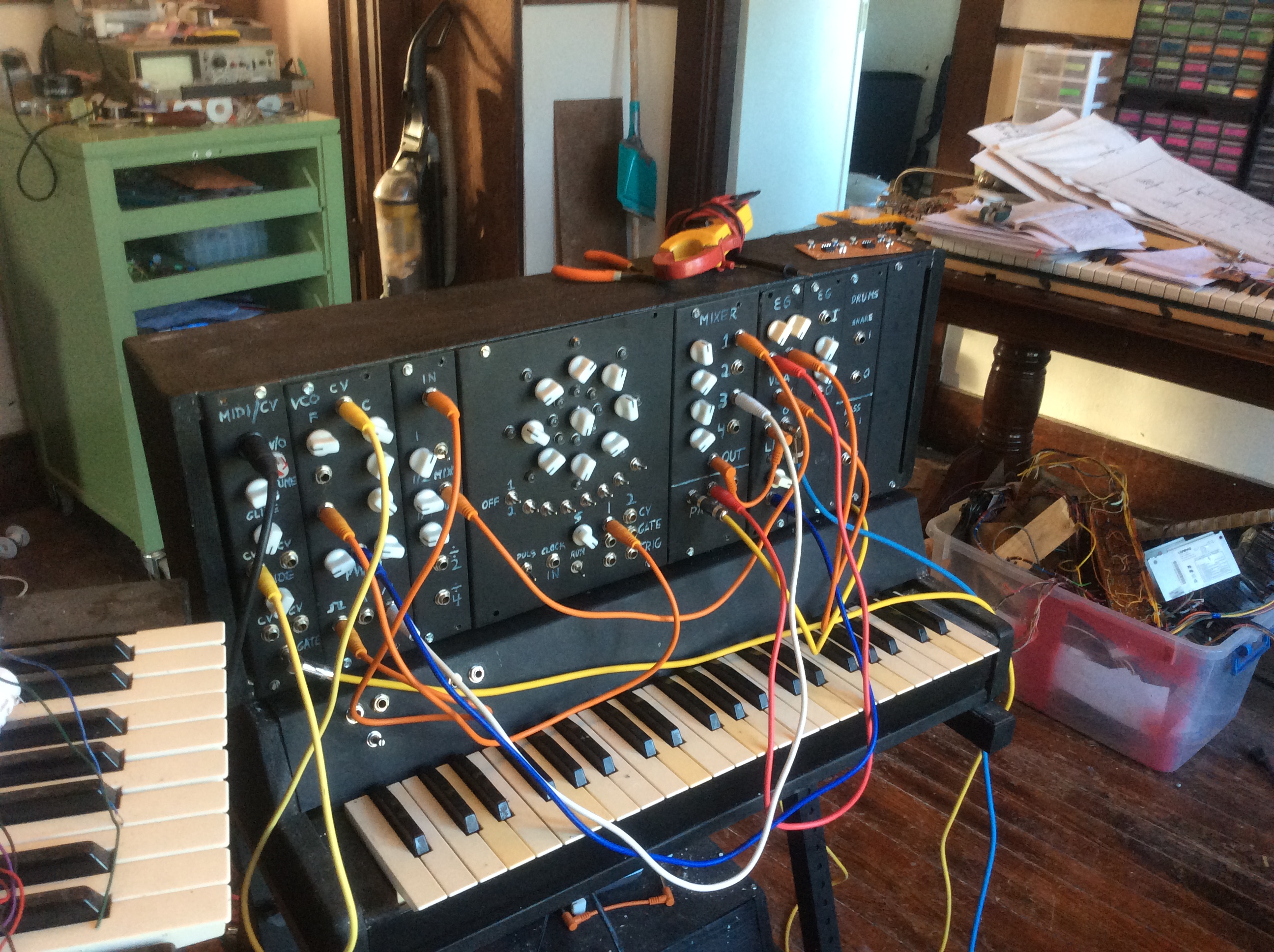

Almost to my goal for this year. One blank plate on the end, is yet to be decided. Really just need another mixer for what I do most.
Not as pretty as most on here, but it sounds way better than I ever expected when I started.

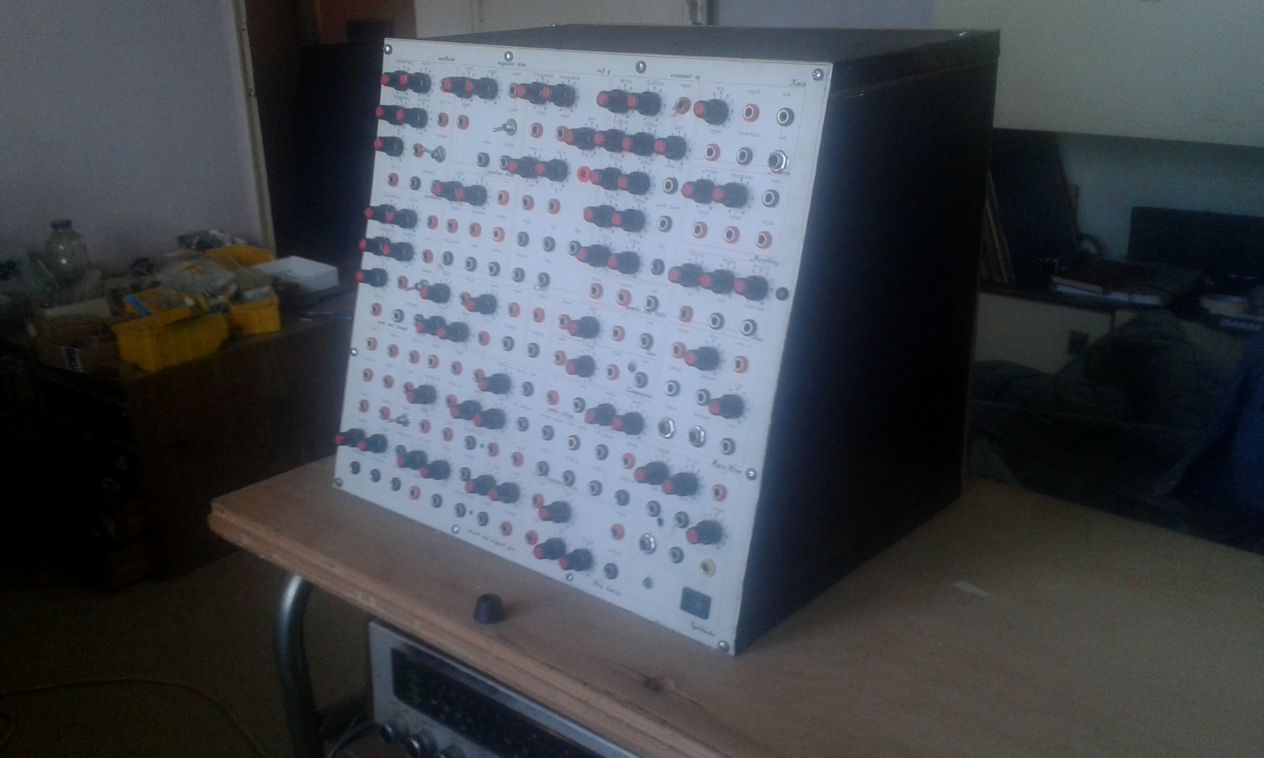

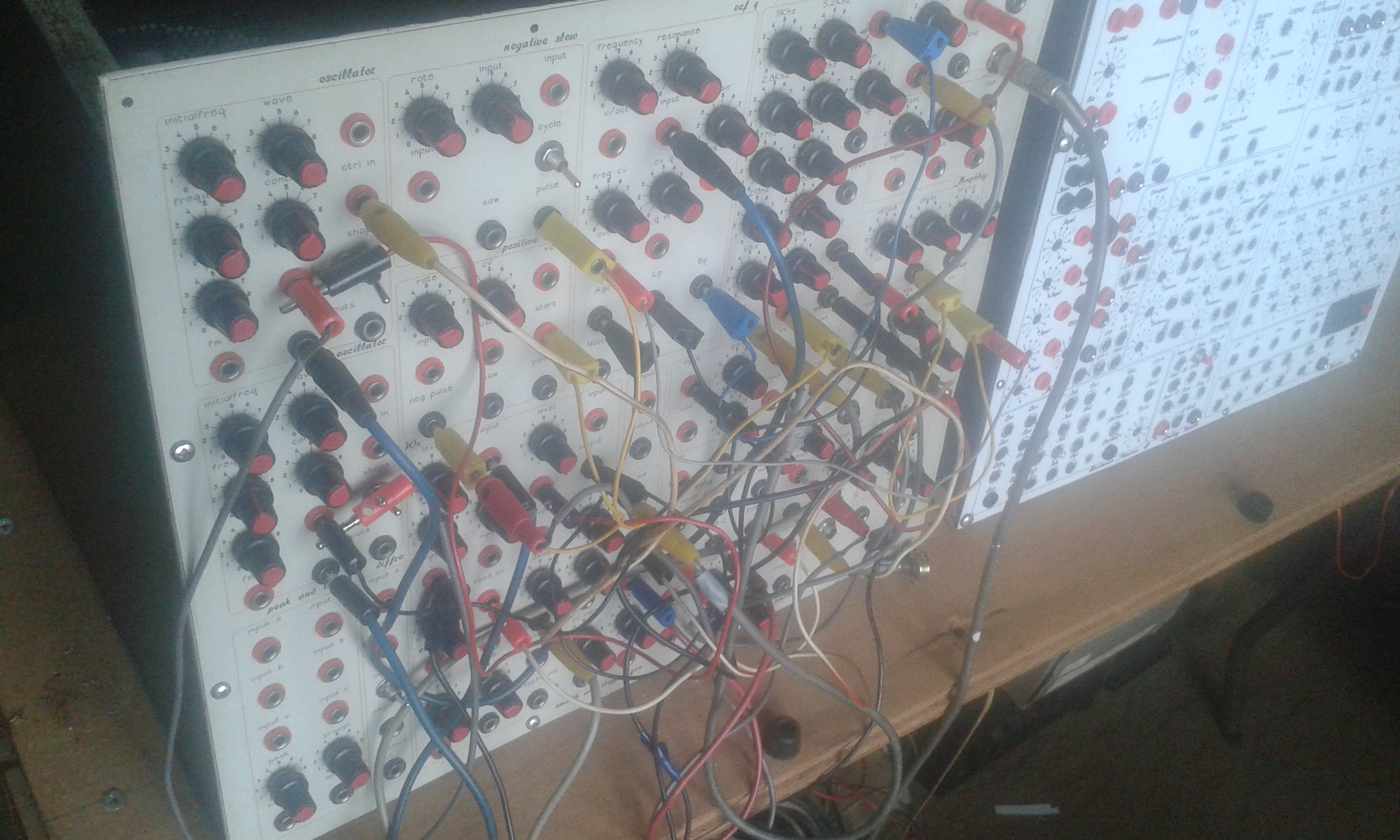

it took me a while to complete this ,so maybe is not 2016 build ,here are the modules :
Buchla 258 x 2
Serge Positive slew x 1
Serge Negative Slew x 1
Serge VCFQ x 1
PT VC Echo x 1
Paparail VC Aux x 1
NLC VCA x 1
VC Slew Befako x 1
Yusynth Pulse Delay x 1
Serge Comparator x 1
Osamu H. Sample and Hold x 1
Serge SSG x 1
Serge Middle Wavemultiplier Section x 1
NLC Neuron x 1
Electronotes Wave Animator x 1
Serge Resonant EQ x 1
Bissel Morphlag x 1
Buchla 208 Random x 1
Yusynth Noise x 1
Serge Peak and Through x 1
connected with NLC Differenc Rectifier
NLC Sloth Chaos x 1
E4M Xmix x 1
now all i need is more cables Smile))

wackelpeter
Joined: May 05, 2013
Posts: 461
Location: germany
Audio files: 10
PostPosted: Fri Oct 14, 2016 3:04 am    Post subject: Reply with quote  Mark this post and the followings unread
That looks very nice Vladosh.
Seems as we both built a lot of the same modules lately... Smile
All this is powered from one PSU??? Well i'm asking because in my latest cabinet the heat sinks for my regulators seem to get really hot and it's only about 630mA on the positive rail... maybe i have to build in bigger ones... at the moment they are about half the size of a cigarette box each..
And also... did you made the gain cells for the Serge VCQF yourself or did you used some PCB's from Ken?

PostPosted: Fri Oct 14, 2016 3:30 am    Post subject: Reply with quote  Mark this post and the followings unread
thanks ,this is also on same PSU wackelpeter ,i reuse heatsinks from computer PSU's worked fine so far .. i have a big transformer in this box so as i have seen somewhere here on forum i plan to feed a second box with the same transformer's AC ,not on picture but on the back of the box there is the 220V and a 4 pin jack to connect both ,and for the vcfq i made the gain cells myself while the filter itself is not so special really ,the '73 vcf sounds better as i recall ,and also i tried to make a cv filtering option on this filter but it introduced lot of noise
