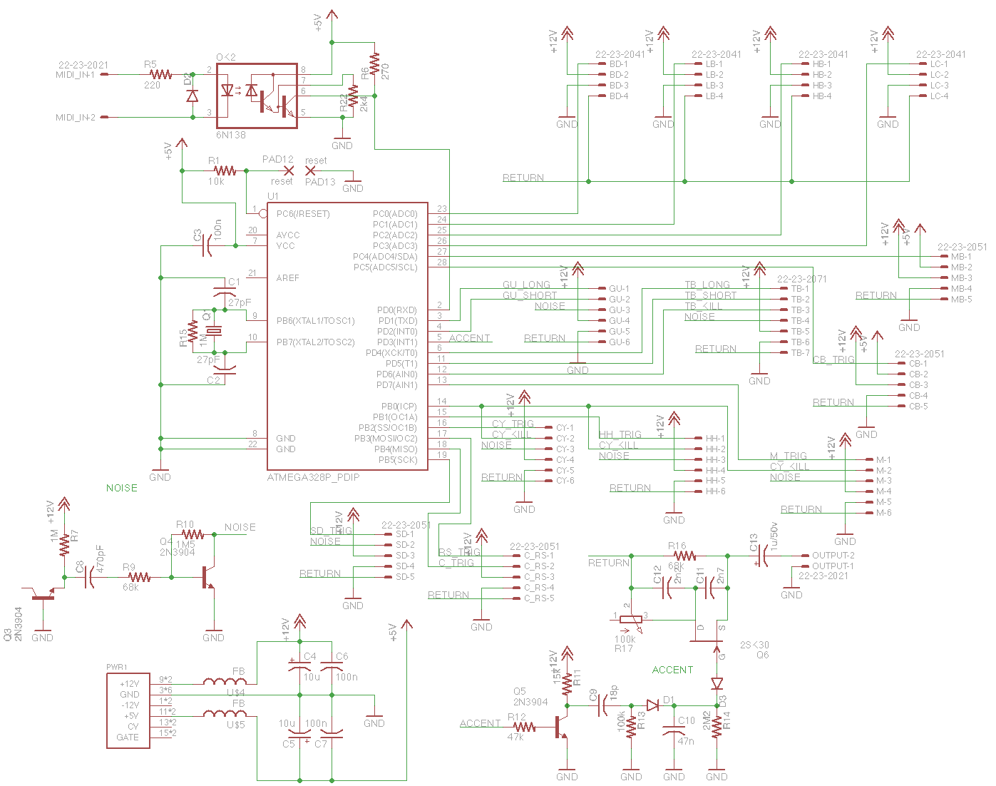

Not sure what is going on with this circuit. It's on a breadboard supplied 12V (not 15 like the original). I built the TTL to trigger circuit so the "C" input pictured is normally at 12V with 2ms pulses down to 0V. The left side of C502 sees about a -10V bump. But the right side of C502 remains silent. I am using a cheapo 3u3H film inductor but have tried numerous different types. What should I try next?
 Filesize:  151.53 KB
 Viewed:  736 Time(s)
Posts: 1320
PostPosted: Wed Jun 01, 2016 10:46 pm    Post subject: Reply with quote  Mark this post and the followings unread
Close to L1 it says 3R, is that the DC impedance? If so, the value of L1 can never be 3.3 uH because they all have DC impedance lower than 0.02 ohm.

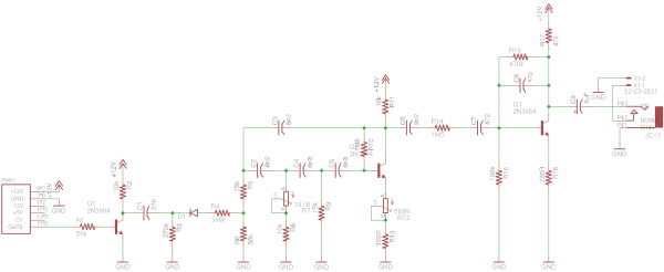

@wackelpeter Thanks very much for the info and manual! 3R must also be 700mH and maybe 1R is 40mH. Do you have any idea why they call the 45mH out as a "Choke Coil"?
My triggers should be okay because I copied the TTL->trigger circuit and my high bongo works great. You can see the trigger converter (input) and the output amp from stereoping in this schemo:
https://github.com/jbeuckm/CR78-HB.git

okay don't know about your HB clone... but perhaps a bit of twiddling with some of the values before the actual "voice" could solve the solution as i think a fair portion of the left side from the clave voice schematic is to "form" the correct trigger pulse for the voice beginning to swing...
...and as your powering yours with 12 instead of 15v that could have something to do with it no matter that it works on the high bongo...

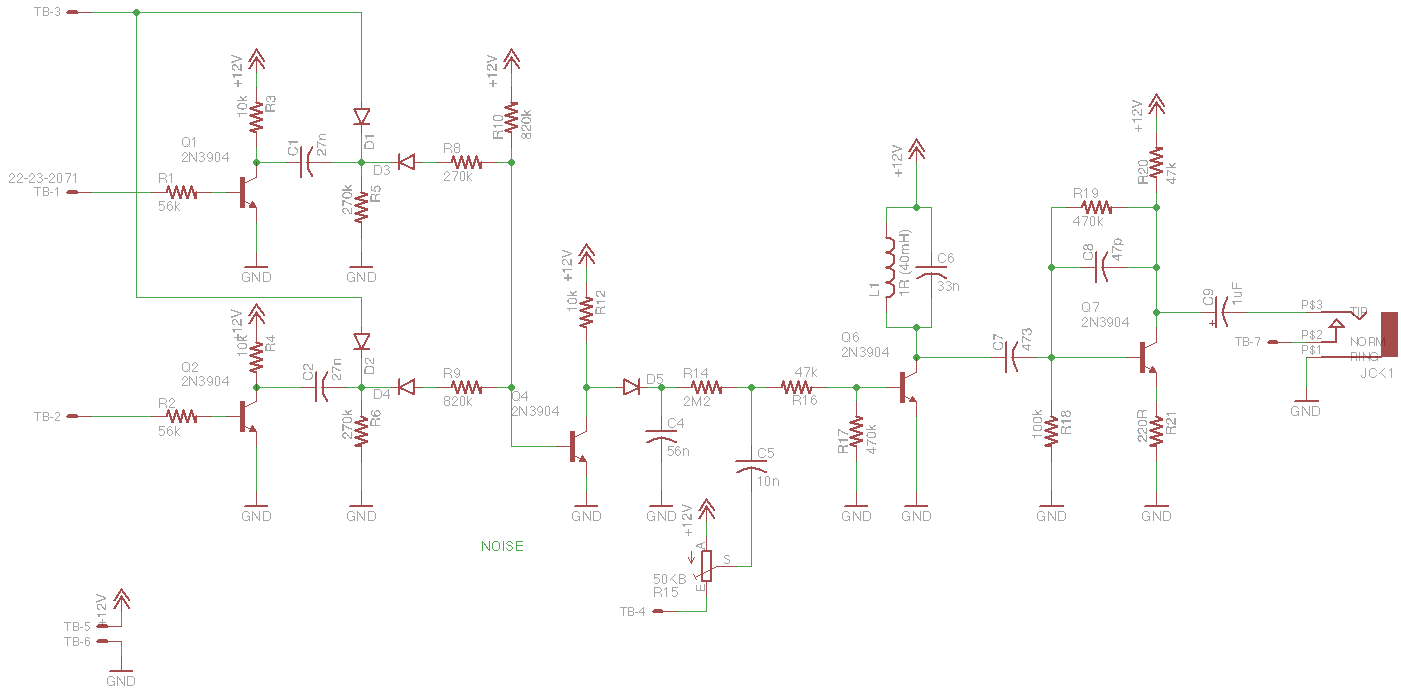

Is the LC circuit at the TB output a resonant filter? Looking at a known sample on a spectrograph, I see a peak near 4700hz. Since C538 is 33nF, that would imply that L5 is around 35mH. But I have tried a variety of inductors including 27mH and 47mH and I get no output. Maybe something is wrong with my schematic or build Sad
 Filesize:  21.04 KB
 Viewed:  572 Time(s)
Posts: 1320
PostPosted: Mon Jun 13, 2016 11:41 pm    Post subject: Reply with quote  Mark this post and the followings unread
I use this website a lot when working on analog circuits.
The LC circuit is a resonant filter (4.38 kHz @ 33nF//40mH), make sure you have quality components to get the best selectivity (quality factor) of the filter.
This means: for the capacitor the lowest possible parallel resistance and for the coil the minimum series resistor.
Check if you have a pulse between R14 and R16 (maybe change the position of the runner of R15.

The voltage across R14 is about 0.1 volt max, and is later devided by R570 and R548 to about 3/4 of the 0.1 volt.
Thats not nearly enough to change anything to the voltage at the base of Q510.
I think you should loose R14.
